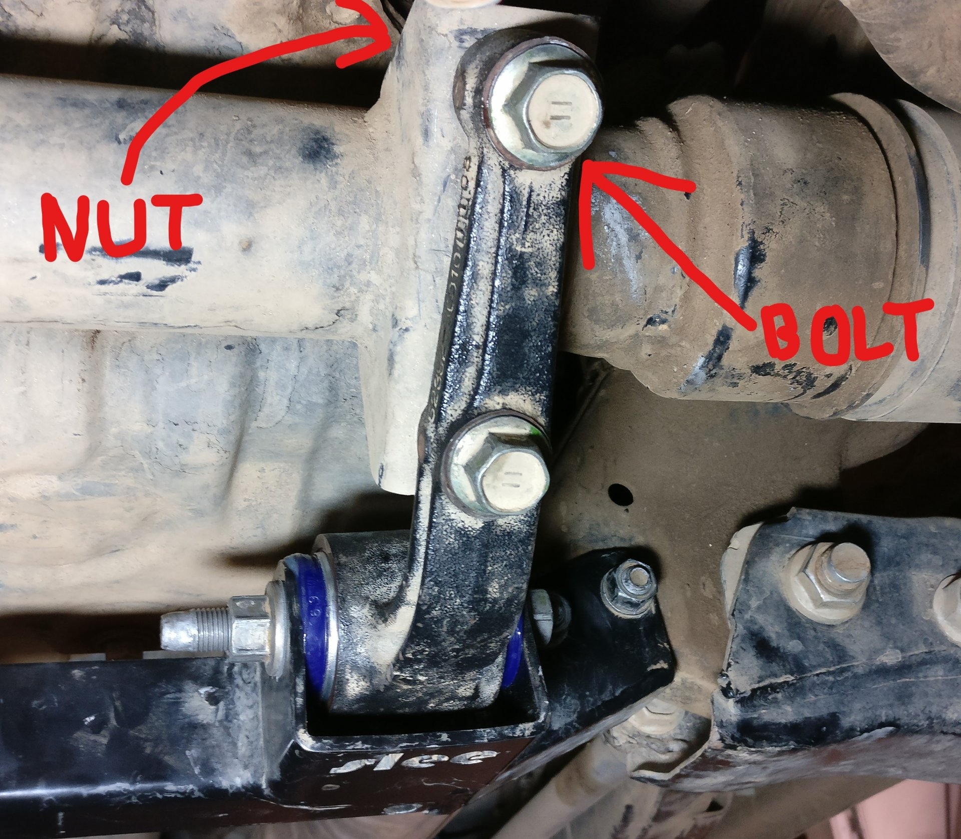

Has anybody had trouble getting clearance reinstalling the two bolts on top of the DS diff support? I had a hard time getting to the nuts on the topside of the arm to stop them from spinning, mainly the uppermost nut and bolt, during the removal process prior to installing Superpro Poly bushing. I'm about mount it back up but I'm anticipating problems given how hard it was to get at for removal and I'm hoping someone might have a tip to get it snugged up enough to be able to torque to spec and be done with it.. See attached pic for reference to topside nut I had trouble turning on me.
Also, what is the torque spec for the bolt that goes through the bushing, parallel to the ground? Thanks in advance for any help.

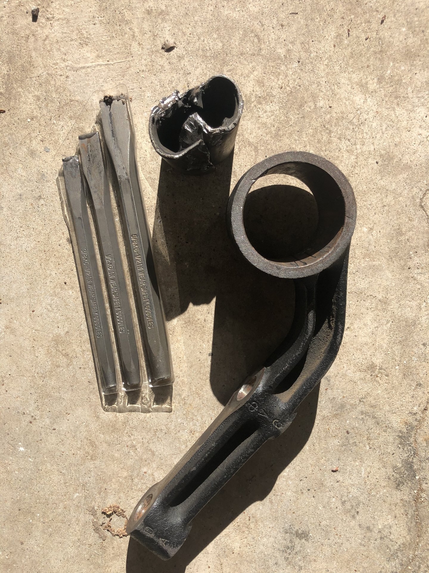

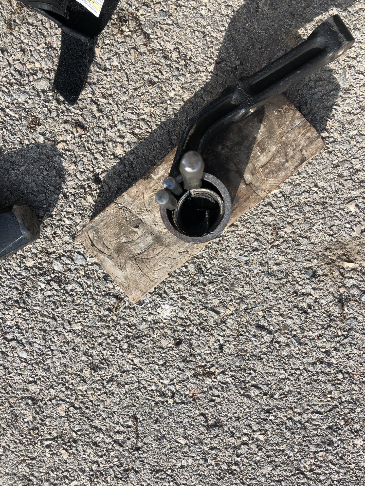

For what it’s worth I used a hacksaw, and a cheap set of cold point chisels from Walmart plus a stubby 3lb hammer for HF to get the inner ring out. I made two cuts, on opposite sides of each other, then went after it with the hammer and chisels walking around the perimeter of each side. I started with the smallest of the three chisels, drove it in a bit, then grabbed the next size up and drove it in until the smaller chisel broke loose or if it didn’t I just grabbed the largest of the three and drove it in until one fell out. Either way one would come out and I’d use the smallest, or thinnest one available at that moment to drive in just passed the next one in line. Neither of my cuts seemed to go all the way through the inner ring but weakened it enough in those spots to eventually curl in on itself. I did that all the way around until it finally broke free. Wasn’t easy but was able to make it happen with $10-$20 worth of tools.
I attempted to drive the new Superpro bushing in with a mix of tools ranging from a gear puller, ball joint press, an 8” grade 8 bolt, with a bunch of washers and some giant nuts I had laying around, and tried driving them with my cordless impact. None of what I had on hand was the right size, including the cups that came with my ball joint press, so I got it in about 60% of the way and took it to a local 4WD shop the following day and had them put it on their press, for a nominal fee of $35... oh well, I was over it by then.
Pics are of how I worked the OE inner ring out. I didn’t get pics of me driving the new bushing part of the way in as I don’t have a vise, absolutely crucial at a minimum to do this job at home, and only had two hands.
I had similar troubles with clearance but wound up using a 19mm short socket and 3/8" ratchet which I could squeeze above the PS lines. Worked for removal and installation.
