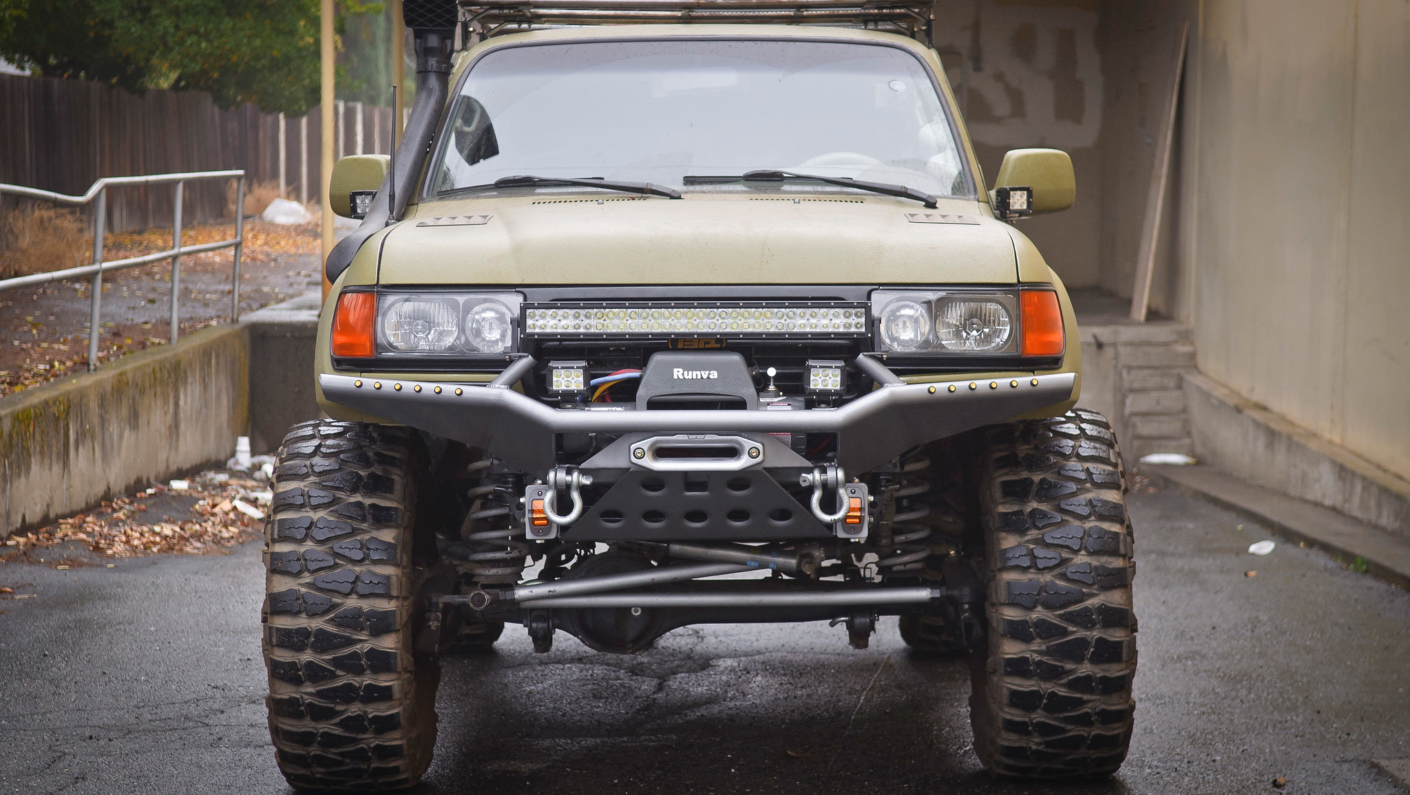

I don't have experience with ARB, but for light weight I mounted the Metal Tech tubular. Protects all the main giblets from the front and mounted an Engo 1000S winch no problem. With winch mounted, I can easily put it on and off, not heavy. Encounters with other non-moving objects have shown only scuffs. Solid recovery points (2), and 4 mount points for future lights.
image-jpg.1045830
image-jpg.1056027
