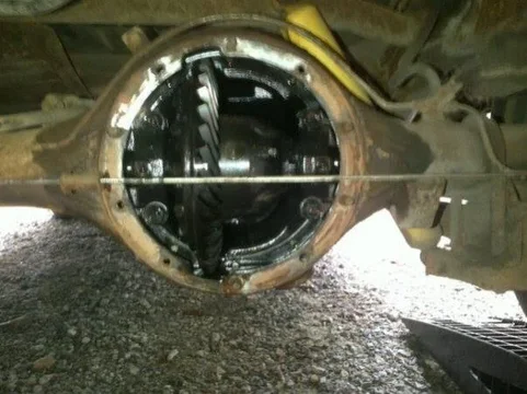

This bolt is the pinnicle of all evil reincarnate
Broke the die, then when trying to drill out the die, broke the bit...
Dude...
Weld something to it.
A bolt or socket, and it'll be out in seconds.
Unless you want to come down to cordova bay, I might just get a new diff cover...
It is literally the bolt from hell.
just pull the diff cover and take it to any shop with a nut or a socket for them to weld on if you don't have a welder... take a 6 pack to trade them. 5 min... and fixed.
Good plan, perhaps you could use a couple fine brews...
He might be just a smidge too far away...
In a pinch, you can fill the diff through the breather on the axle tube, or even through a bolt on the diff cover if you pull one of the studs.
I had the same issue years ago on a full floater, which meant no removeable cover. I used the breather hole quite a few times...
At least you could drive it to someone with a welder then. Save you having to pull the cover off.
Pulling the cover and having it dealt with is a good idea.
So is taking it to Dan's for some help.
I would first go buy a propane hand held torch, get a yellow bottle of gas rather than propane as it burns hotter. Head home and heat that sucker up as hot as you can get it with the torch. Get vice grips on it and it will come out easy peezy. The torch will come in handy for everything from brake lines to wheel nuts. Very handy tool for rusty Cruisers.
after 120,000 km on that diff oil she is about due for a changeout whether she needs it or not :hillbilly:
I shot Dan a PM, haven't heard back from him yet...
As for the vise grip idea, the whole bolt is rounded off from my previous endevor with vise grips, might give it another shot though!
Got the bolt off!
Torched it, flooded with penetrant, and went to town on it with vise grips
As for the mysterious vibration at speed, I'm beginning to think its my pinion bearing on the rear axle.
Going to see if there is any movement tomorrow
Put T/C in neutral and try and move the flange at the pinion and the T/C if there is play at T/C, I recommend rebuild and same at diff. Also look for play in Ujoint
Filled up the transfer case and rear diff, checked the pinion bearing on the diff and the bearing on the transfer case as well and no shake or rattle was heard :lol:
Took her for a spin and once I got it on the highway at around 80-90 the vibration was heard again... Im beginning to think that I might have flat spots on my tires...
Any other speed there really isnt any other sound...
Got a fancy "New" diff cover in the process though!
