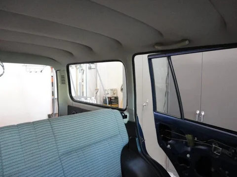

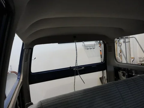

The headliner seemed to have shrunk a bit, either from the washing or from the rubberized fabric contracting when not under tension, and I had to pull pretty hard towards the back. I pulled the hoops and clamped it for a few days then pulled again to get the wrinkles out and glue the edges.

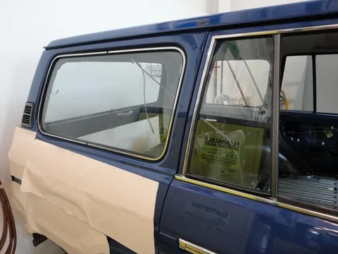

The window wasn't too bad to get in but the chrome trim was a major PITA. I hired a glass company to put in the windshield and they wouldn't touch the trim. On the dark blue I think the chrome looks good but on a white or tan Cruiser I would leave it off and save money, time, and frustration.

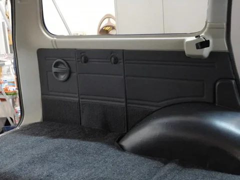

I added more sound block to the side panels, placing it around the interior struts. This was ordinary duct insulation from the local lumber yard. It's cheap and the last roll I used has held up for over a decade with no visible degradation.
I put the side panels up temporarily with only a few fasteners to get a sense of progress and to clear the shelves of parts before they got damaged.

It's starting to look like a Land Cruiser again.

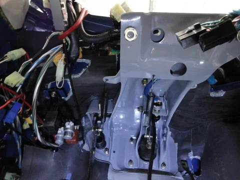

I cleaned and repainted the pedals and pedal bucket. I've had troubles with the rubber grips coming off so I glued new ones on.
Assembled with the brake light switch and ready to mount.

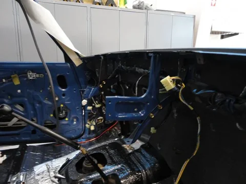

Installing the bucket helped hold up the wiring harness and insulation. As I mentioned before, getting the bucket holes to line up with too thick of insulation was a major pain.

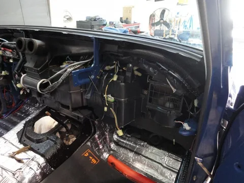

The blower, heater core, and AC installed.

Just took my heater, a/c unit and blower out and was wondering if you just cleaned yours up or painted them? Did you replace the foam pieces in each of the units? Thanks and your ride is looking awesome:bounce:
Thanks bluehawk. It's nice to get feedback.
I disassembled and cleaned everything with soap and water, no paint on the plastic. I replaced some of the foam gaskets. The light grey rings around the outputs to the side ducts are new. The foam donuts to the center vents was still intact. Most of it was in surprisingly good shape.

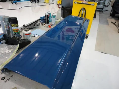

Somewhen about this time the tail gate and lift gate returned from the paint shop. I put assembled them but didn't install them right away. The tail gate in particular would have been in the way until I was done in the cargo area.

I had the windshield, hatch, and quarter glass installed by an autoglass company. Those guys made it look easy but, as I mentioned, wouldn't touch the chrome trim.

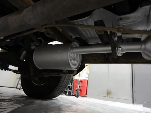

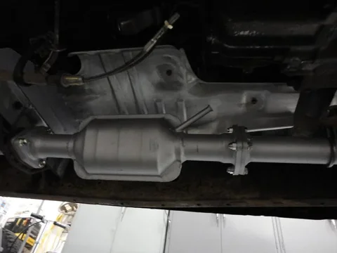

I chose to stick with the OEM exhaust. It costs more but it bolts right in and replacements always fit.
Yes, I painted the exhaust... Does that mean I need therapy? :hhmm:
SOR's bolt in replacement cat. Fit was good except for the odd choice of angle with the sensor probe.

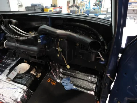

For those of you wondering how the ducts are routed behind your dash.
