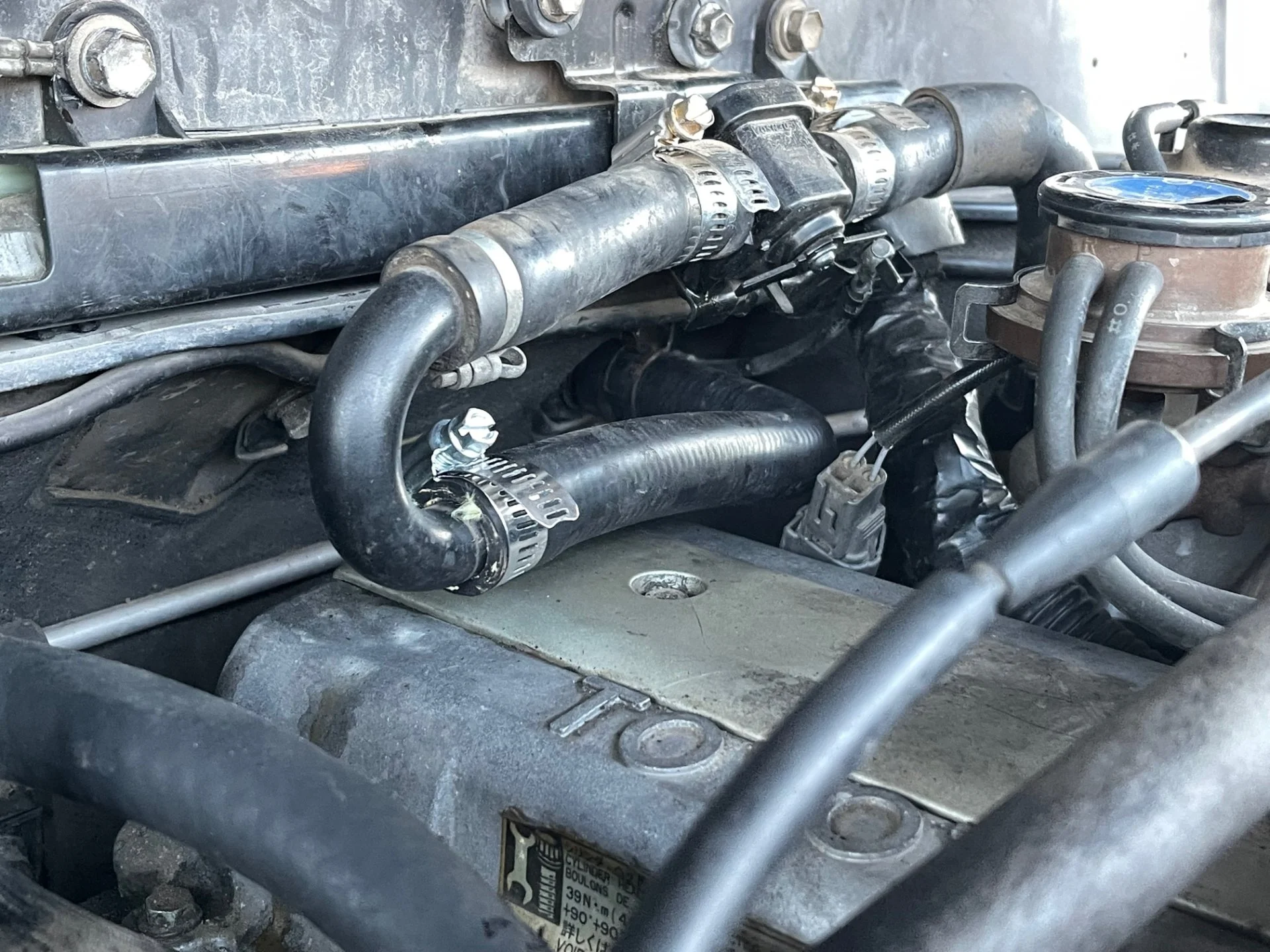

I know what you are looking for but I used Gates 28467 and cut it down to size.
I'm not deleting my rear heater, just wanted to eliminate two hose clamps, one hose section, and the U pipe and instead run a U shaped hose from the right side pipe on the heat control valve down and back 180 degrees to the stock pipe that feeds both the main and rear heater cores on the firewall.

I'll see if I can see the number on my hose, it was faint, but it was impossible for me to find that hose anywhere else but LCP. I think there is a thread where Phil sort of alludes that he's the only one who carries that hose.

Dave 2000: the original set up on the right side of the heat control valve in a US FZJ80 is hose-metal Upipe-hose but it seems more complicated than it needs to be (four hose clamps). A WAG why Toyota used the metal U-pipe instead of a U shaped hose is maybe the metal will last longer (moving water and particles) turning a corner, abrading the inner wall, or maybe??
But then Toyota has U curved hoses in the water heater circuits of other vehicles.
Example: I recall a ship I was on years ago had a ocean water intake pipe (about a foot in diameter) with a 90 degree turn. That pipe developed a leak while at Sea, a hole, in the curve of the pipe and the chief engineer said it was just from the moving water eroding the inside of the pipe in the turn. They pounded a stick of wood into the hole (which sealed it) as a temporary fix until they got back to port.
Point is, I can put the metal U pipe back in with new straight hose sections, just looking for options.
The hose in that attachment is used when the rear heater circuit has been deleted.

Amazon product ASIN B000C2U8Q2
Thanks. I ordered a Toyota U shaped hose mentioned above (for a 80's pick-up)
but the "legs" may not be long enough due to the difference in length of the heat control valve pipe and the OEM pipe that feeds both the main and rear heater.
I did find a Gates hose # 18701 that may work, probably have to cut one leg to fit.
Amazon product ASIN B00LGPQBHE
Update for future reference: the Toyota U-shaped hose mentioned above (16261-35030) from a late 80's early 90's pick-up will not work. I ordered one yesterday as it looked like it might just fit, turns out it has a 1/2" ID and that section of heater hoses coming off the heat control valve are 5/8" ID.
I did pick up the Gates18701 formed U-shape heater hose. Will update the thread once I get back to the vehicle to see if it will fit.
