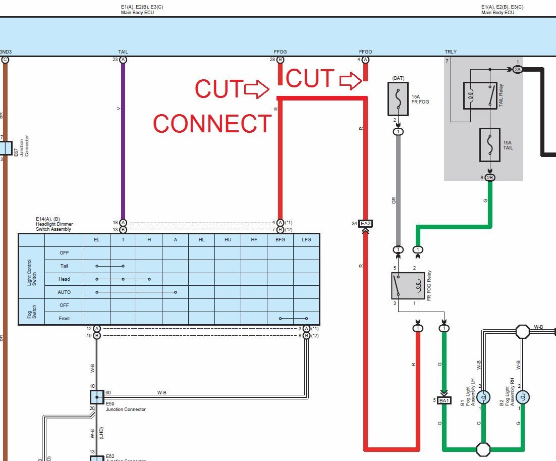

Based on the EWD, looks like a simple mod.
First the disclaimer: I would not perform this mod without verifying functions and it's safety with a DMM and I cannot be held responsible for individual results contrary to the desired end result:flipoff2:
It's not something I have a desire to do, so I probably won't look into this on my own vehicle either;)
Here goes: Cut two wires and reconnect, bypassing the Main Body ECU

In another model I'm familiar with (IS300), all we did was jump a wire in the fuse area, rather than having to cut anything. I wonder in the diagram above, if a simple jumper is all that's needed?
It's absolutely possible. What this would cause is back feeding voltage into the input of the CPU, which is set up to "see" ground on its input. May be a problem, may not...

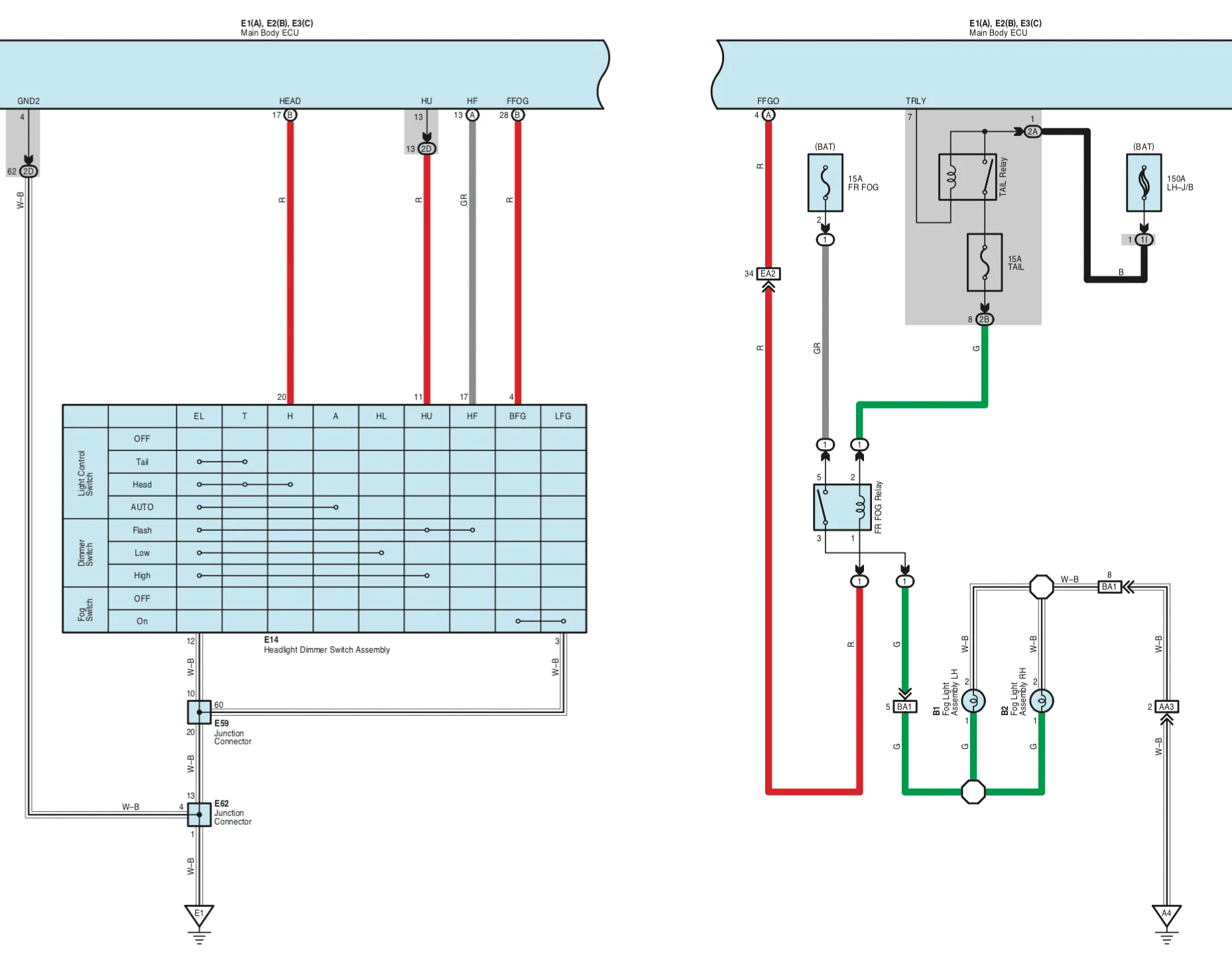

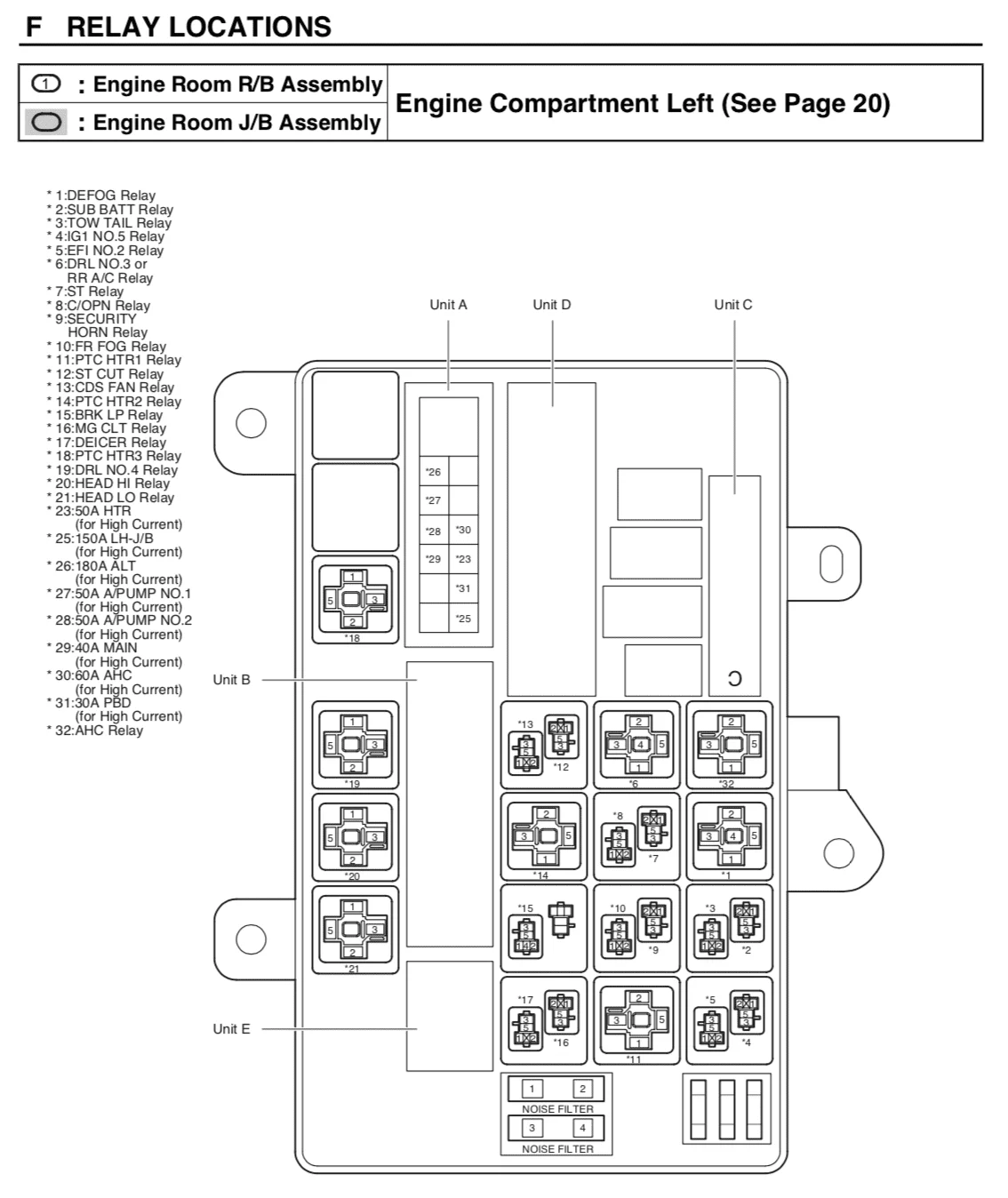

From my read of the EWD the low side of the fog relay is drawing power from the tail light circuit causing the fogs to only turn when the tail lamps are on (headlights or parking lights on).
If my read is correct then you want to disconnect at pin 2 of the FR FOG relay and reconnect to ignition switched 12V. The 4runner guys do this by bending the tab out and using a spade terminal:
