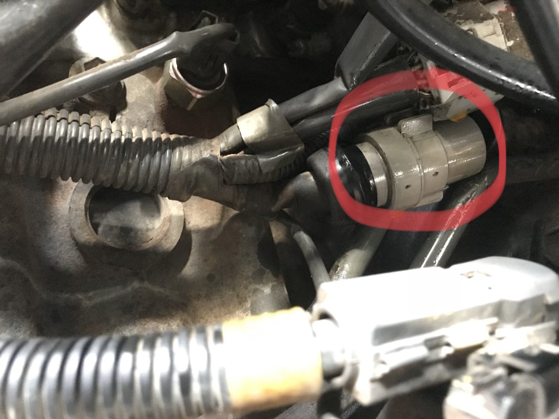

Going down the nss rabbit hole now since i cant get it started. I got all the lights you're supoosed to, right?
got the thing undone from the NSS and flipped over to the driver's side. I can't figure out how to remove the white retaining clip???
Not sure about that link, my NSS connector didn't look anything like that.
My NSS connector looked like this:
Which reminds me, you should also check those two big wires in the NSS, 2nd picture in the link. I had to replace both of the corroded pins on the larger black/red and black/white wires going into the larger connector. They were both corroded and had fallen apart.
After replacing those with brand new parts I still had the no start problem and eventually took the whole NSS apart to do the copper contact cleaning/sanding flat like I mentioned above.
To troubleshoot it in the meantime you can try pulling those two larger gauge wires from the connector and connecting them together for now. That will bypass the NSS for starting (everything else will work as far as gear shifting/neutral/backup lights) but just be absolutely careful you don't try to start the car in gear cause connecting the black/white black/red wires together will bypass the safety the NSS is meant to provide.
I would try connecting them for now just to see that your no start issue goes away, that way you will know for certain your no start issue resides somewhere in the NSS or NSS connector/pin terminals.

Well, some times taking your own medicine is the hardest thing to do. I got home this evening and grabbed some wire to jump battery to solenoid. I figured I'd try the key route and i stopped even getting the click from the starter. I remembered i had unplugged the nss and fed over to the driver's side of the tranny.
So, i said, "lazy, be lazy. And check the connectors before you plug that bad boy back in so you dont have to unplug it again " I finally figured out how the lock comes out. Spoiler, it slides out. I used a pick to get it going and then took the whole thing out with some pliers. My connectors look like new.
Hmmm....i said to myself, might as well pull that nss off and check those contacts while your chubby self is sliding around under the truck. You need a 12mm and 22mm sockets. I finally got that off. Yes, my truck is dirty and I'm pretty sure my valve cover was leaking pretty good for quite some time (see op in this thread).
So, it's all cleaned up, copper contacts are sanded down flat. I checked continuity at the 2 solenoid wires at the connecter holding the copper across the nss copper rail things - 0.1 ohm. I assume that yellow stuff is dielectric grease?
