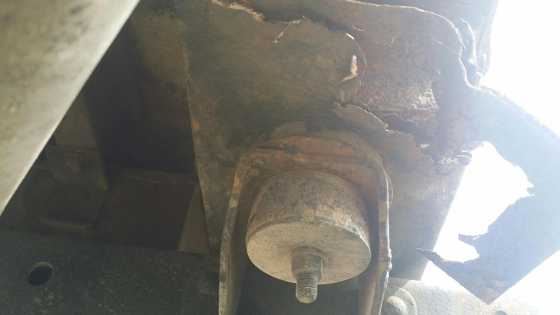

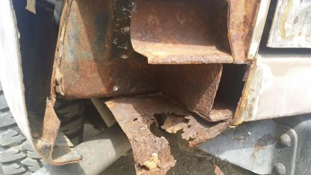

I think our issues with the driver corners is related to the routing of exhaust out that corner. The rest of my Pig is pretty much rust free. I've had several Pigs over the years and have always wondered why they seem to rust more on the driver side rear corner (excluding the drip rail issues for beach rigs). Made no sense when you think that is usually the 'crown' side of the road and should be drier. When I've had a chance to look at trucks with exhaust side routed (front of the rear axle) they seem to survive with less corner issues.

I believe the primary culprit with the DS rear quarter rusting is the gasket for the fuel fill neck failing. PS side only has a penetration for the rear wiring harness. The fuel neck gasket in NLA. I've tried the 62 gasket and it's not a usable replacement. This would be great project to reproduce.
