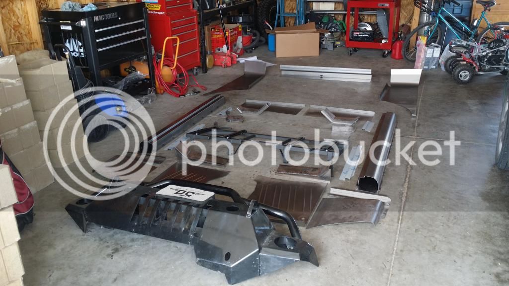

I would like to thank BobM on the 4th of July for his hard work and genuine USA made products!
(obviously not the bumper or the seat frame...lol)
I have a lot of work to do....
