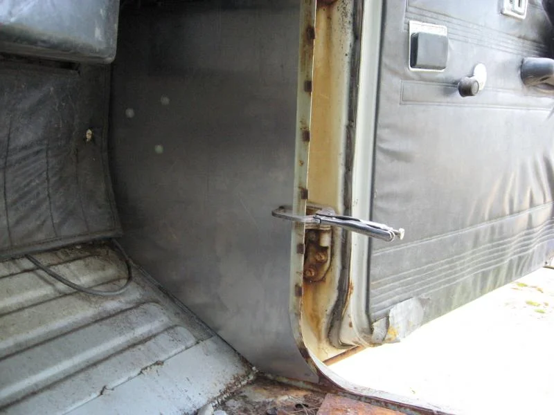

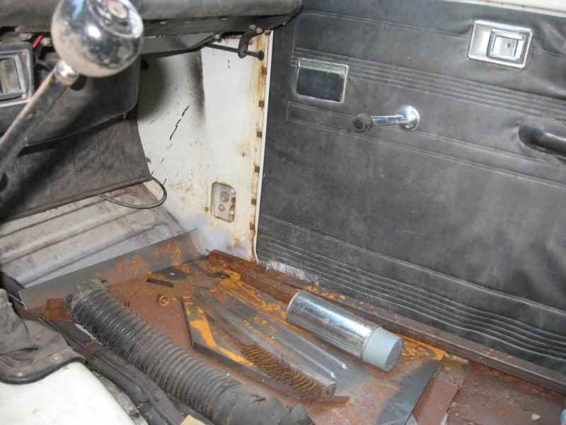

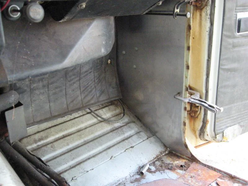

Floor pans,bodymounts floor supports rockers and rear corners.
Wow! Incredible looking!
I can't believe you cut that orange Piggy! What year is it? Looks nice and clean! Where did you find it?
Those are going to be awesome if they have all the provision built in (back-up lights, reflectors, 1/4 vents and gas fill)
Great job!
PS: my quarters are good, it is my neighbor "Piggy Love" that needs them.
Pablo, its a 73. and I cant believe I cut it up either, it wasnt in bad shape. It is the best way to develop the parts though. North Country Landcruisers. They will have all the provisions except the bump out for the reflector and will include the inner panel.
Thanks Bob.

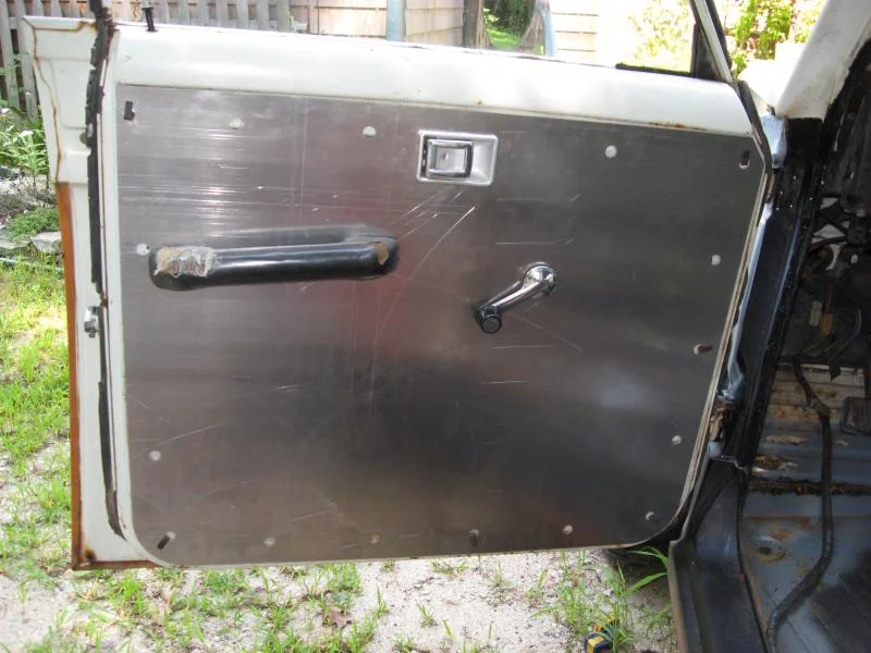

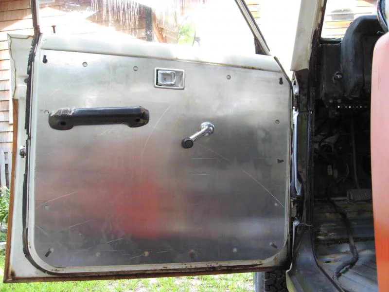

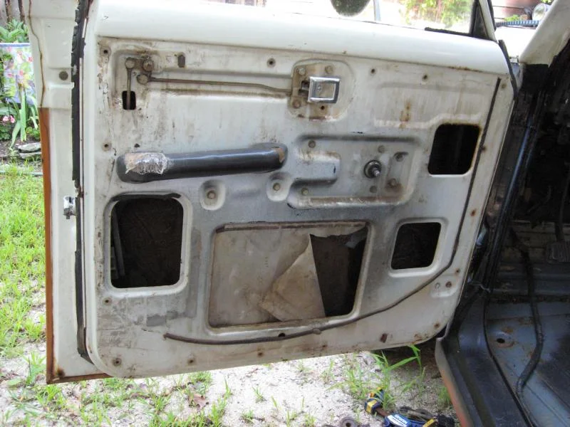

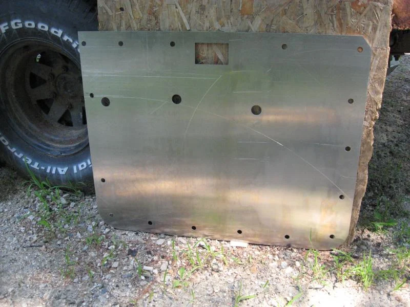

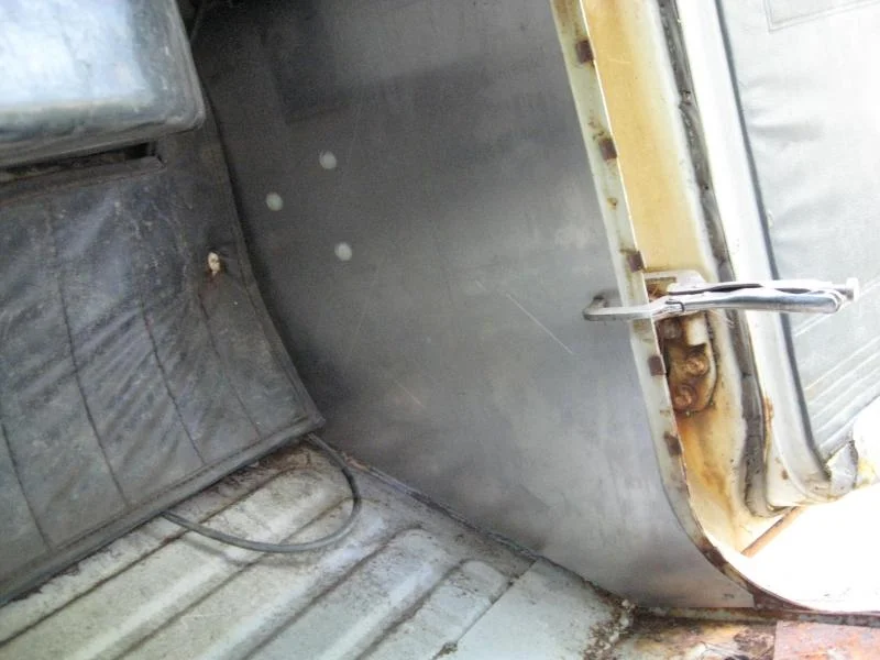

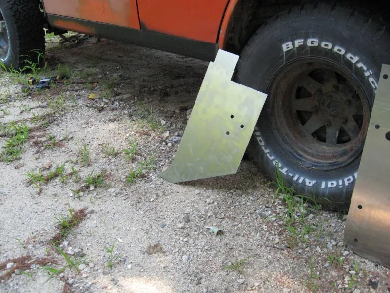

door and kick panels.
Made up a few replacements today. Will be covered with foam and Marine grade vynal in the future.
Thanks Bob.:)
Bob,
What's your thoughts, on fastening the foam and vinyl. I debated on just leaving the Alum. alone, just powder coat it. :confused:. I'm a long way off, before I take on the interior. Looks like quality work, as always.
bare or even painted/coated metals will be HOT in summatime.....on your knee/ elbow. I have black ABS on mine right now, and it's not as hot as the metal, but still think the vinyl or other material would be more comfy, less noisey. IMHO.
