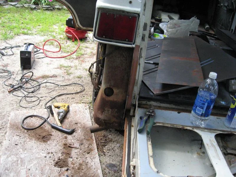

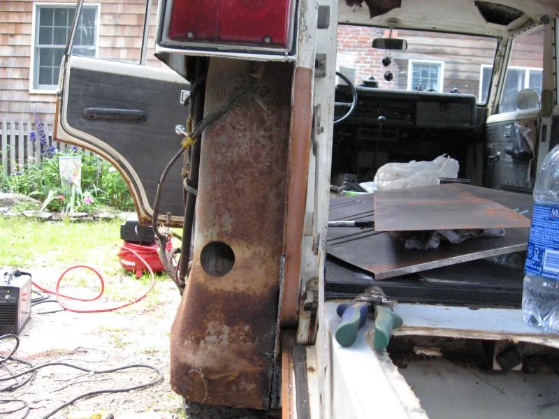

Floor pans,bodymounts floor supports rockers and rear corners.
Have you made any more rear corners yet? i would be very interested in the right and left sides. Thanks!

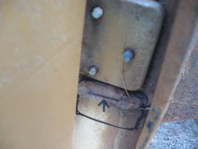

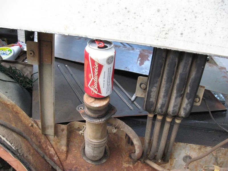

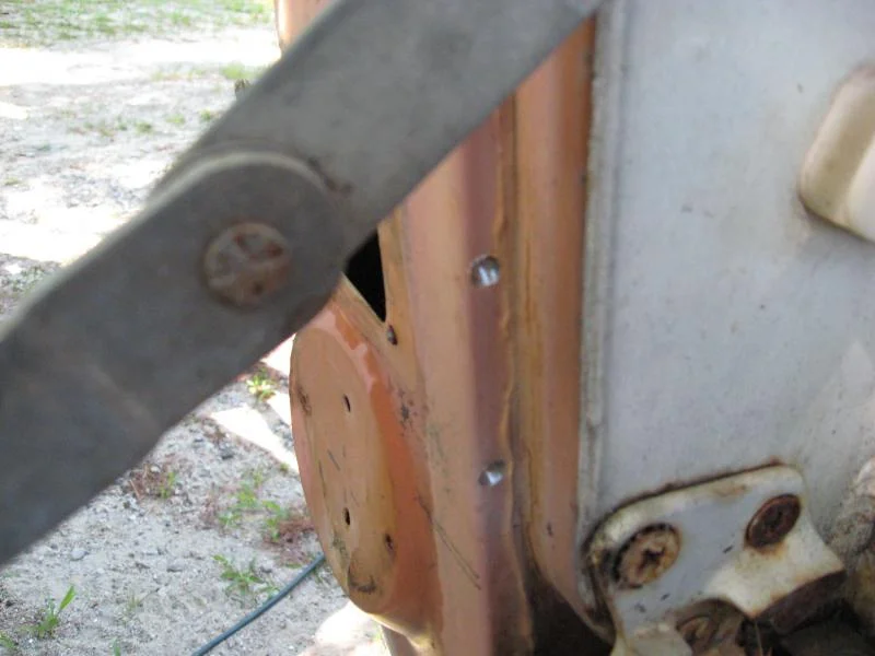

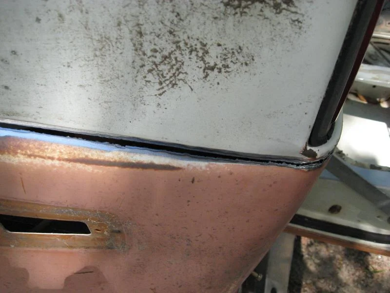

Anybody know what this is?
Take a guess

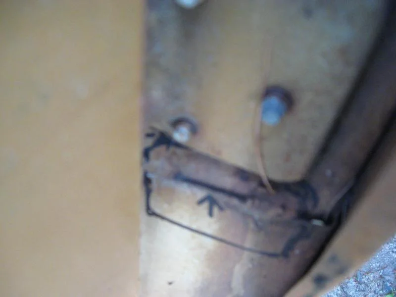

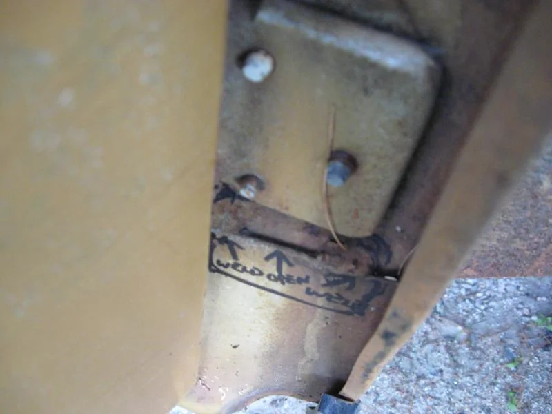

lower ape where the rocker rolled up into it. yep^^^
LANBCRUSHER Is correct. Water runs down your windshield and follows the "A" pillar and goes right into that opening and into your Rocker panel (which has rubber drain plugs.) thats why your ROCKERS rot out. Get some seam sealer and fill it.
Thanks Bob.

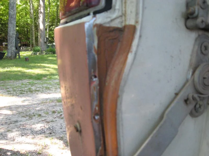

while I was in there.....I ran a bead across the seam AND smeared the sealer over it. I still have to remove the brake booster and clutch master and steering wheel to seal those places up before the rains come back.....

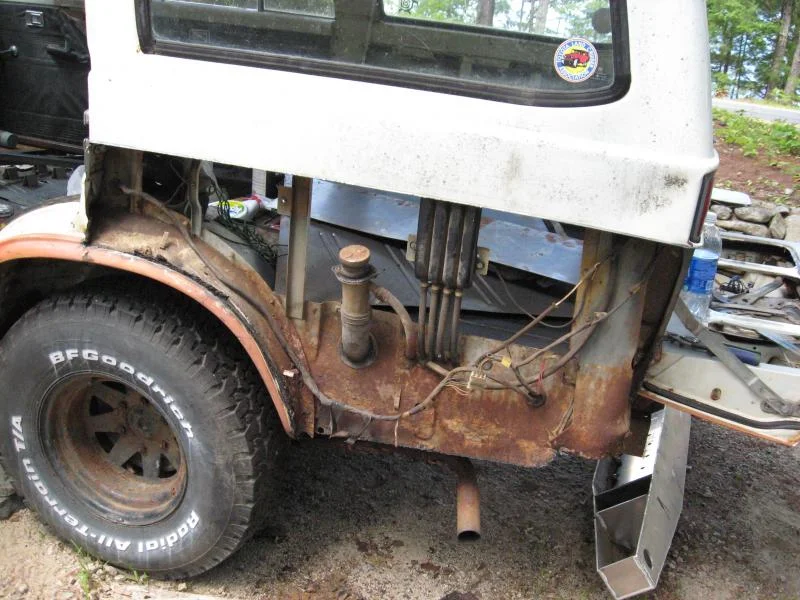

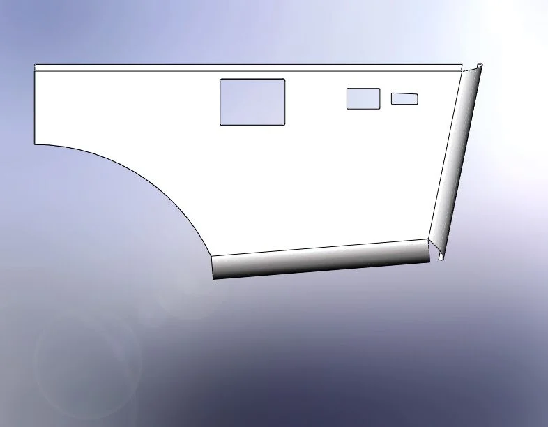

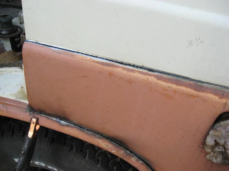

Those corners sure look good, I believe those are going to be a hot item.
As always, good job Bob!
Ron, thanks. If you noticed there is only one can. But thats changed. They will be perfect before I sell one thats why its taking so long. Pablo has 1st dibs.
