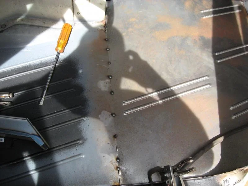

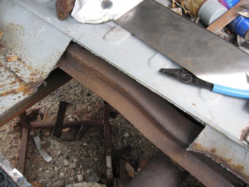

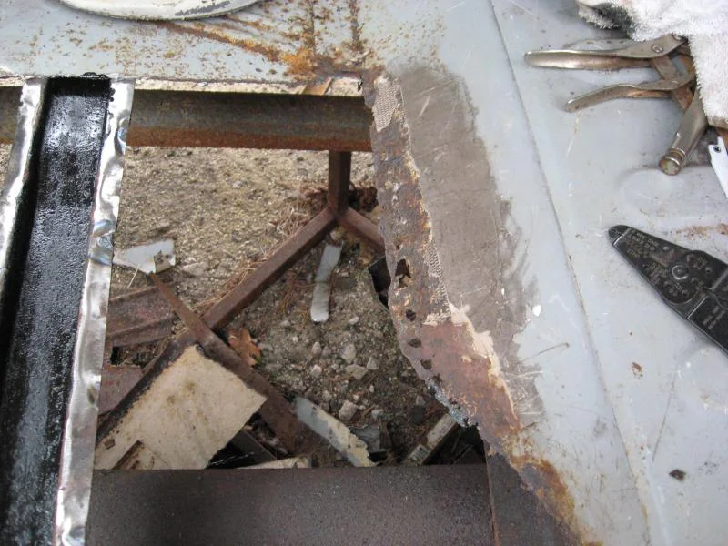

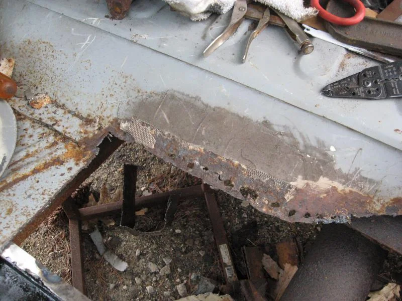

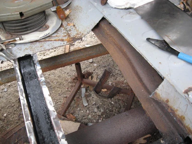

Skinned the pig today

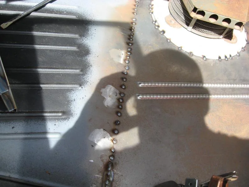

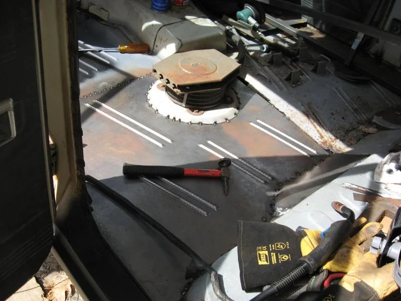

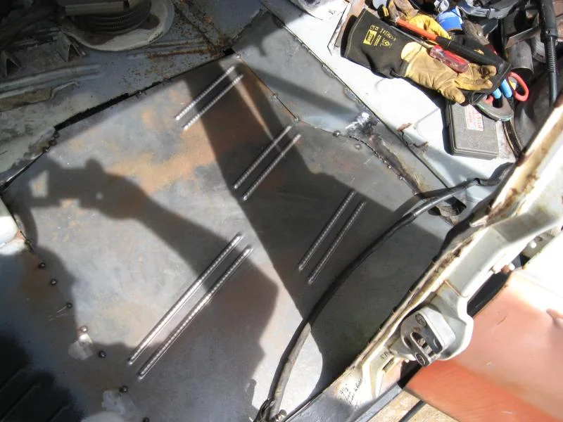

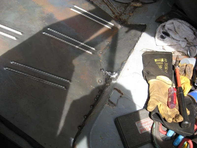

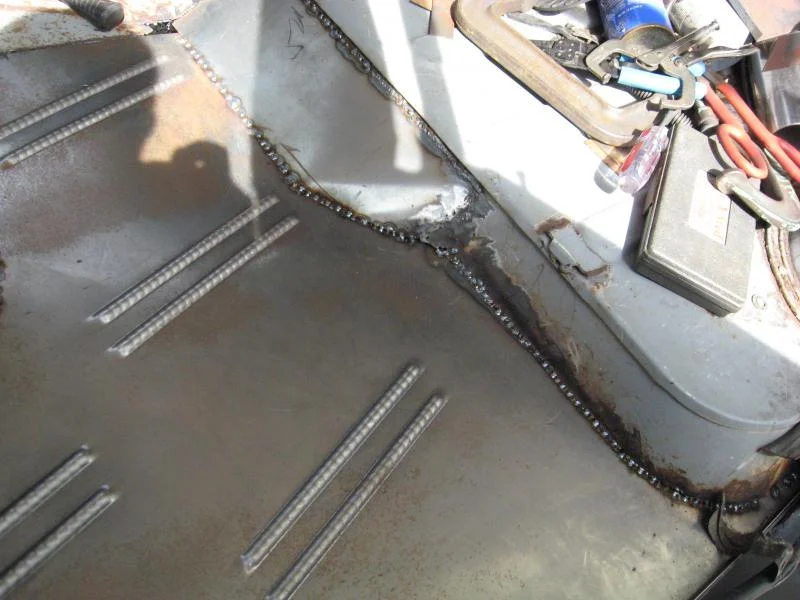

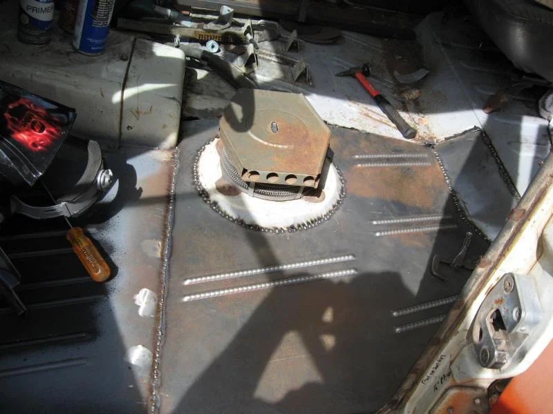

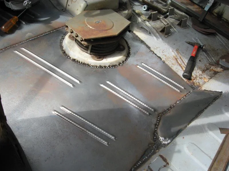

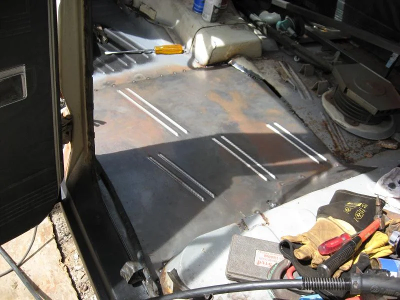

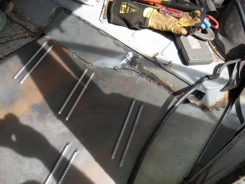

Got the rear fllor-pan in after a little cutting

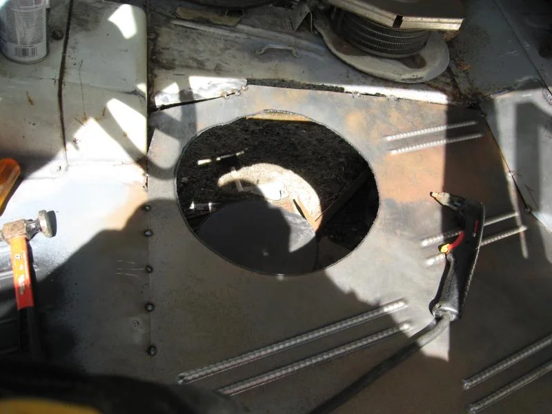

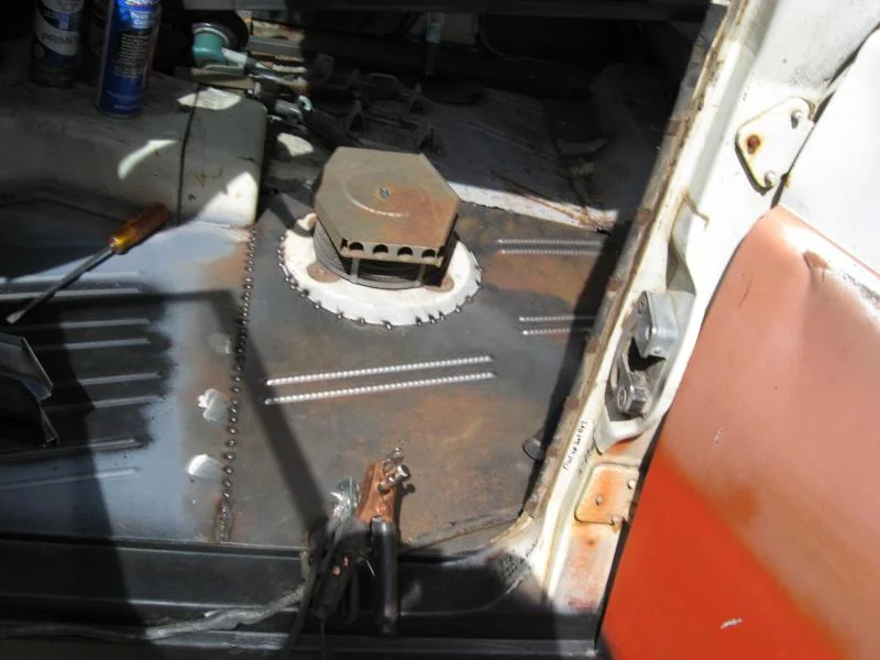

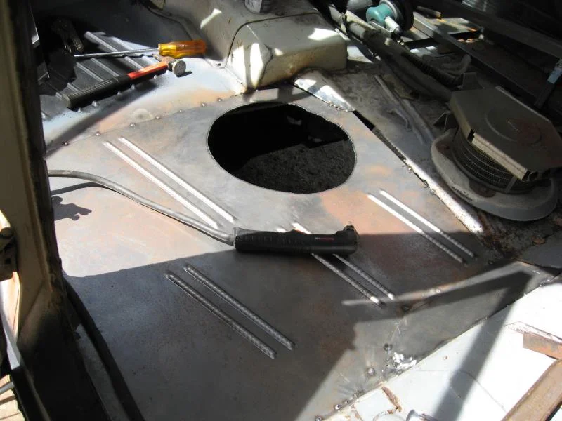

Man that's alot of work!. Good job, Bob. Please explain why you cut out for the heater. Have you decided what you're going to coat the floor with. I really am likeing the Zero Rust and the Lizard Skin. Seals the rust and really makes the metal quiet.
Take the rest of the night off!:cheers:
Ron, I cut out for the heater so it looks factory its not necessary. I am going to coat the floor with DUPLICOLOR bedliner both sides. Then with sound mat. And then with Marine grade carpet, so sound wont be an issue. I am also going to use Marine grade vynal on the headliner and door panels. I would use the Lizard skin but its expensive. Your PIG is looking awesome, wish I had the garage and rotiissere I would never be in the house.
