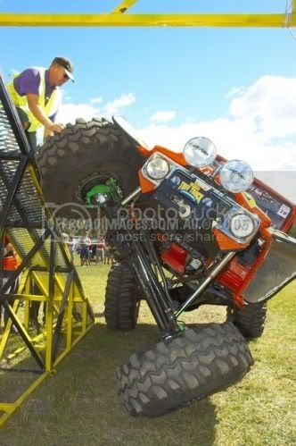

Very nice clean rig which looks like it will work well, but that ain't flex, this is flex on a full body FJ
