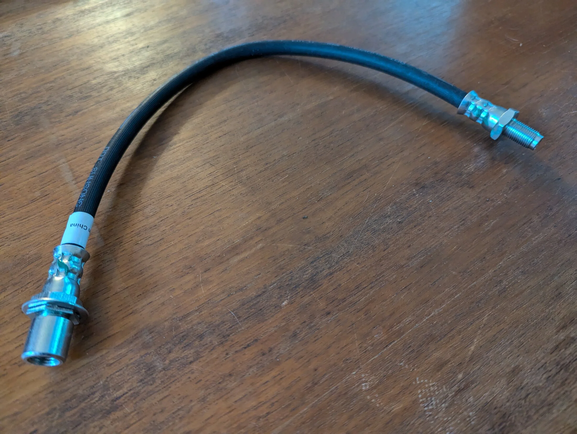

Received the raybestos stuff today... It looks right.

I like to use 96940-34305

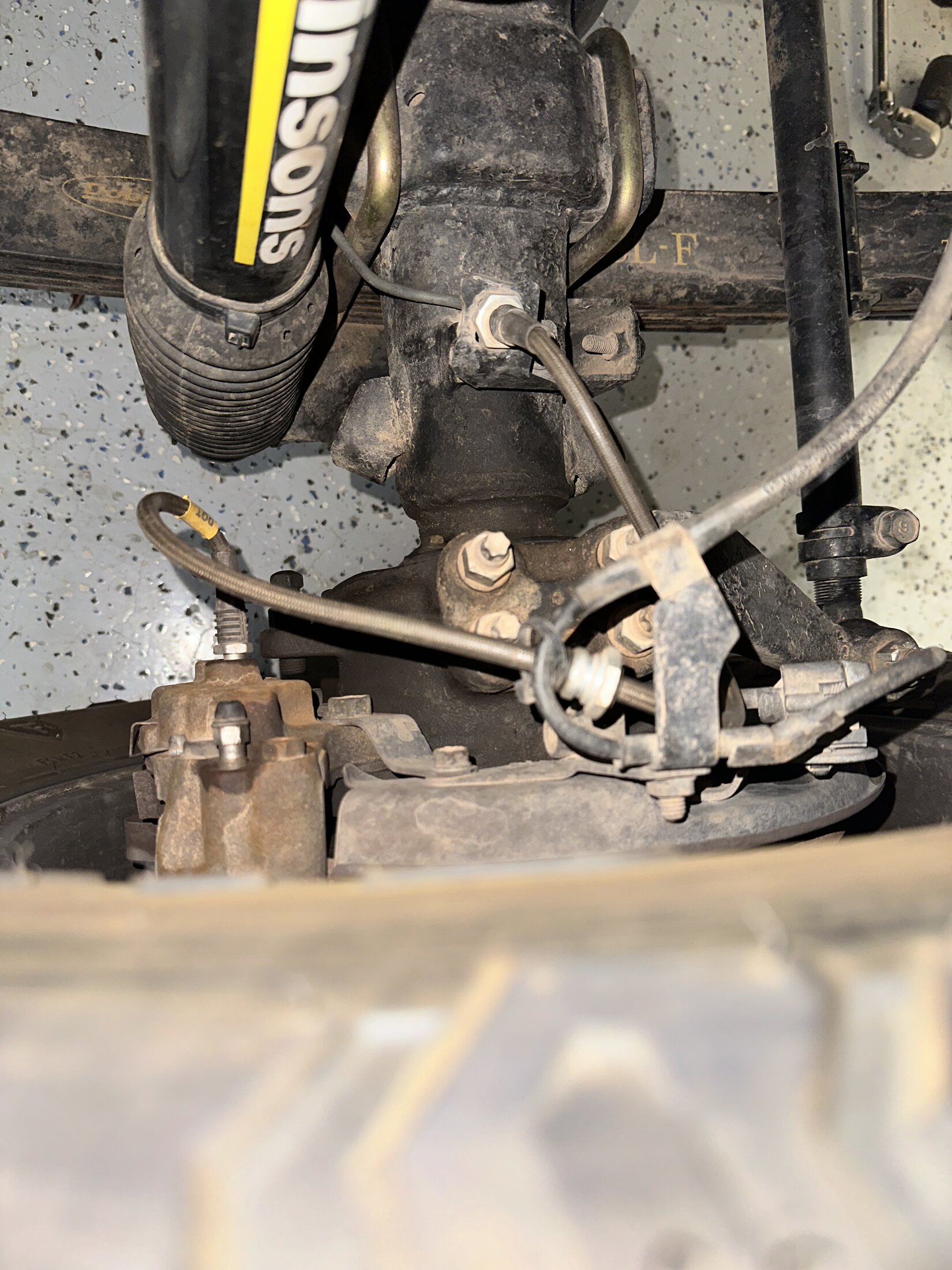

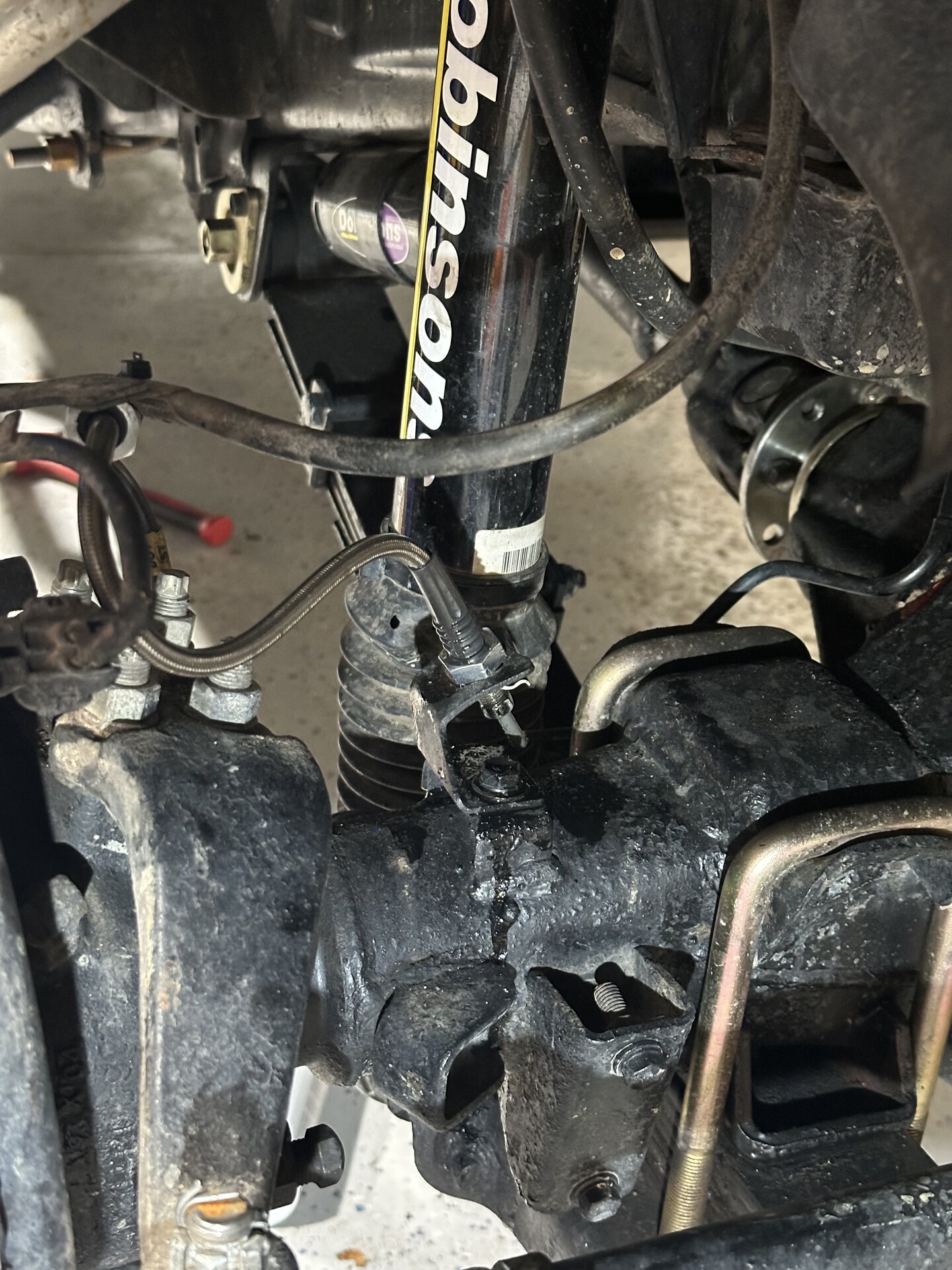

Here's a couple of photos from a 70 series using those lines:
Hopefully that answers your questions. Also, the PN @cruisermatt posted is a long OEM hose that will accomplish the same thing and doesn't have the superfluous brake line holder fitting that is on these stainless ones.
