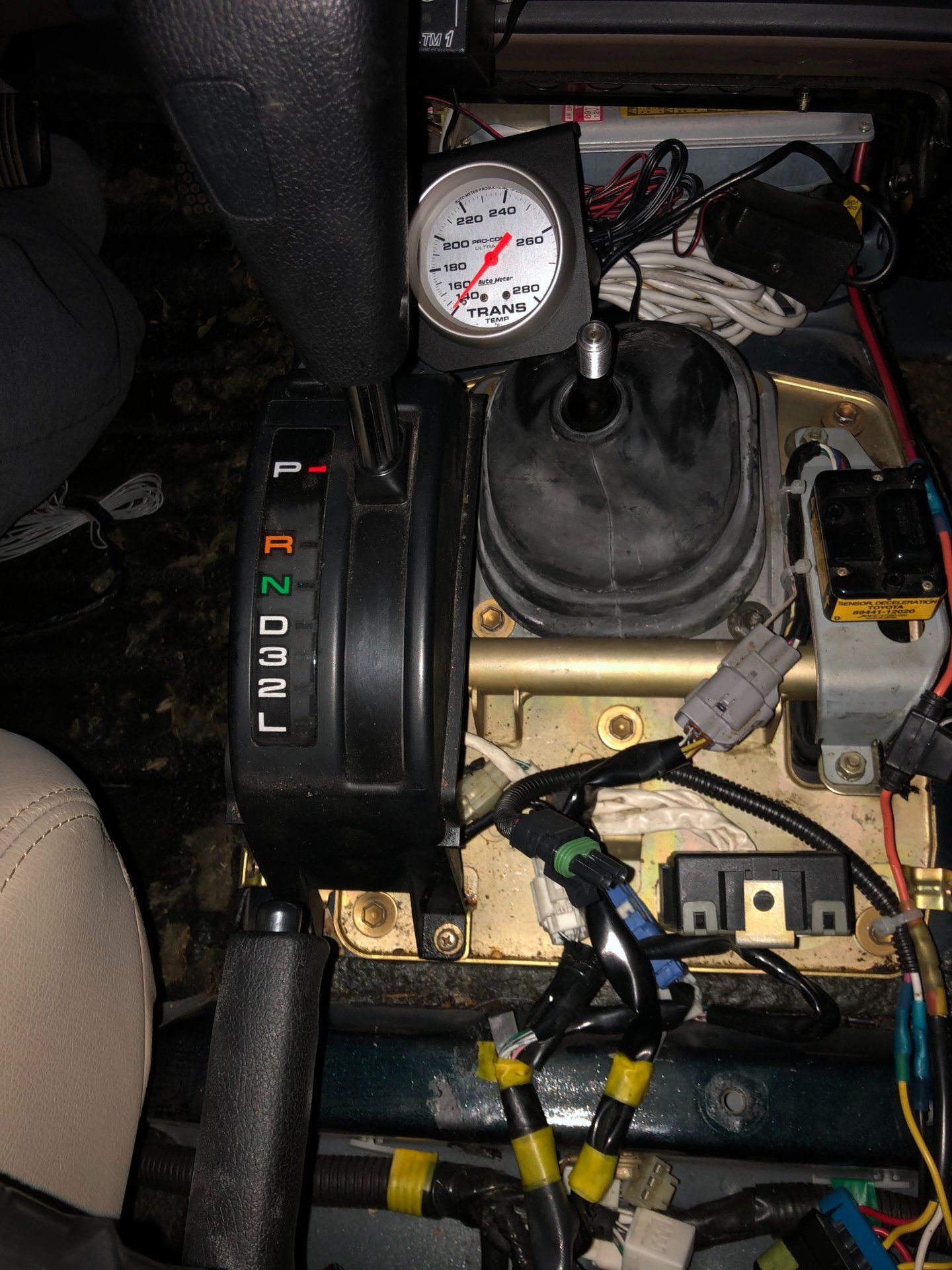

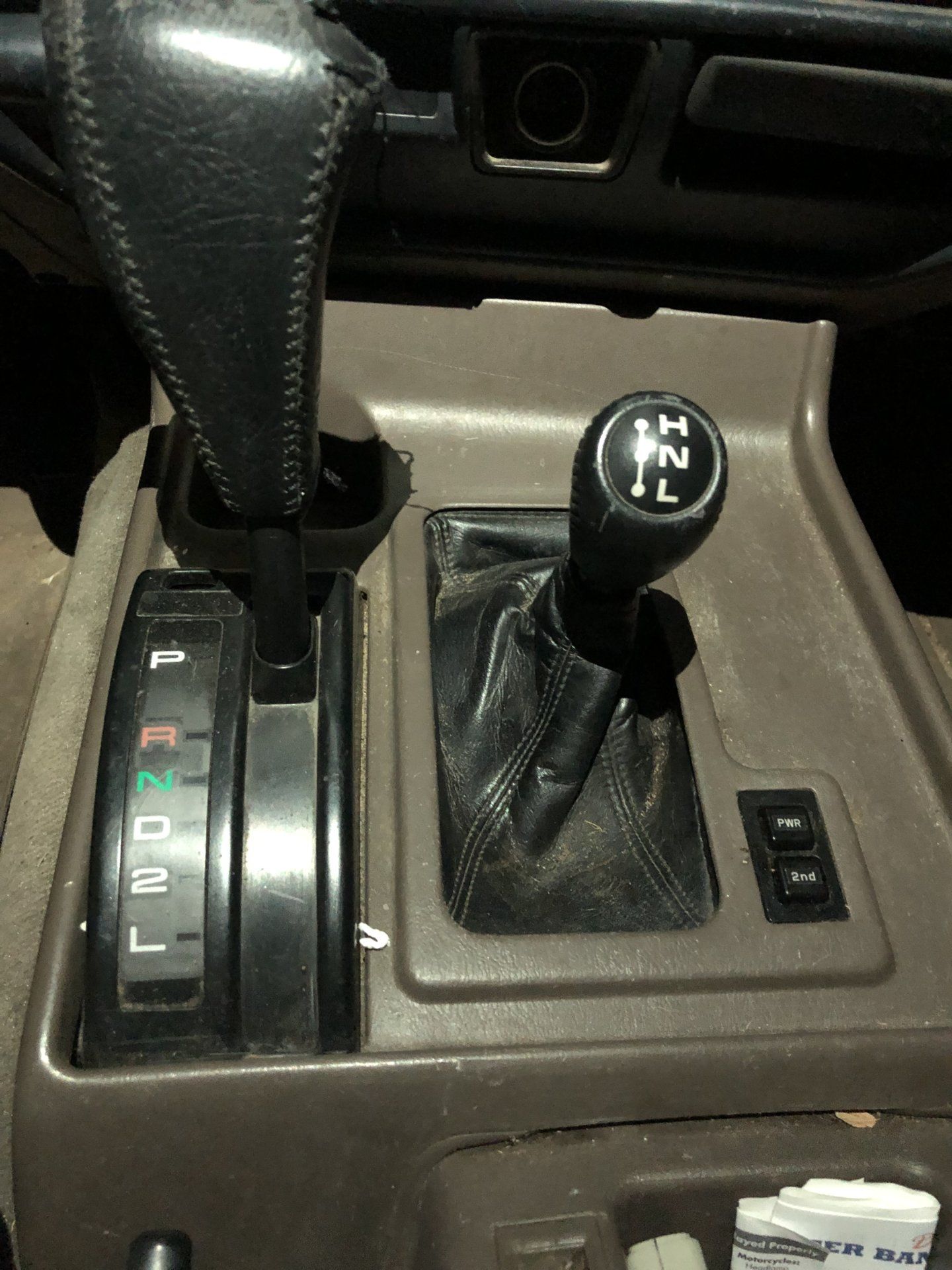

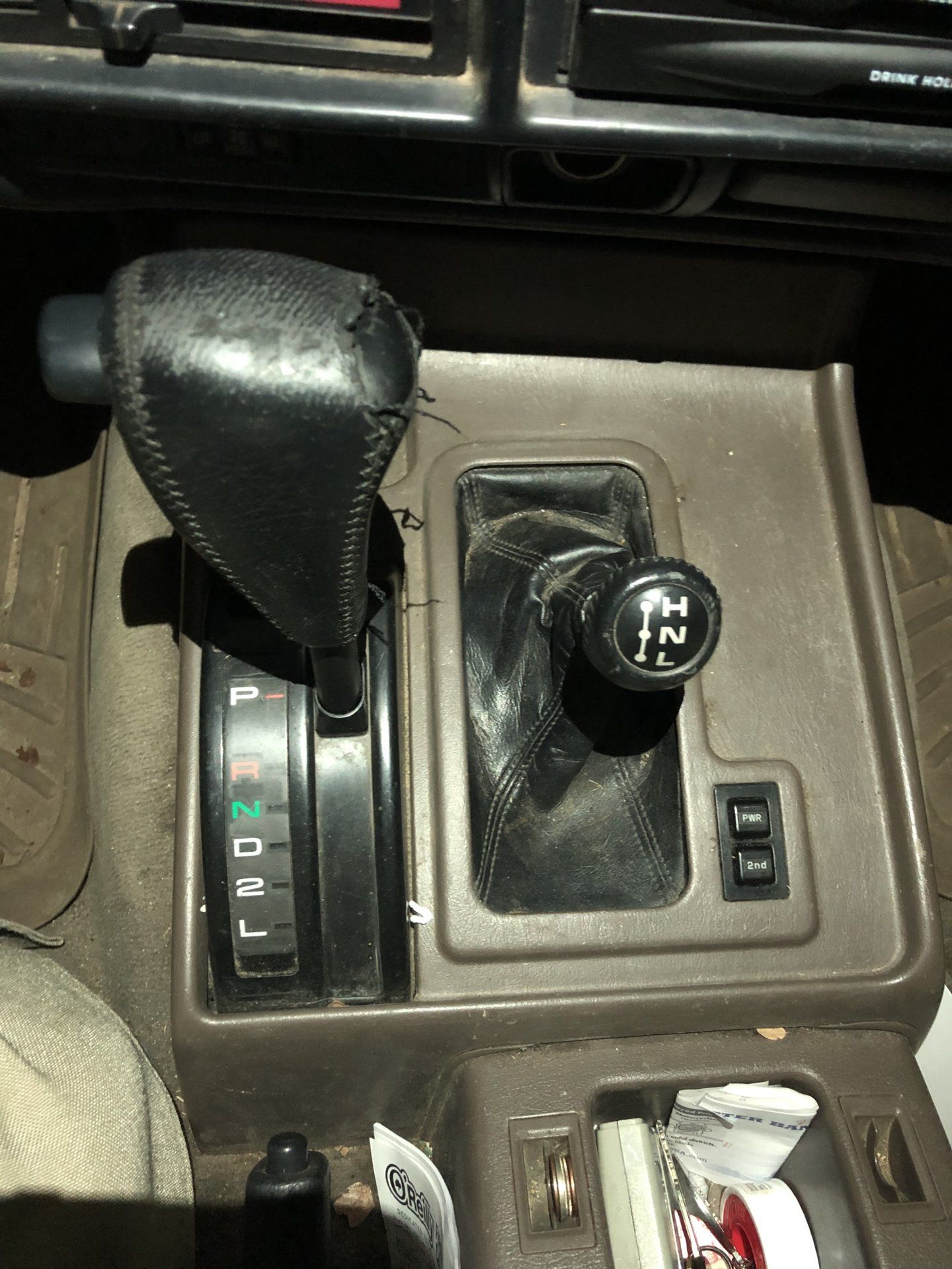

Mine, I used an ‘older’ 90/91/92 shifter assembly
Junk yard/pick n pull for the shifter assembly, don’t remember which. No other mods reqd if I remember correctly
Where did you get this shifter assembly? Also, did you have to modify the bracket to align the shifter in the console better due to an offset to the side caused by the t-case adapter?
I used the shifter that came with my cruiser. I disassembled it and modified the shifter arm to work on the other side. I think it took a wrench and maybe a grinder..
