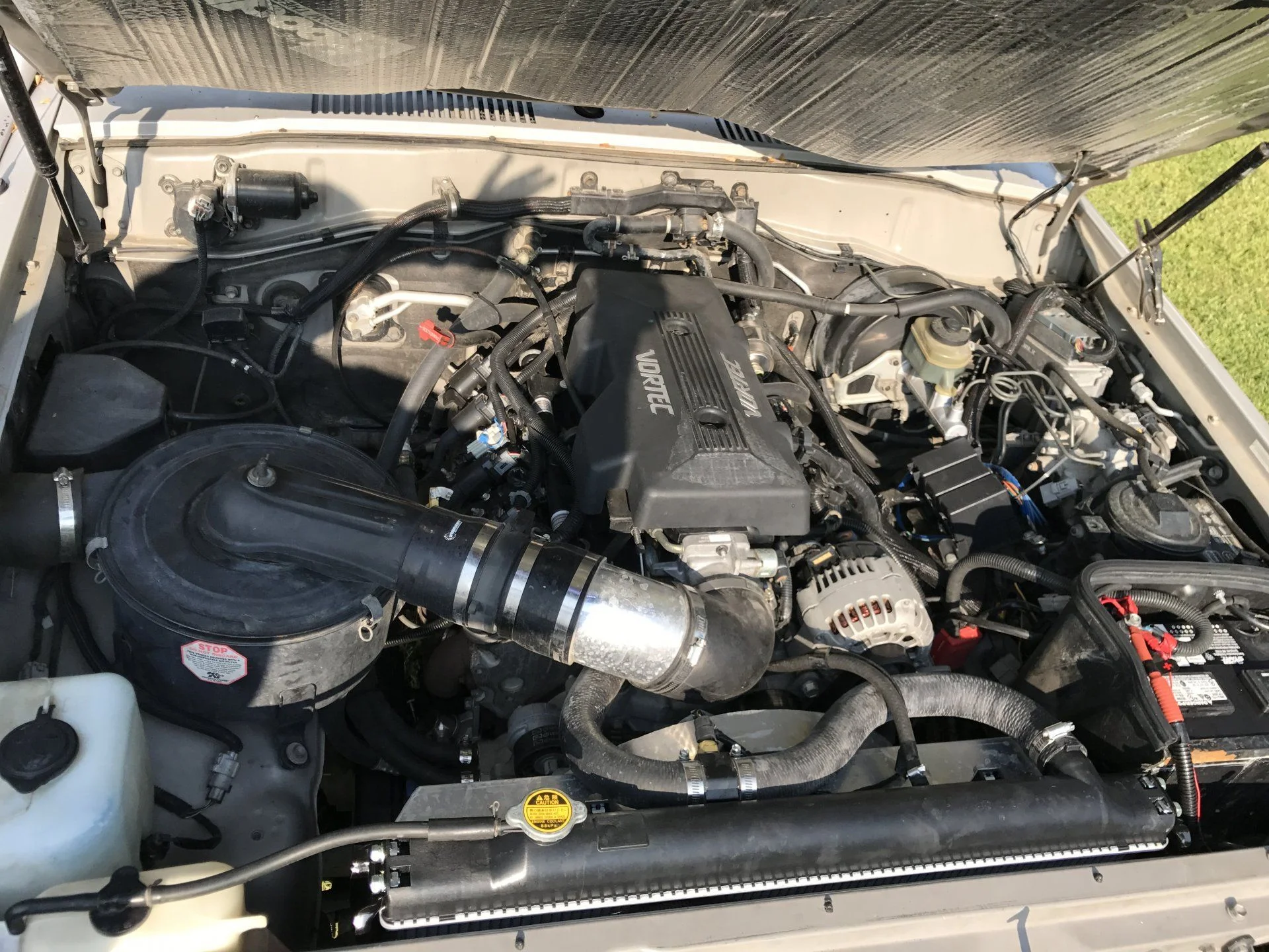

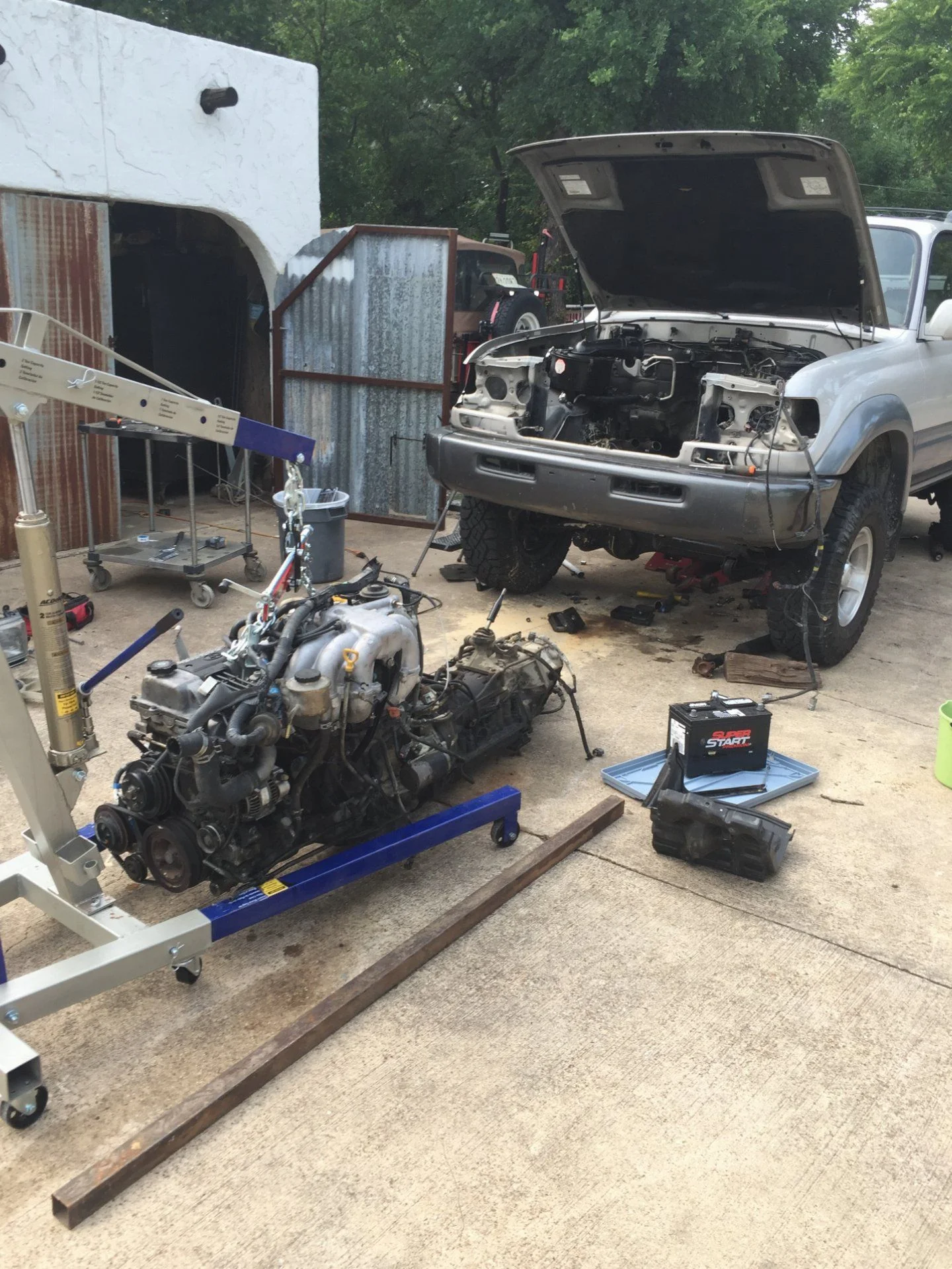

I just wanted to post some pictures of my 97 FZJ80 LS swap. I started with a bone stock 80 with a knock in the motor. I drove it with the knock while I gathered the parts needed to complete the swap. I purchased a wrecked 2001 chevy truck and used it for the drivetrain (5.3 vortec with 4L60 trans). The swap took my a couple of months to complete. The wiring was the hardest part. It runs great and is very dependable.

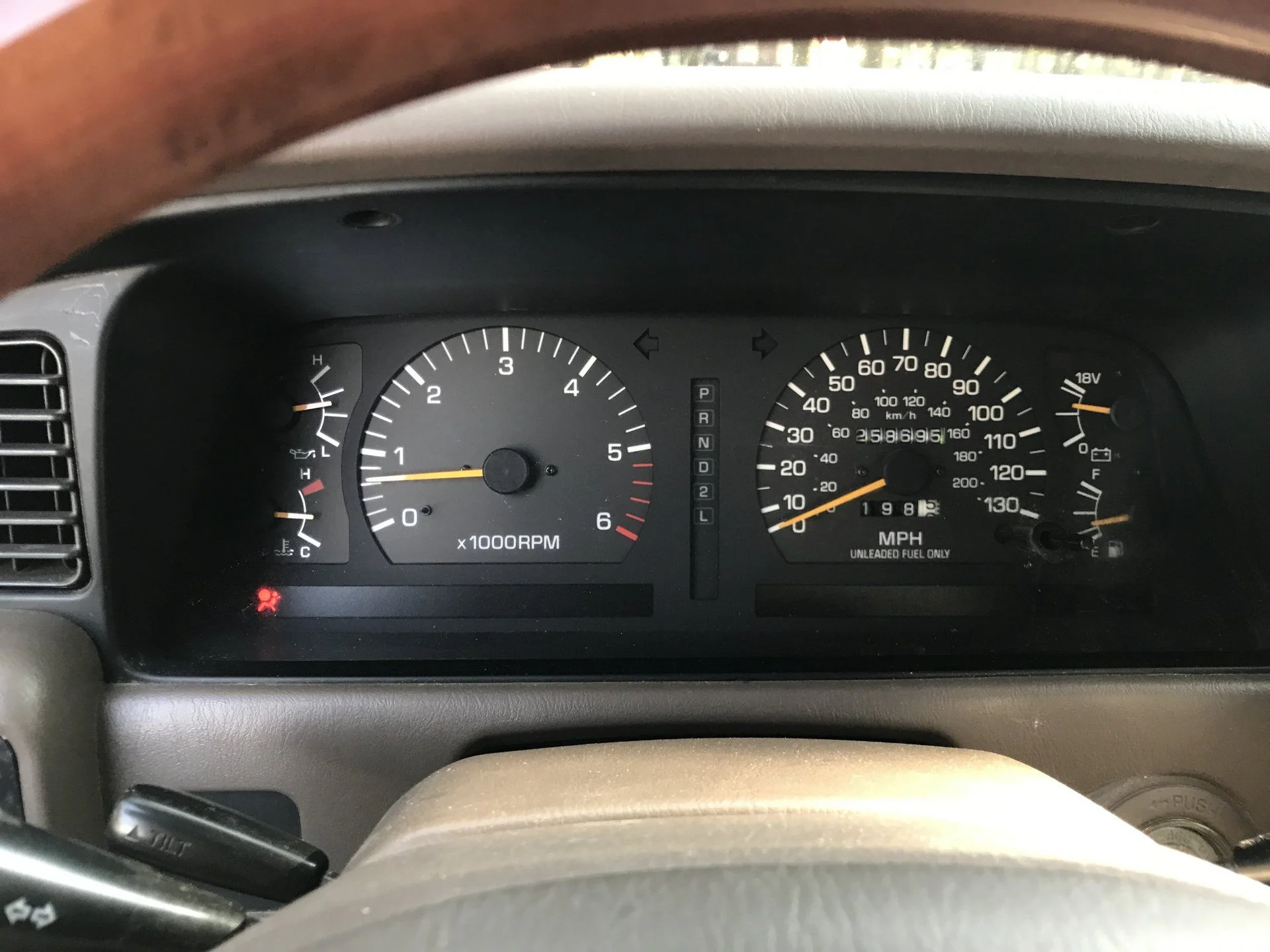

You had to load data into ecu, right? What cats and exhaust? Dakota digital to get gauges working? Cruise work?
Cruise will work but I didn't hook the cable up to the throttle body yet. Yes on Dakota box. I'm only running up stream o2 sensors so I don't have cats. I had the cruiser tuned to delete a lot of the stuff that I wasn't using. I had it road tested while it was being tuned so all of the shift points are set. I think that helps with the drivability of the cruiser.

Just a 90 degree elbow, a short section of straight tubing and a coupler on either side of the MAF for the intake? I like it! I definitely want to keep the stock intake setup when I do mine. Again on the cruise, will the stock Toyota setup play well with the gm throttle body? Or will you need any parts of the gm cruise control system to make it work?
If you have drive by cable them all you need is a Gm fitting and should be good to go. If you have drive by wire then cruise is a no go.

I'm sure the power difference is amazing. I was guessing it could be done for under 5K if you did most of the work yourself. Did you do the rewire on the harness, tuning, and computer flash yourself? Looks like a clean install. How did the transmission shifter work out on the inside? Was wondering how factory it would look. I've got a 5.3 LM7 currently sitting in my garage but it's going in a 77 FJ40 very soon.
I did all of the wiring (longest part of the whole swap). The tune was done by others (500$ and Worth every penny). Shifter looks like factory. I took it apart and modified to work with a custom linkage. It works great. If you are ever in Fort Worth feel free to give me a call and you can look it over. You can take it for a spin and see if you like it.
