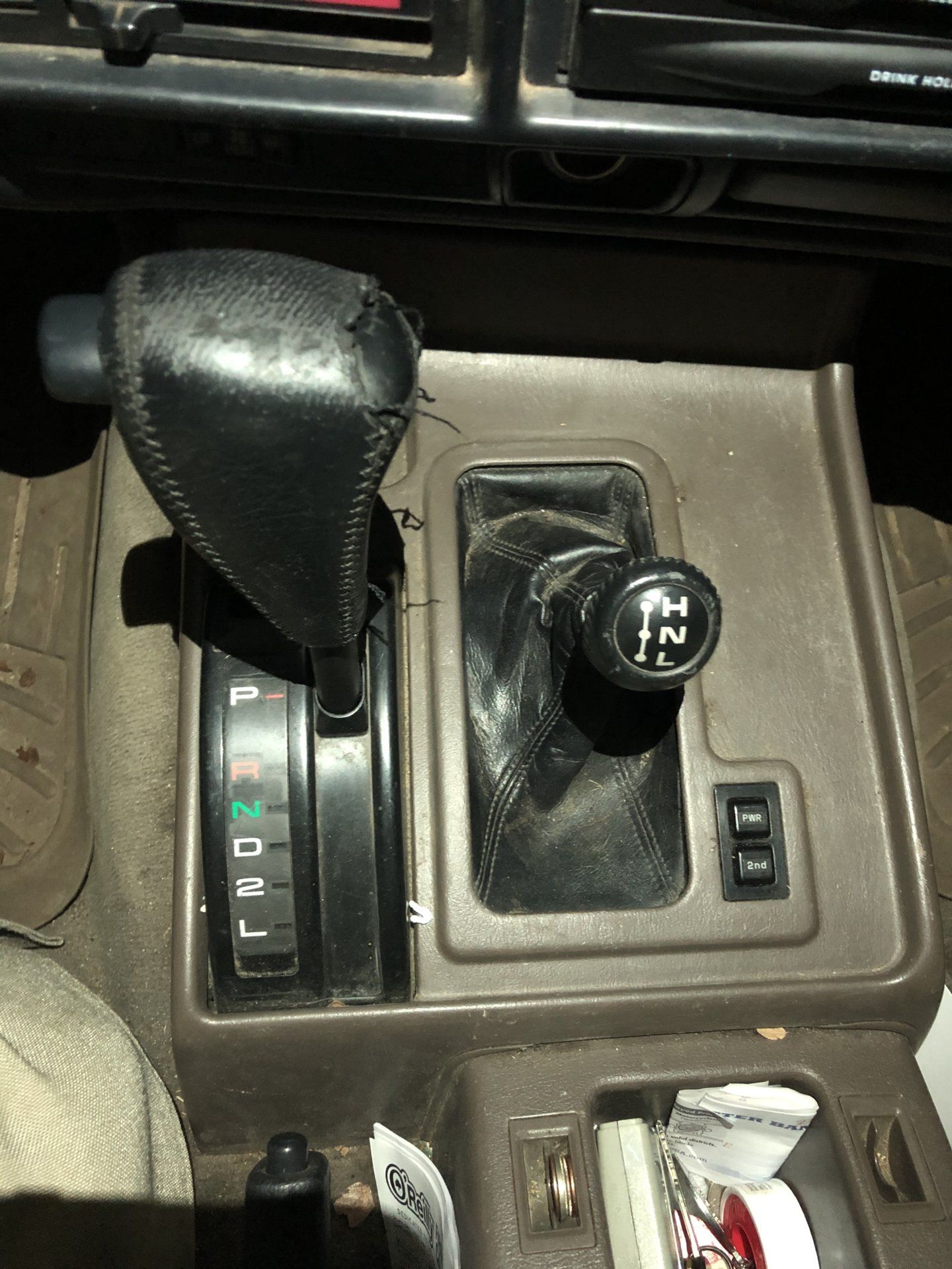

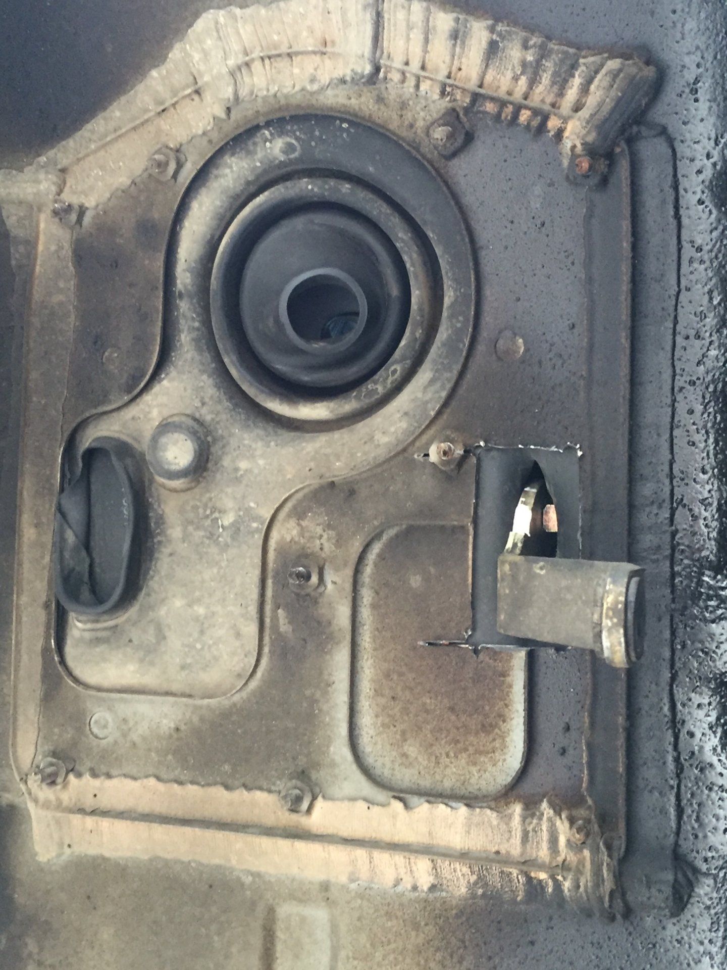

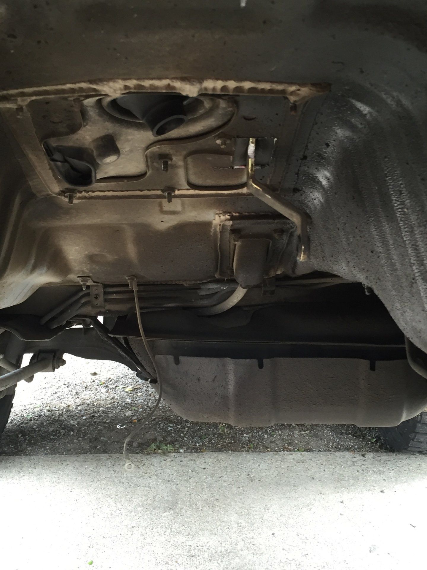

Did you use the Marks transfer case adapter? If so, how did you solve the shift lever issue? I've seen a couple of others create a stock look but had to use a shift lever from an earlier Cruiser. Did you do the stock look, if so, how?
I used the stock shifter. I modified the bracket to make it center in the shifter boot. I don’t remember exactly but I know I welded a piece of flat to the left side of the bracket and drilled new holes. I also remember doing this twice before it was centered like I wanted it. The bracket that comes with the kit moves the shifter too far to the right.

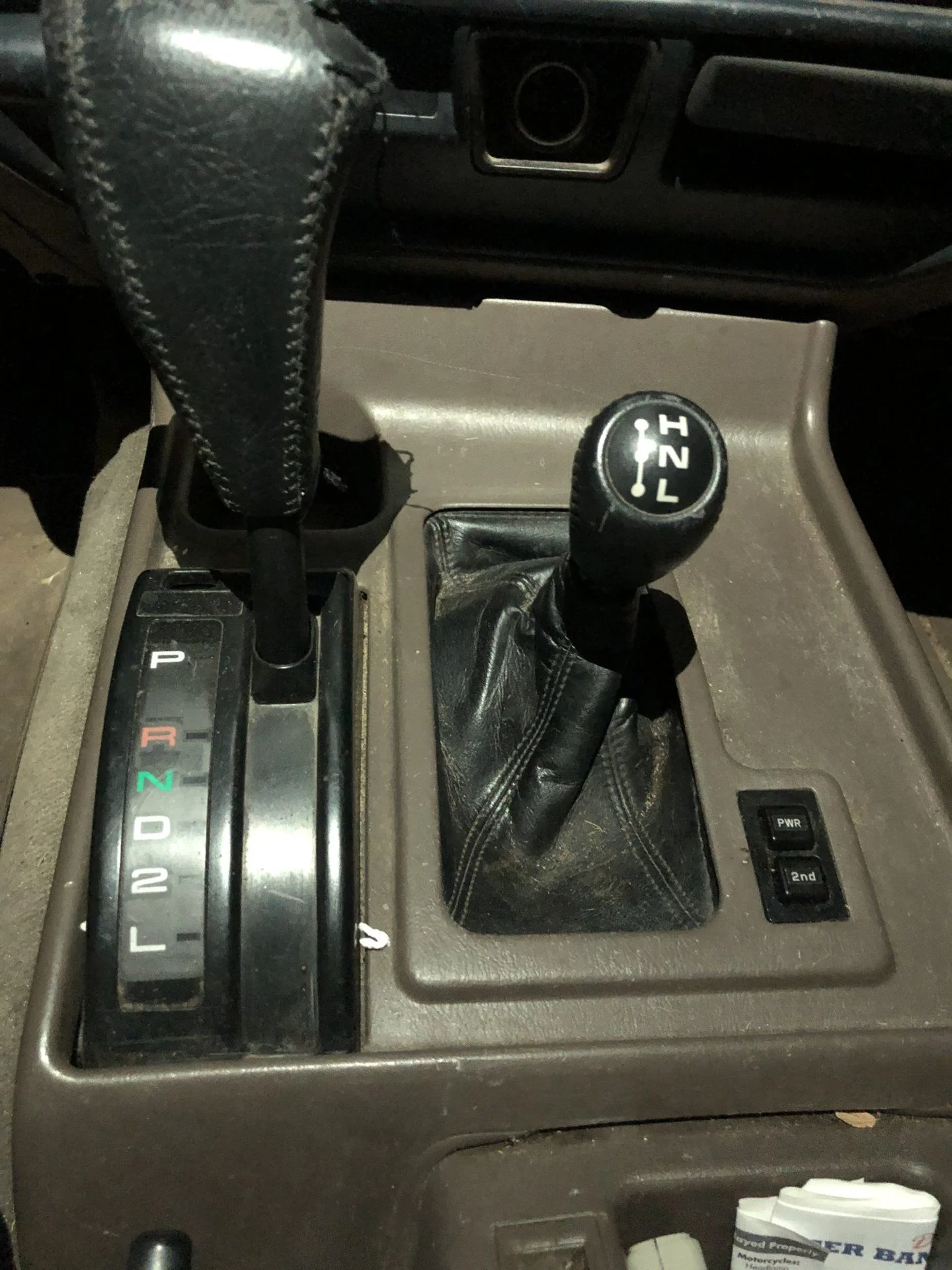

This is some pictures of the transmission shifter. I didn’t take pictures of the transfer shifter before I installed drivetrain.
