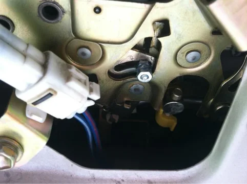

That black tab is there. That is what I figured to be the problem. The back side of it is broken off. When you lift the tailgate latch it doesn't have anything to catch on to pull the rod to release the gate. Going to try rigging it with a small machine screw, washers and nut. I think it will work. :)
I fixed it using a 4-40 x 3/4" machine screw. I tighten one nut all the way to the head. Then pushed it through where the black plastic piece was. Then I put some blue Locktite on the exposed threads and put three nuts on which covered the threads. I would've used a nylon lock nut but couldn't find one that small. This gives the latch something to "push". I didn't tighten the nuts all the way down, leaving some play. Works like a champ. I'm actually quite impressed with myself! :) I meant to take some pics but forgot until I got it installed for the 6th time. So here is a pic after its installed.
You can see the silver of the screw and nuts.
