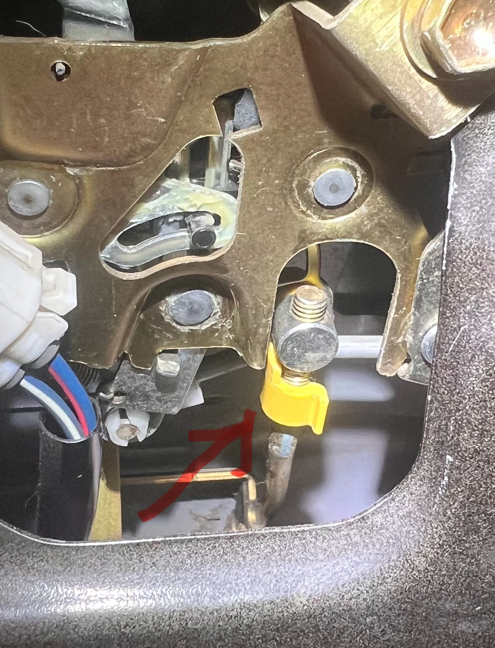

Reviving any oldy but goody. Hatch stopped working from the outside and discovered this as the culprit. I have a landscaping wire temp fix in place but doubt it will last another thirty years.

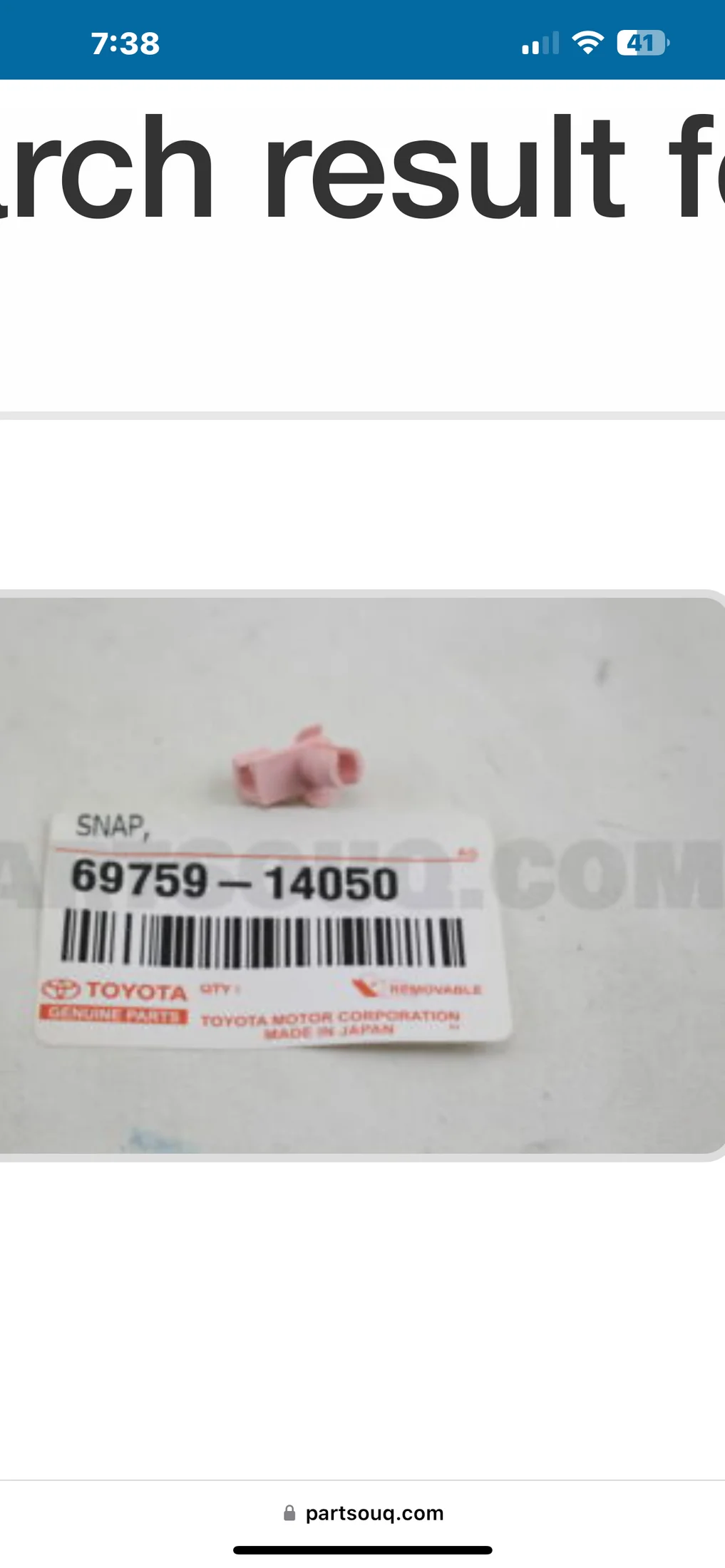

The parts diagram for the rear hatch is a bit of a hot mess and closest thing I could find was below. Doesn’t look quite right. Anyone have the actual PN?
Never mind….PN is 69293-12040 for those looking. $1.49 from the Souq.

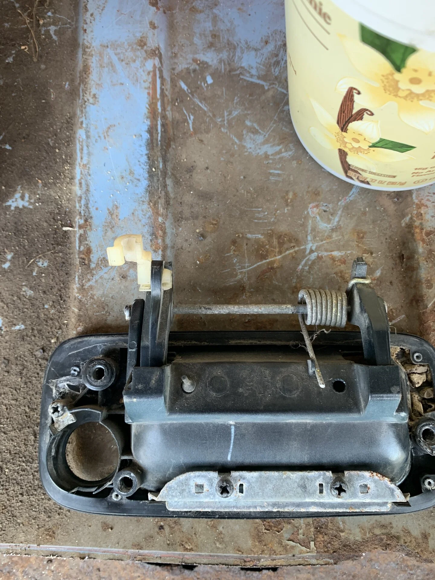

I fixed it using a 4-40 x 3/4" machine screw. I tighten one nut all the way to the head. Then pushed it through where the black plastic piece was. Then I put some blue Locktite on the exposed threads and put three nuts on which covered the threads. I would've used a nylon lock nut but couldn't find one that small. This gives the latch something to "push". I didn't tighten the nuts all the way down, leaving some play. Works like a champ. I'm actually quite impressed with myself! :) I meant to take some pics but forgot until I got it installed for the 6th time. So here is a pic after its installed.
You can see the silver of the screw and nuts.
Thanks everyone for your help and input! I really appreciate it.
Saying thank you for this masterful idea! After 2 years , I can open my tailgate from the outside. I ended up adding two nylon washers on each side of the bolt to prevent metal on metal and lubed it with some bike grease. Thanks mate!
