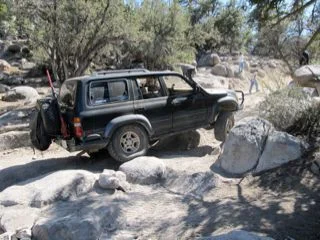

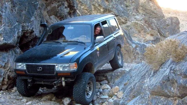

Remove by smacking into big rocks! It worked for me....
