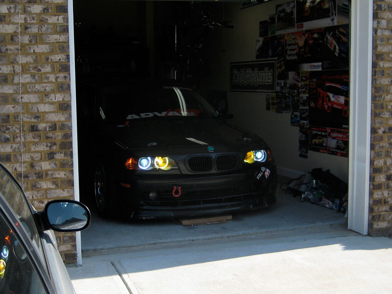

Like this:
(Best I can do until I can get to my Photoshop computer...)
