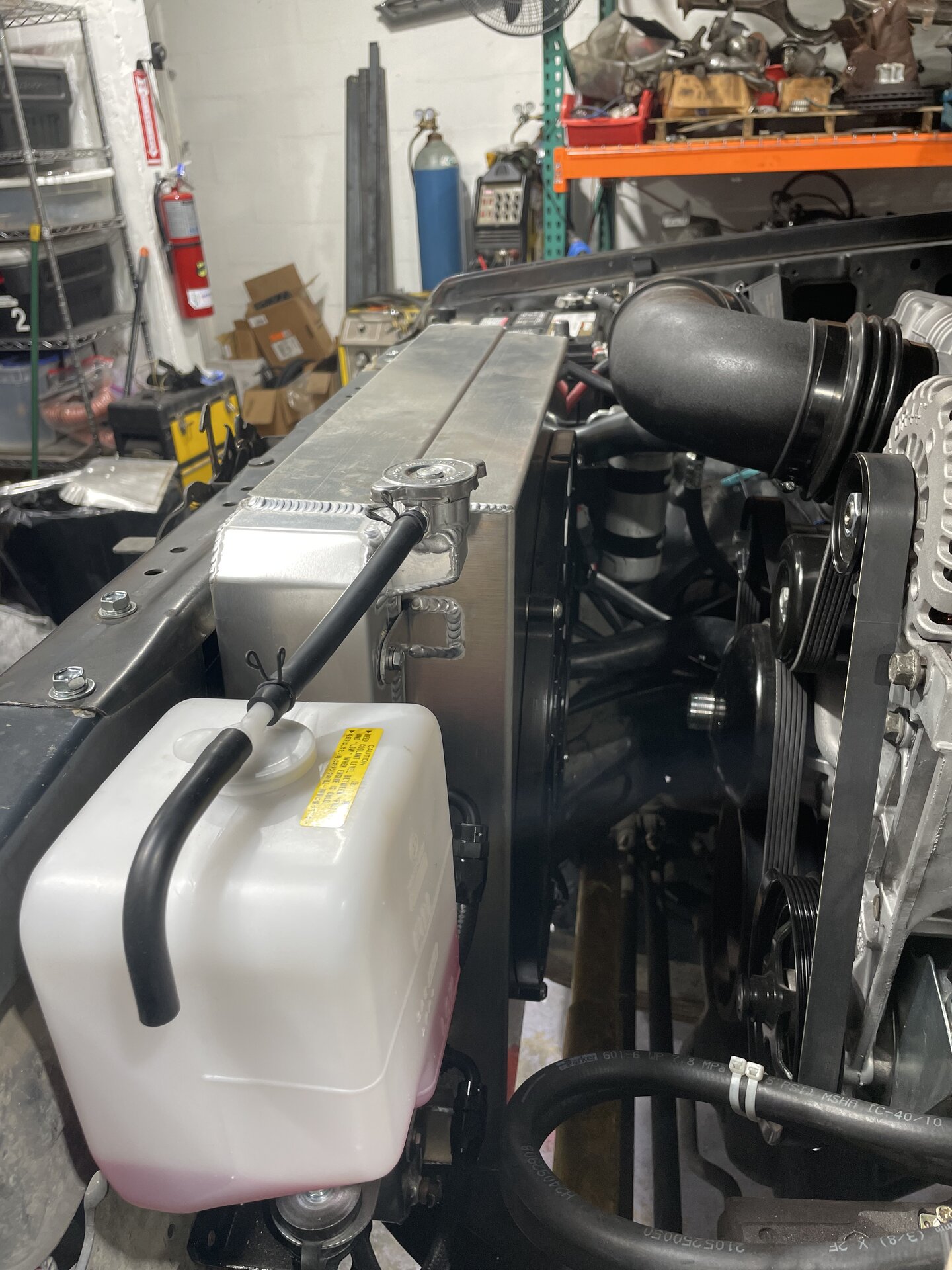

Ordered this CSF, love the look of the polished aluminum. Will post an update after installed!
That’s an 80 series radiator.
Cancel it and spent a few more bucks and get a Mosley radiator. They advertise them for LS swaps but they can make them for stock trucks too if you email them.
thank you all for the feedback! I should have waited to order, likely go with the mishimito or the Mosley.
go with Mosley. I've installed both multiple times. The Mosley rad is nicer.
