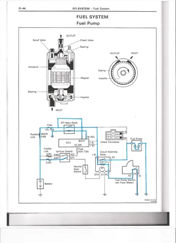

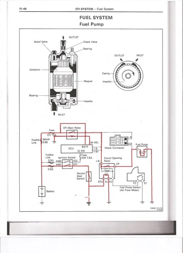

My understanding of the Fuel System circuit:
When you go to START, you put voltage through the Neutral Start Switch (which also puts power to the starter) to a coil in the Circuit Opening Relay to ground which closes the Circuit Opening Relay. This action closes a switch in the Circuit Opening Relay to start the Fuel Pump. (See solid RED lines in picture START.)
This allows the engine to start/run.
Because the engine is now running, you have air flow through the Air Flow Meter which closes a switch in it and causes another coil in the Circuit Opening Relay to keep the relay closed to keep the Fuel Pump running. (See solid BLUE line in picture RUN.)
Clear as mud,
Jerry D.
