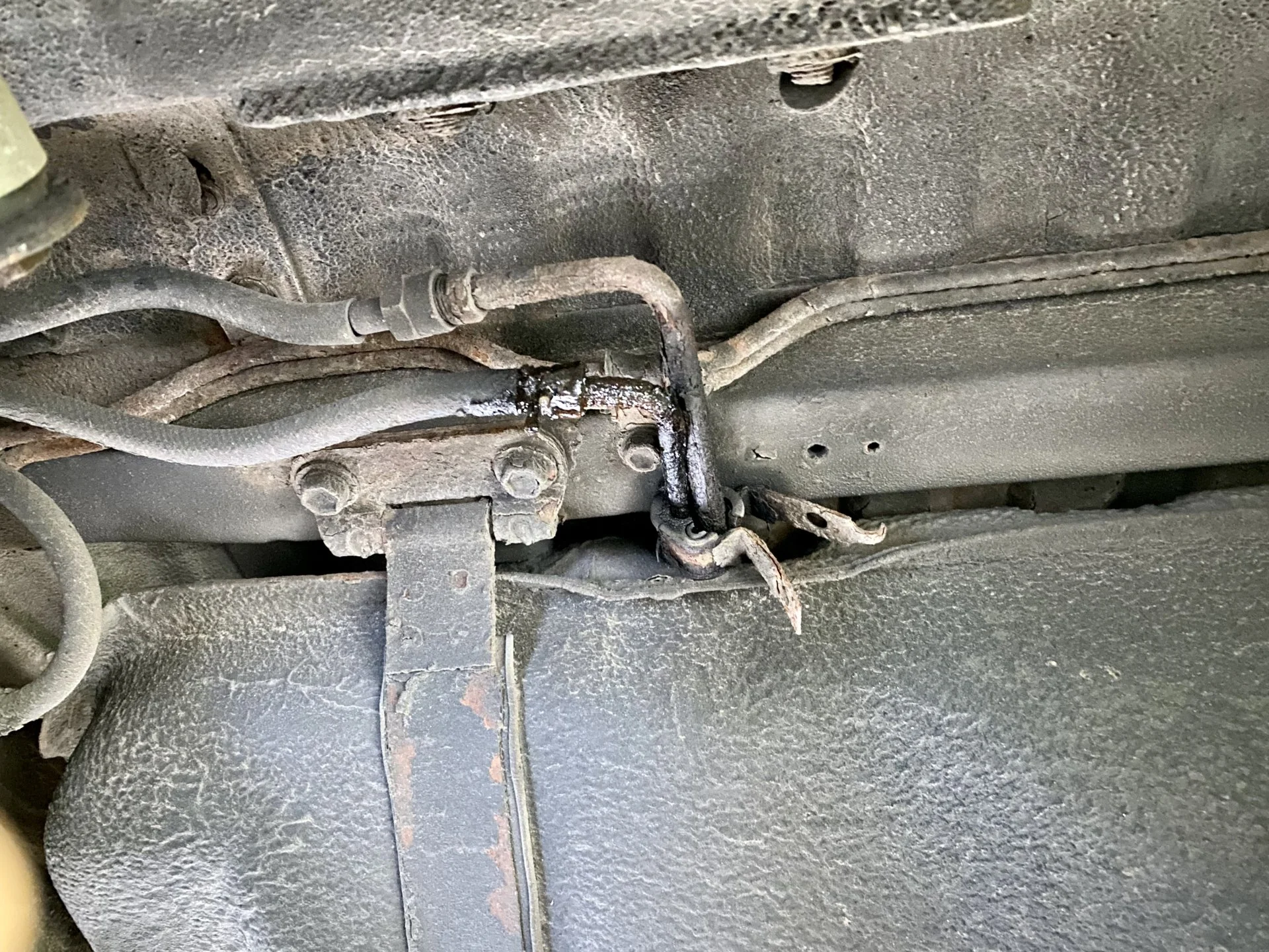

The two hard lines coming from my fuel pump carrier had rusted out resulting in leaking fuel everywhere. The only replacement I could find was a used one from cruiserparts for $425, so I decided to take a shot at repairing mine.

  1. Now find the hard lines that come off the frame rail, one is already beaded for a soft line.
    1. For the other line, mine was pretty far gone so I cut it right after the fitting and made a small flare at the end
Done!
In retrospect I could have used a rubber O ring, or some kind of seal other than the RTV, but the metal was fairly pitted and uneven, and for this application, it's not holding any liquid or pressure, just fumes, so it should be sufficient. If you're concerned about using rtv, look for fuel resistant O rings

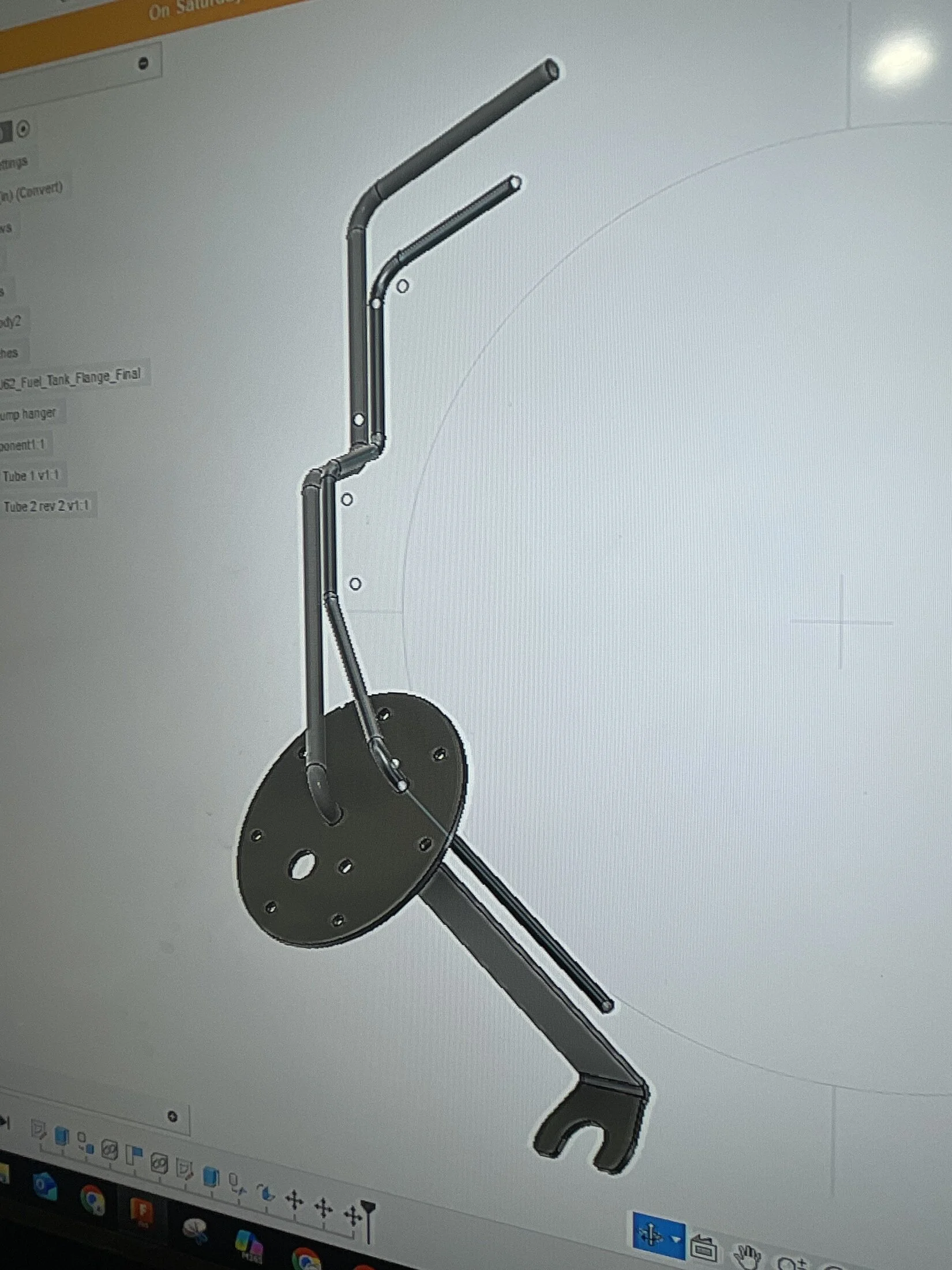

two-year bump... these fuel pump hangers are not any easier or cheaper to find and the demand is higher then ever as more and more projects get dragged out of fields to be put back the road (I have been selling our FJ62 tanks very often, and almost always the hanger is toast too) So I decided to work on adding this to the cataloque... will be 100% stainless steel, use all the OEM hardware, electrical, fittings, etc and I think we can offer and extended version for LRA tanks as well
And they will be a LOT lower cost then what some people are wanting for rusty garbage.

About damn time @cruisermatt someone stepped up for this.
That's gonna be sweet new 62 tank new toyota fuel pump new hanger new fuel line s*** everyone gonna want.
yep... we need this stuff all thie time in-house and so does everyone else. These parts are not easy or cheap (or super profitable) so I understand why no one has stomached the cost or time.
Long live the FJ62, my favorite Cruiser
guess I'll need to take my spares out of the safe, they won't be worth more than gold now, next you'll remake the 79-84 40 series pickup tube
