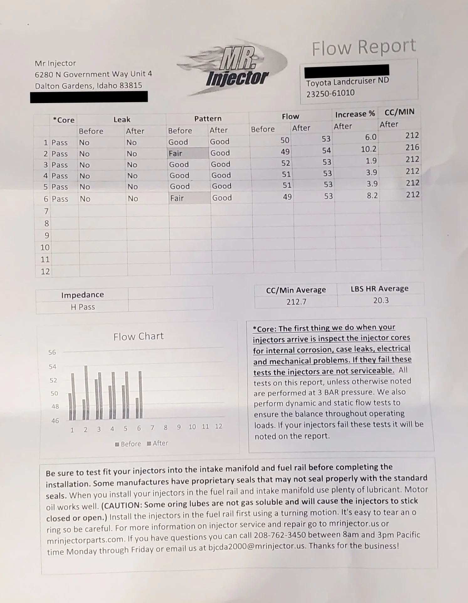

So far Im really pleased with the turnout. He does a before and after flow test, Leak test, changes the internal micro filters and all new rubber seals. He even polishes the metal on the injector to give them a nice like new look. He then uses an ultra sonic cleaner specifically made to clean fuel injectors to really get that 35+ year old crud out.

Here's the end results, My before and after flow report, all injectors are within spec!
