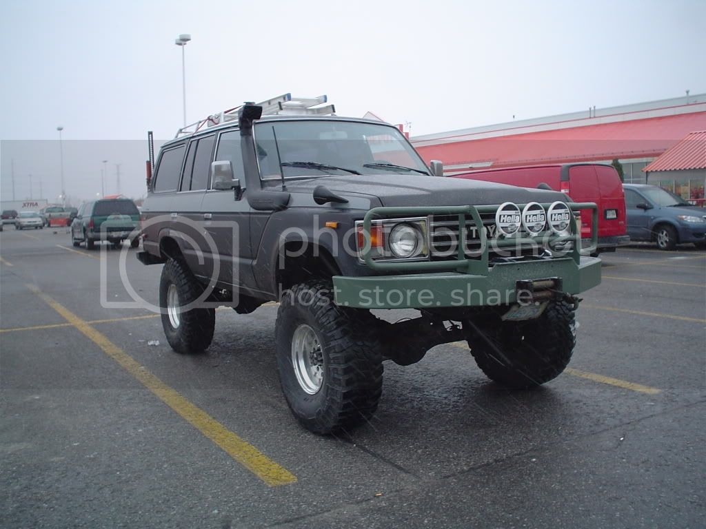

chop the top???
Ok so i have been thinking a lot about what i could do with the top. Now that everything is under the knife anyway now is the time to do it.
Here is the idea i have in my head...
What do you think???
No. The wagon has so many other uses, and with chopping it that little you're not gaining much of a bed, but losing a ton of interior room.
I miss my top ... but the bed space is worthless so bob it and keep the top
Bobbing would be such a pain. New gas tank and all.
I would not loose any real interior room. Still will have all the seats.
Plus I would be able to use it as a bed to hall crap around sticking out the back with breathing in exhaust fumes. I have already shortened the big butt from moving the rear wheel well back.
Perfect spot for the 39" spare too.
Does it look to funky?
