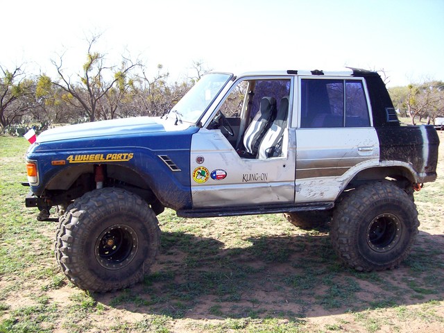

I like mine stock wheel base stock springs SOA with lots-o-trimin and a bob job
before I chopped the top
I wish I still had my top but the open air fun as long as it not cols

I almost considered rockwells but decided against it due to the room required to clear the "center chunk". A full bodied rig will have a tough time with clearing them. Did you see "fred's 40 builds a 60" build and how he did his rear panel? I'd check into that. I plan on chopping back somewhat like his or a serious hack like "Tippy R" when I set up the back of my 60.

I still have the boat tank 2.5 years and 5 roller overs later it still workin :hillbilly:
I have a jeep tank I'm lookin at puting in so I can get my cargo area back ... a nice alum fuel cell would work too .... butI'm to cheap
