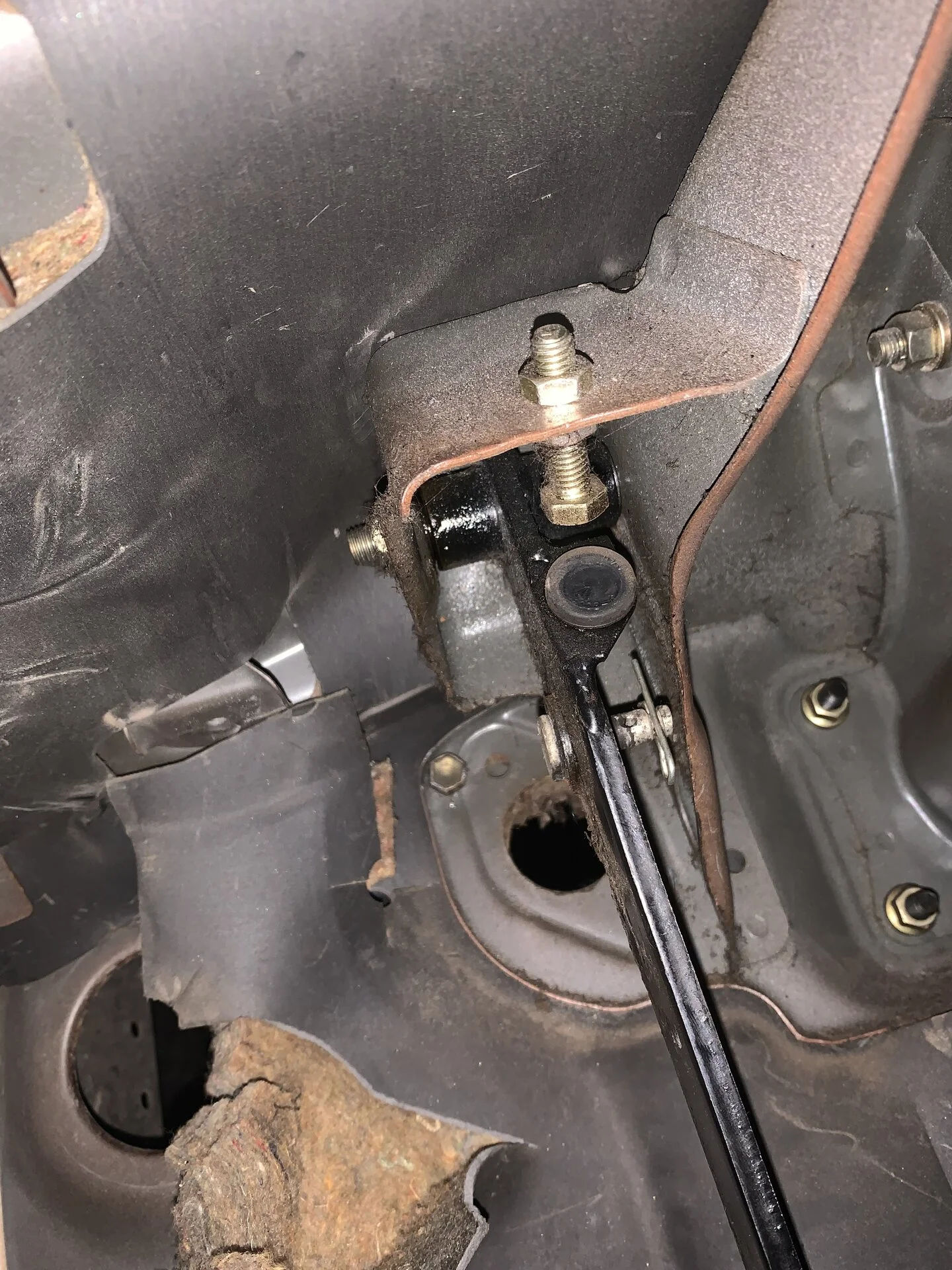

Are there any other differences other than the bolt holes for the clutch? Because I’m trying to swap them over and they don’t fit right.
Post pictures of what your issue is.

I didn't disassemble the dash. I used an early 80's bucket and matching clutch master. Drilled the spot welds off the top clutch bucket portion of the donor part and mounted it up to the FJ62 with bolts (took that idea from this thread). Yeah my clutch master bolt pattern is slightly different from the FJ62 back plate, but both bolts still catch the pedal assembly back plate... kinda the opposite orientation of what you've got going on there in your second pic... nobody will see it unless they're mashed up under the steering wheel.
If you re-used the 62 bucket why wouldn't you just get the later MC that matches the stampings on the firewall?
Yeah but that is terrible advice to give to someone who already doesn’t know what he’s doing.
Not really a good reason to do that over buying a correct $40 MC
