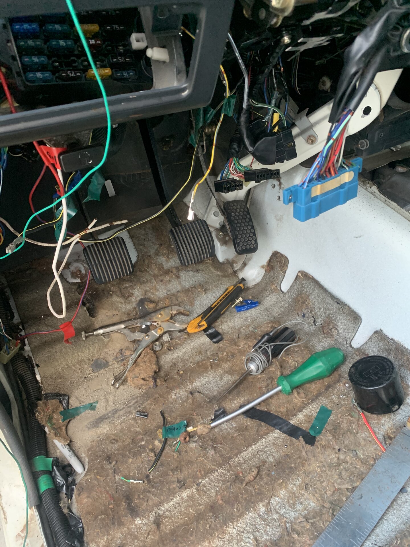

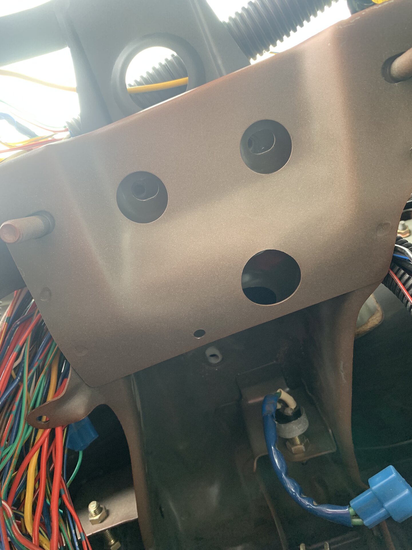

My big problem is these don’t line up and I can’t figure out why??
None of the holes line up, I thought they were the same other than the ones for the clutch master?
They do line up. It’s tricky unless you gut the whole dash. I would highly recommend doing that.
But as we are saying the clutch master hole pattern is not going to be the same.

Yes I know Crusier Matt knows his stuff, but I don’t see how it even matters, if you use a pre ‘85 just drill holes where the master needs to be.
Why drill holes when Toyota made a part to 'fit' your truck?
Because the PO of my parts truck already modified it work on ‘85 and later models.
Got it done.
Not super hard, not recommended to do by yourself, it helps a lot when a 2nd person is there to hold the steering column.
Also, an ‘84 bucket totally works, but you just have to drill a few extra holes. Totally worth it.
