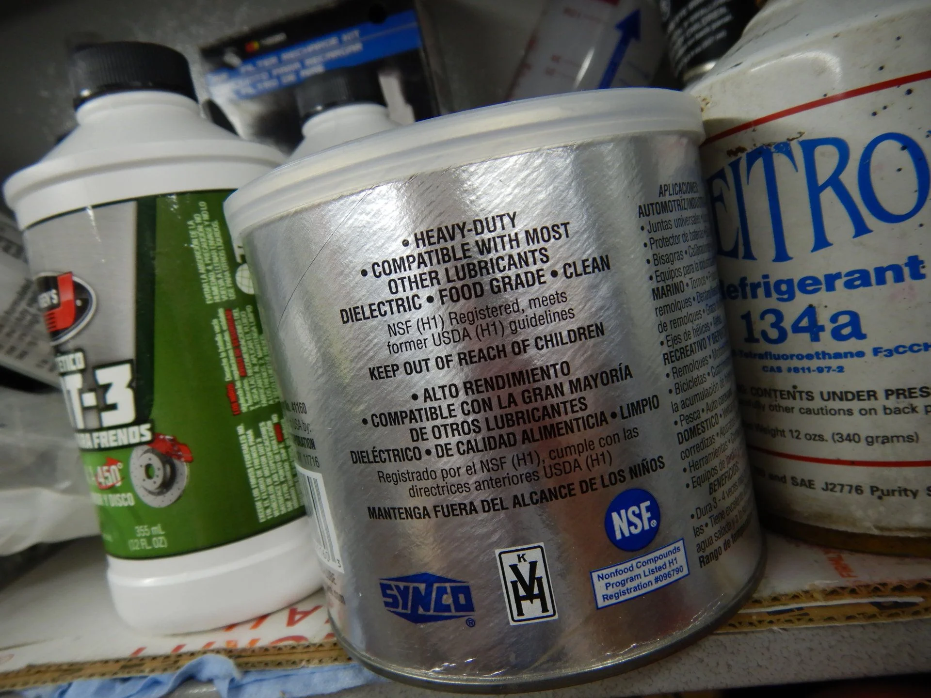

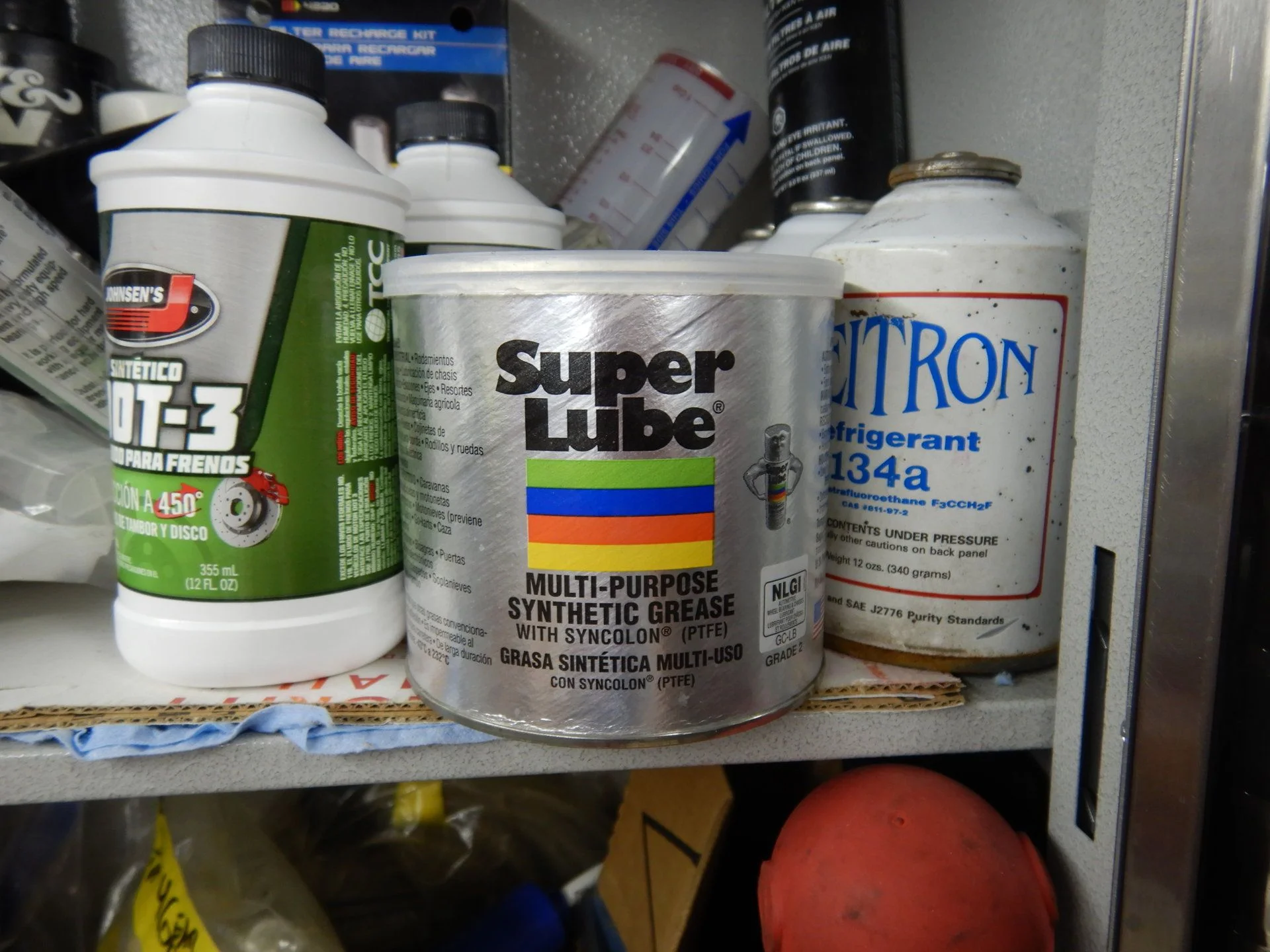

i use this alot now all over from my Locksmith work to Die-Electric job scopes , u will need a Epoxy Syringe too to Inject each terminal Bay or Port

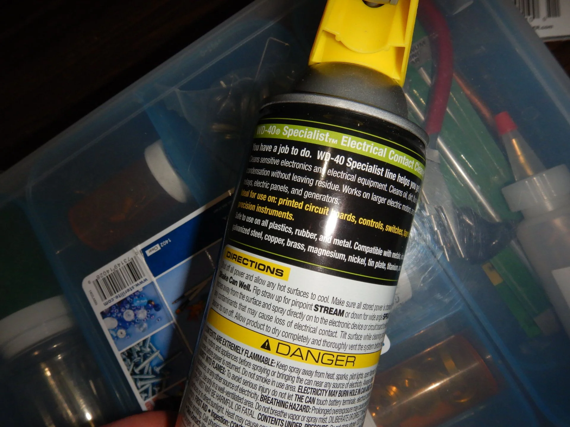

clean first with circuit board cleaner like this WD-40 i get from Home-Depot

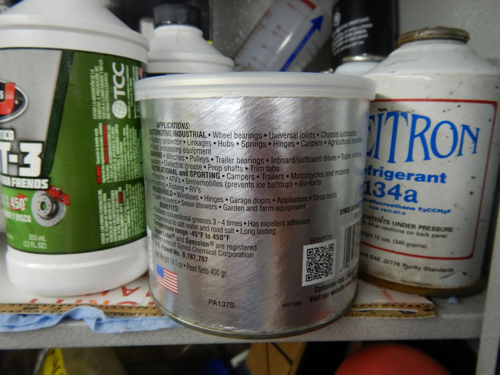

just clean it out & Re-Lube as Prescribed above , and you will be fine , I have used this product super lube on and in the OBDI service
port many times with good success and ZERO issues of any kind , i got on web site years ago , and talk more about the DIE Electric functions
i re-assemble All my Pull switches Now with it too , using a Syringe
its literately My Secret Sauce :)

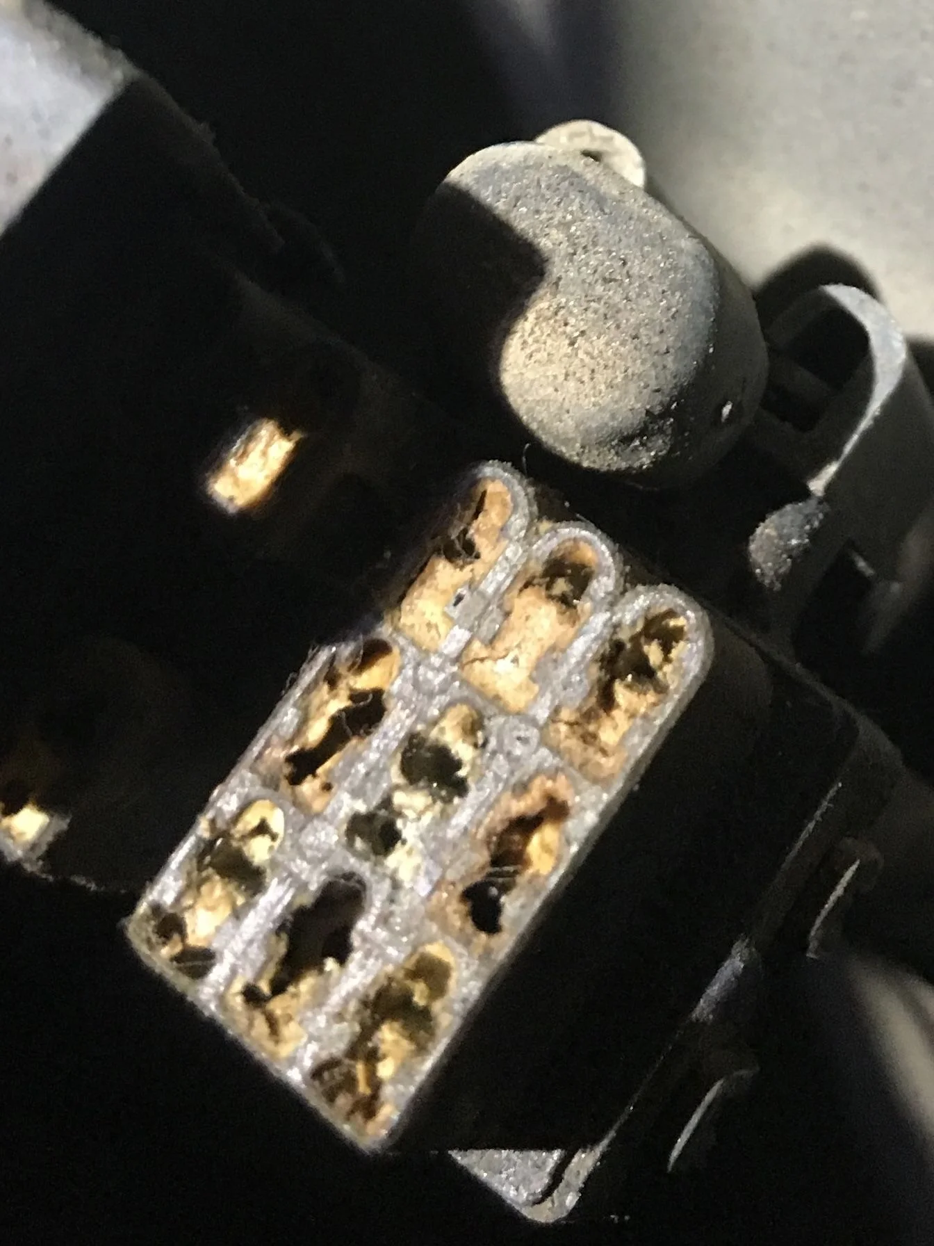

Thanks for the tips on this thread. I’ve got some OBD corrosion I’m cleaning up. But, when popping off the cover to the box, mine cracked and now won’t stay put. Any ideas on sourcing a replacement? I’ve searched MUD and online and can’t seem to find an OEM replacement for the OBD/diagnostics box cover.
As an alternative, could I just cover up the port with electrical tape?
Thanks for any suggestions.
maybe use tape or a zip tie to hold the lid in place?
