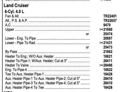

Gates catalog.

Fj62 (3fe) rear heater bypass: I used 3 of the Gates 28466 hoses to do it, which you can see all 3 here, cut as needed. If you're still using the rear heater then you'll need 2 of those and you'll probably need to google search the images for the other heater hoses in the graphic above since it's not crystal clear (to me, anyway).

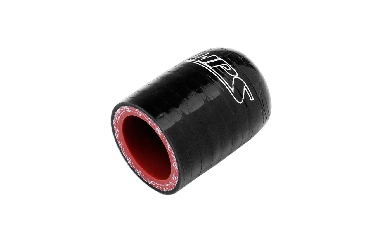

[edit 2-2-25] to bypass the rear heater you'll also need to cap one of the ports on the heater rail, seen in the above photo middle- right. That Dorman cap in the pic was a temporary solution, a better part is: HPS 16mm (5/8") high temp silicone bypass cap. <Amazon Link>

I bypassed my rear heater and used 3 of the Gates 28466 hoses to do it, which you can see all 3 here, cut as needed. If you're still using the rear heater then you'll need 2 of those and you'll probably need to google search the images for the other heater hoses in the graphic above since it's not crystal clear (to me, anyway).

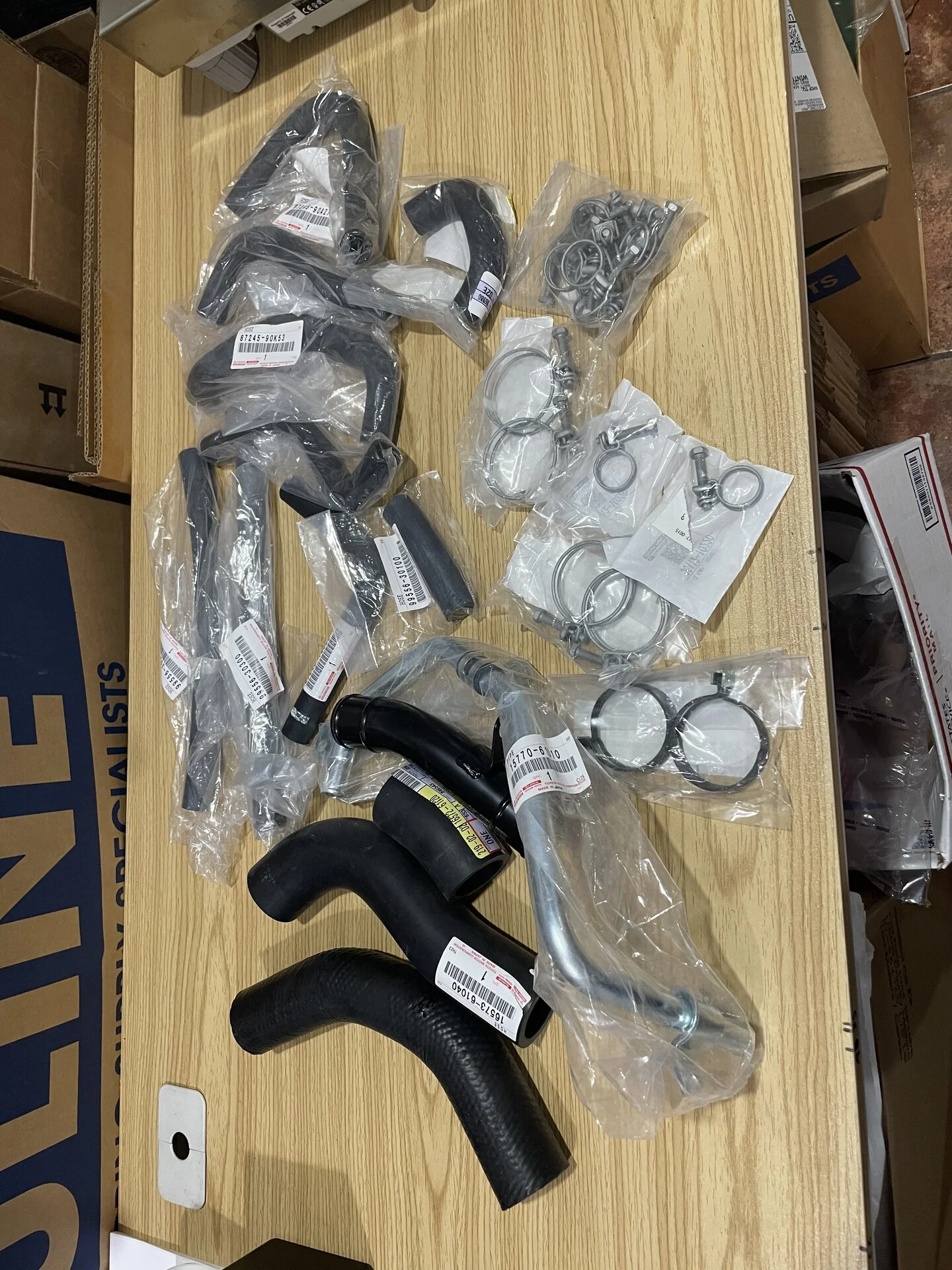

I do, just haven’t got to getting it on the website yet. There are one or two that are NLA though.
Do it! I ordered every house I could get through partsouq but there were a few not available... would love to compare what you put together and see what I'm missing!!
I don't have anything that is NLA, however I do plan on including substitutions we've found working on 62's here in the shop.. I think we work on 62's more then any other Cruiser.
That was going to be my next question 😂
I assume from your picture that you're compiling a full coolant hose list/set and not just those necessary for the rear heater?
At this point that is the plan yes. Maybe if my parts/shipping department grows I will have time to break things down to smaller kits, it is hard to compete with a some of the other behemoth vendors selling individual parts so at this time the thought process is I will probably just try and stick to larger, more comprehensive kits of OEM parts and my LS swap stuff.
Works for me! Put me down for a full kit once you have substitutions figured out for the NLA hoses.
I'm very much due for an overhaul.

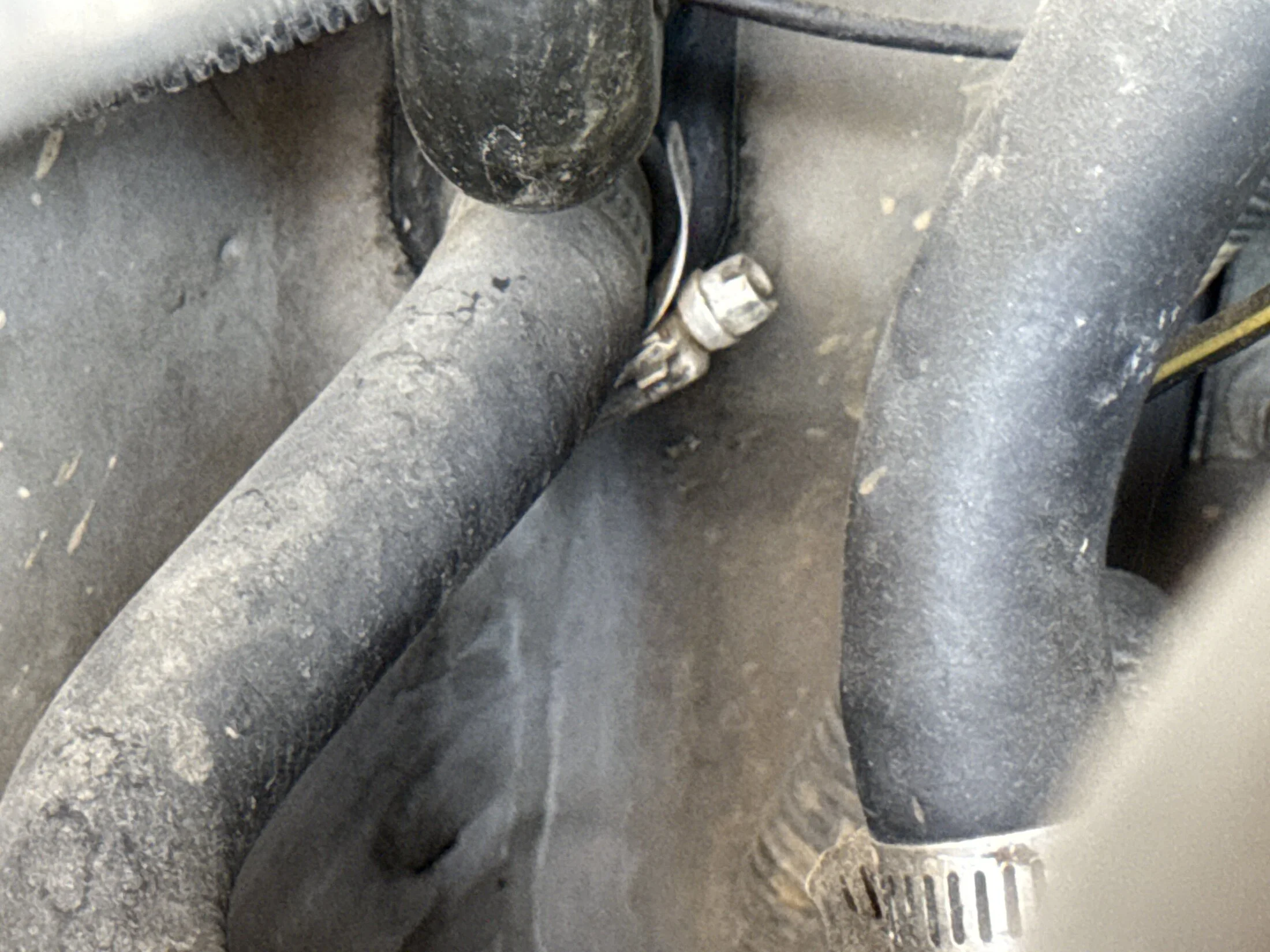

Here nearly a year later chasing a coolant leak. Think it’s coming from my firewall heater hoses.
Mine was. I thought the connections on my heater core (copper lines that are clamped on with an O-ring at the joint; done at the factory) were leaking, but after putting new hoses on my front heater with new OEM spring clamps, there hasn't been a single trace of coolant inside the cabin since. I'll use OEM spring clamps EVERYWHERE on my system after learning my lesson years ago about the worm gear clamps.

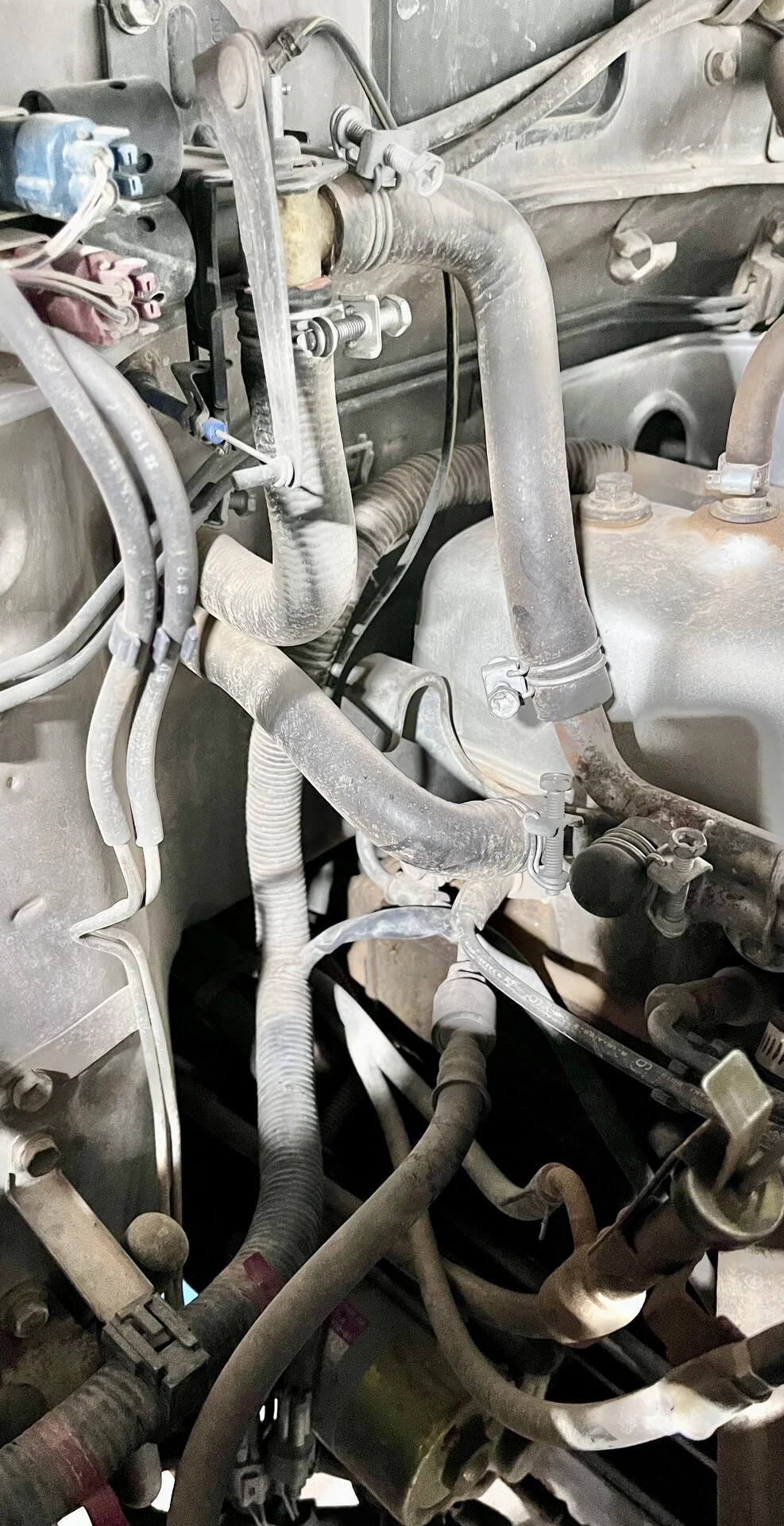

hi, i am trying to do this bypass. I am including a picture of mine (everything still stock and needs a lot more work but i want to stop the coolant leak so my garage neighbors stop asking me about it). I think i am doing the same thing you did as marked in this foto (greens will connect and red will be plugged), but not sure where the other two gates hoses you mentioned are in the by pass - unless i misunderstood and you are saying you also replaced those but they are the same as original location?
To clarify - the other two aren't required for the bypass itself, they replace the two hoses shown in your picture connecting to the heater valve.

Awesome, thank you.
