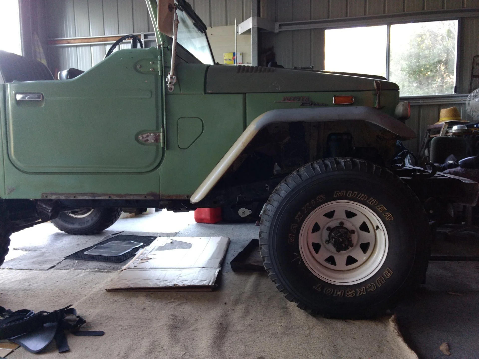

I have basically the same setup on my 45. I got rid of the stock shock towers for clearance of the steering shaft to the 80 box I use, not sure if you have that problem with a 60 box. Here's some pictures of where I put the box relative to towers. 60 front springs out boarded for a 60 axle.
