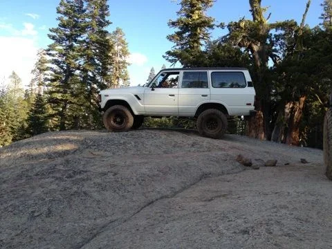

Good luck and Def post pics. Here's mine with soa, 35s, and black steelies.
