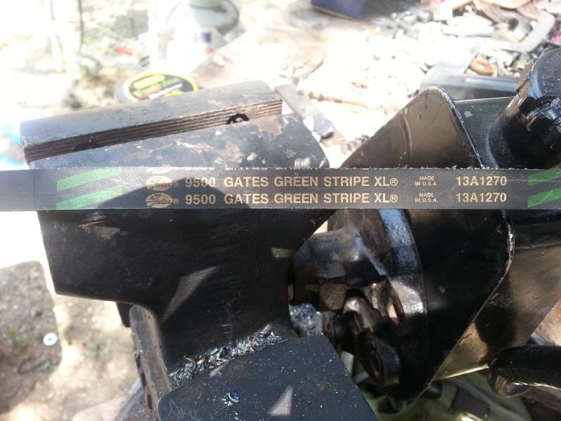

  5. Two more gates 9500 V-belt. Removed smog belt and alternator belt. Installed 1st - V-belt to alternator->water pump->crank pulley. 2nd V-belt to saginaw pump->water pump->crank pulley. The other one stays the same. They all have the same belt now.

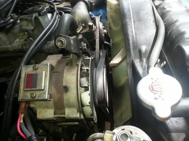

so it used the middle groove? I like it...how does it track? any wobbly bobbly? super simple, good work.
post up a picture from the side view, showing the ps pump and belt alignment.
Just a big thanks to dj for putting this thread together. Overall, not difficult, just tedious. Depending on where your bracket ends up will determine spacers needed. The jegs brkt is a must. Also cool that the new setup uses two identical length belts now. Gates B48 is used from water pump to alt to crank and belt#2 water pump, crank then ps pump.

But wait... the 2 different installs pictured above have the Jegs bracket on opposite sides of the pump.... or am I just seeing things all wrong?
