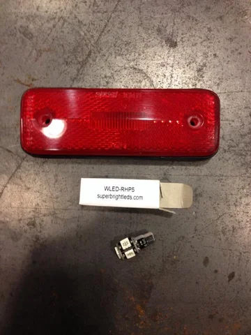

Side makers Amber:
Part #: WLED-AHP5
Side markers Red:
Part #: WLED-RHP5

Some photos to go with the words.
Side marker

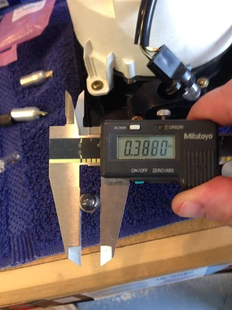

Gauge replacement didn't go so well. I ordered WLED-xLX from SuperBright LED's but they don't fit and are significantly bigger that the stock bulb. Any body else have this problem? Getting it to fit would require cutting the hole bigger, Don't want to do that. The WLED-xLX i got had a plastic sleeve at the base and removing that didn't help.
Did you all get a different bulb that I did?
