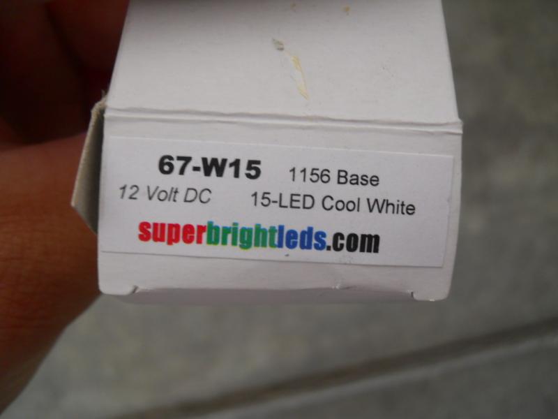

Front parking/driving came from superbrightleds.com
Part # is 67-W15
J
Part # is 67-W15

Checking in superbrightleds notice huge price gap .. I was doing the cross reference to get all bulbs from 'em .. but damn pricey ..
Checking in superbrightleds notice huge price gap .. I was doing the cross reference to get all bulbs from 'em .. but **** pricey ..
I put those "Ebay" ones in the parking spot for comparison. They are not near as bright Tap.. I think they would work ok for you though. Could always upgrade later...:meh:
Yes, I thought pricey as well but, the quality/brightness difference is staggering IMO.
