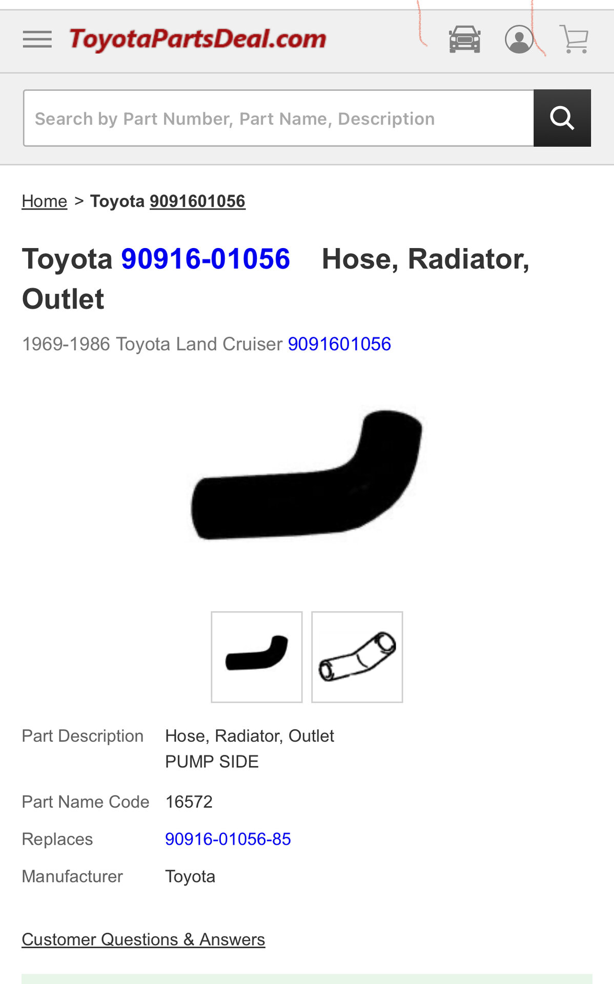

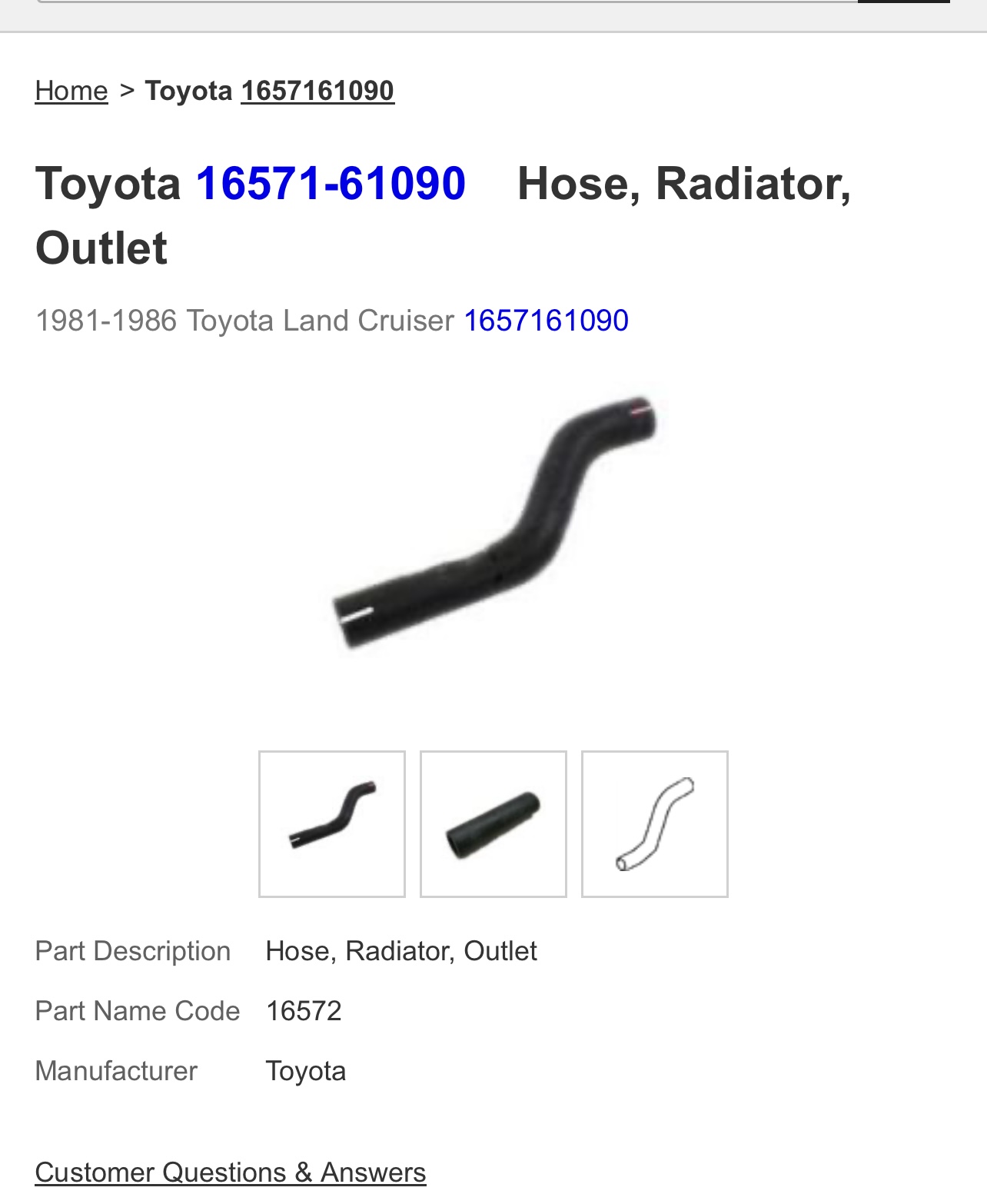

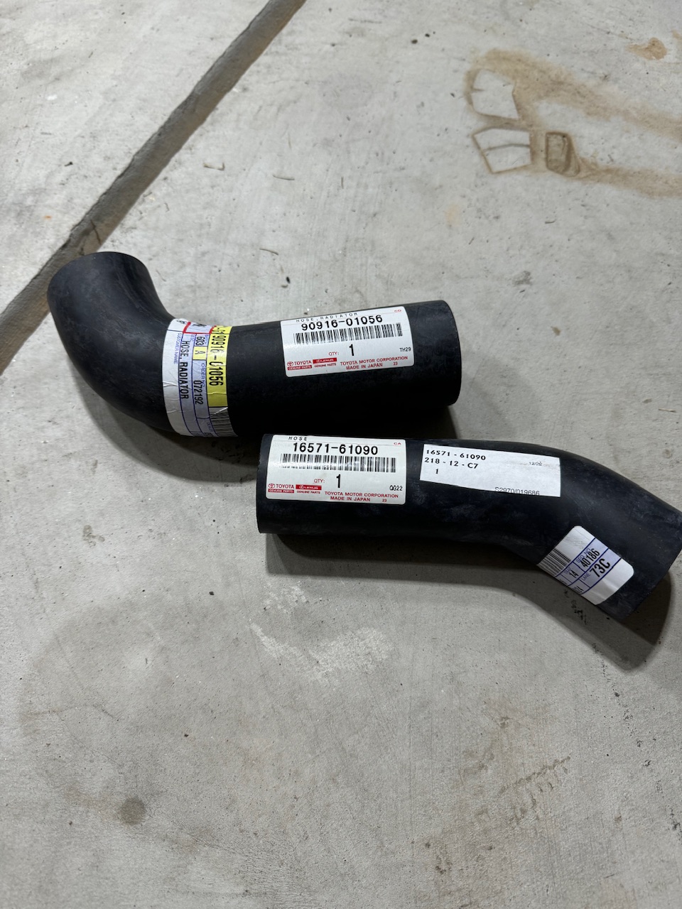

So I was drinking the other night and ordering hoses for my 85 and I ended up with these two that I have no idea where they go or why I ordered the. Part numbers reference to an 85 but 🤷‍♂️
90916-01056
16571-61099
Any idea what these are for?
Edit: i think they are for a 40
