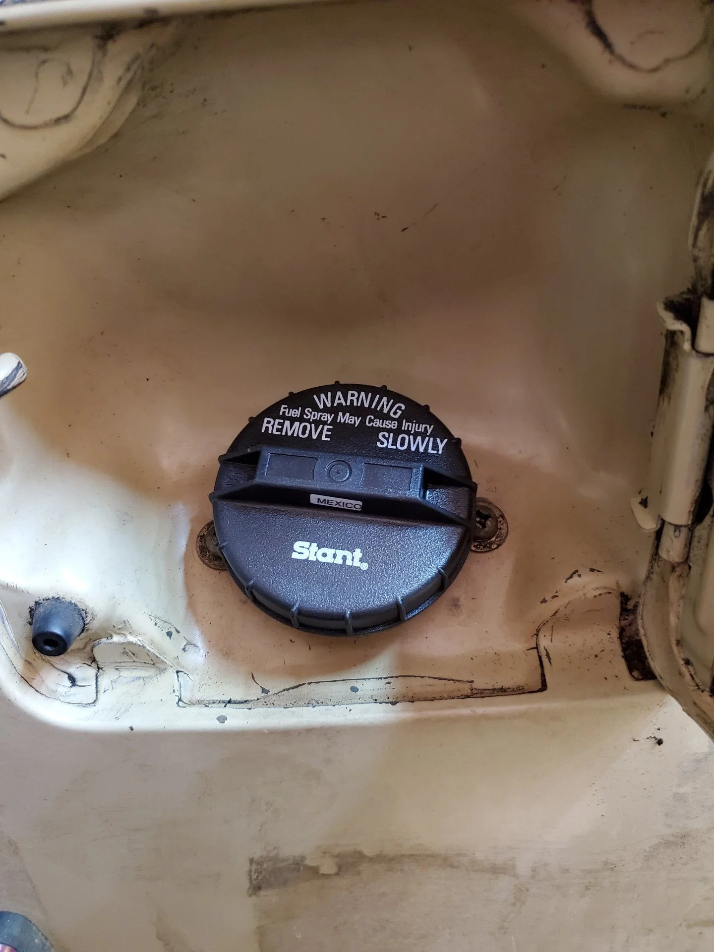

locking cap is a spring loaded seal that has been working great for me for several years now.the cap has 4 tabs 2 retract two don't whenyou put it on the non retracting tabs must be lined up with with the two notches onthe neck then you push and the other two lock' i think it would fail if it were not lined up right. that said i do have a spare one i bought used that wound up being no good also. i might do that one after i get done with my clutch i have tran dropped now. and have days of cleaning.

I just ran through smog and the shop I had been going to had a new tech... He could not get the test cap to seal for the tank test and sent me on my way. The issue is the test cap has a rod through the center to tighten on the ramped flanges where the cap has a ramped flange to match. My filler neck is a little buggered and if you twist the test cap too far it come loose. At the second smog shop I showed the tech how to not twist it to far and let the vacuum hold it, worked perfect and kept me from needing this for at least another 2 years.

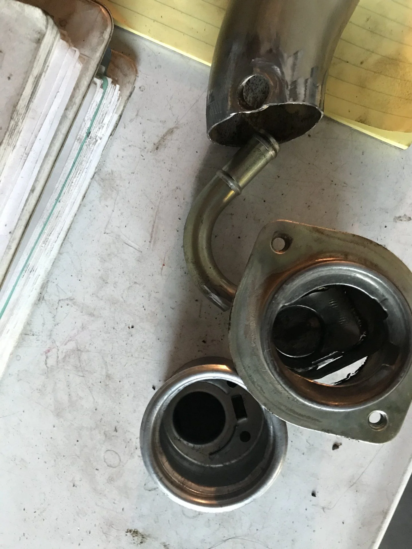

I'm doing this on my 55 and have question on how you positioned the neck in relation to the drain holes inside, if that makes sense. In your pictures the fill hole is at the bottom of the neck and the two drain back holes are at the top. Is this the correct way, I was thinking of putting the drain holes at the bottom. Not even sure if it matters, just trying get it set in my mind. Do you have any problems putting the nozzle in the fill hole, in relation to the body.

The two small holes in the filler neck are vent holes - which go on top. The baffled hole is the filler hole - which goes on bottom.
If the vent holes are below the filler flap, you will trigger the filler nozzle's overflow function every time you fill up your gas tank, which will sort of defeat the purpose of upgrading to a modern twist-on fuel filler.

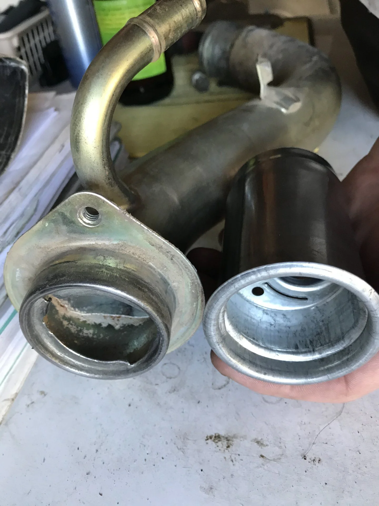

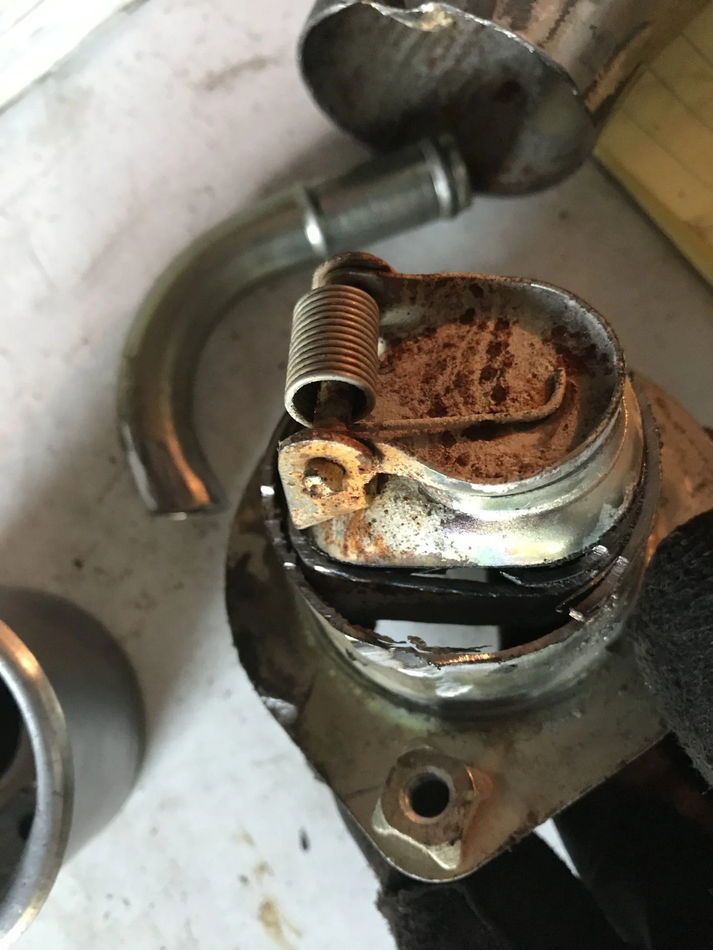

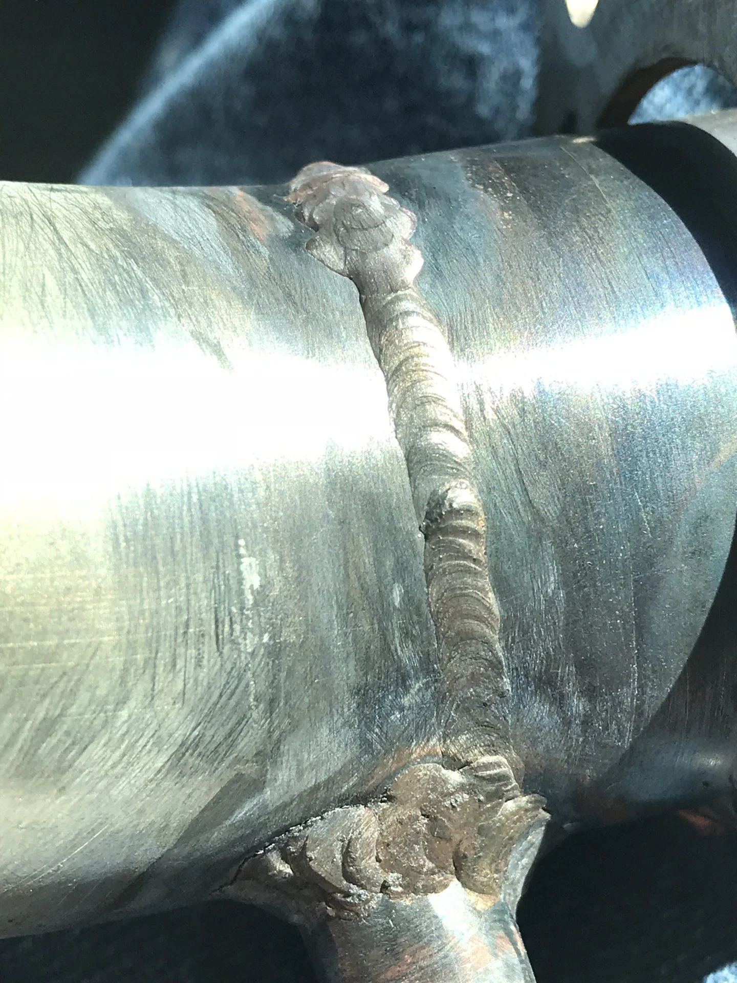

No turning back. With the large pipe cutter I borrowed there was no way to cut the filler neck off. I had to cut off the side vent hose as well. Brought it to the friendly TIG welder this morning to put it all back together. Hope he can make it work.
Ready for install.
