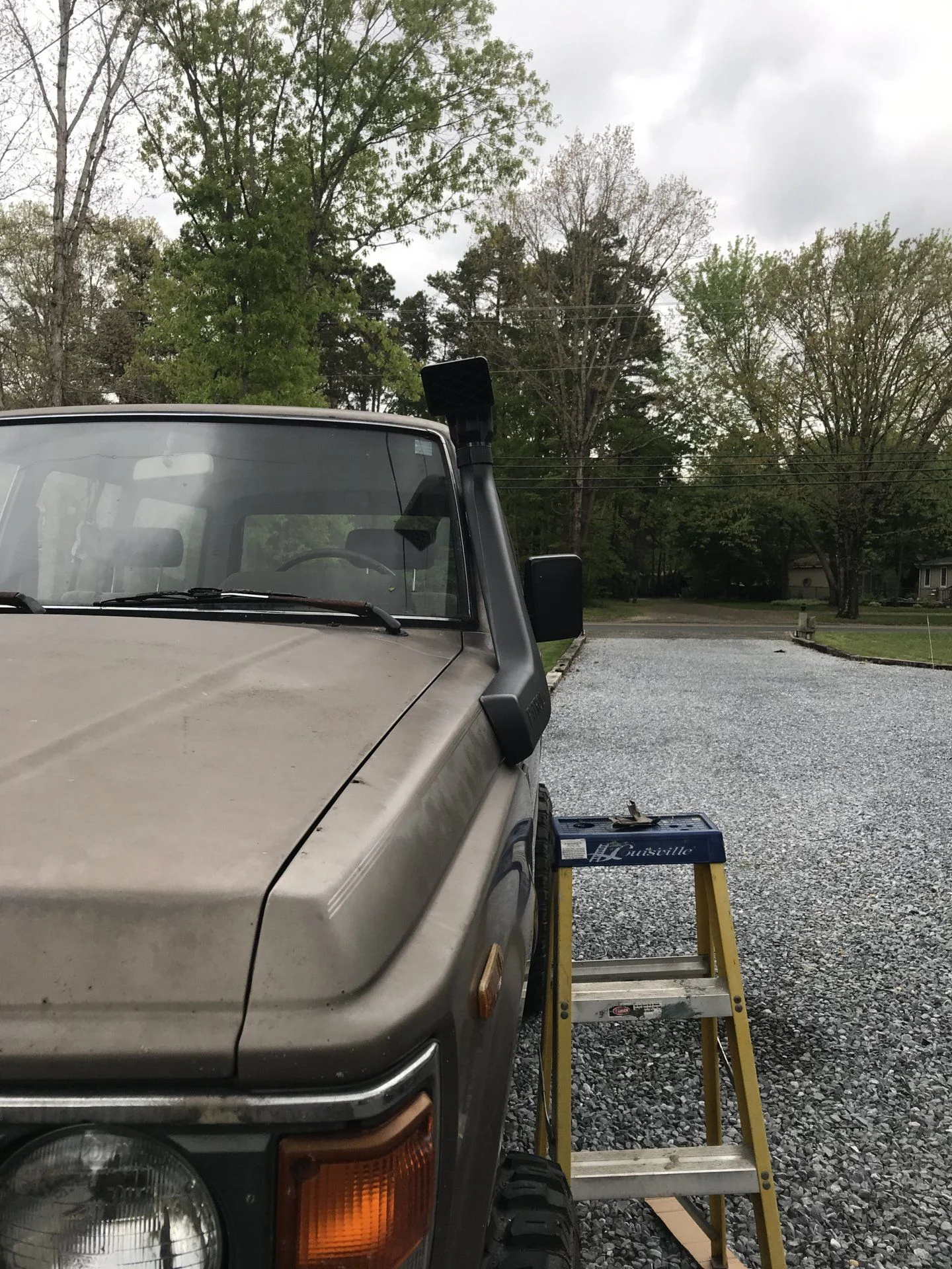

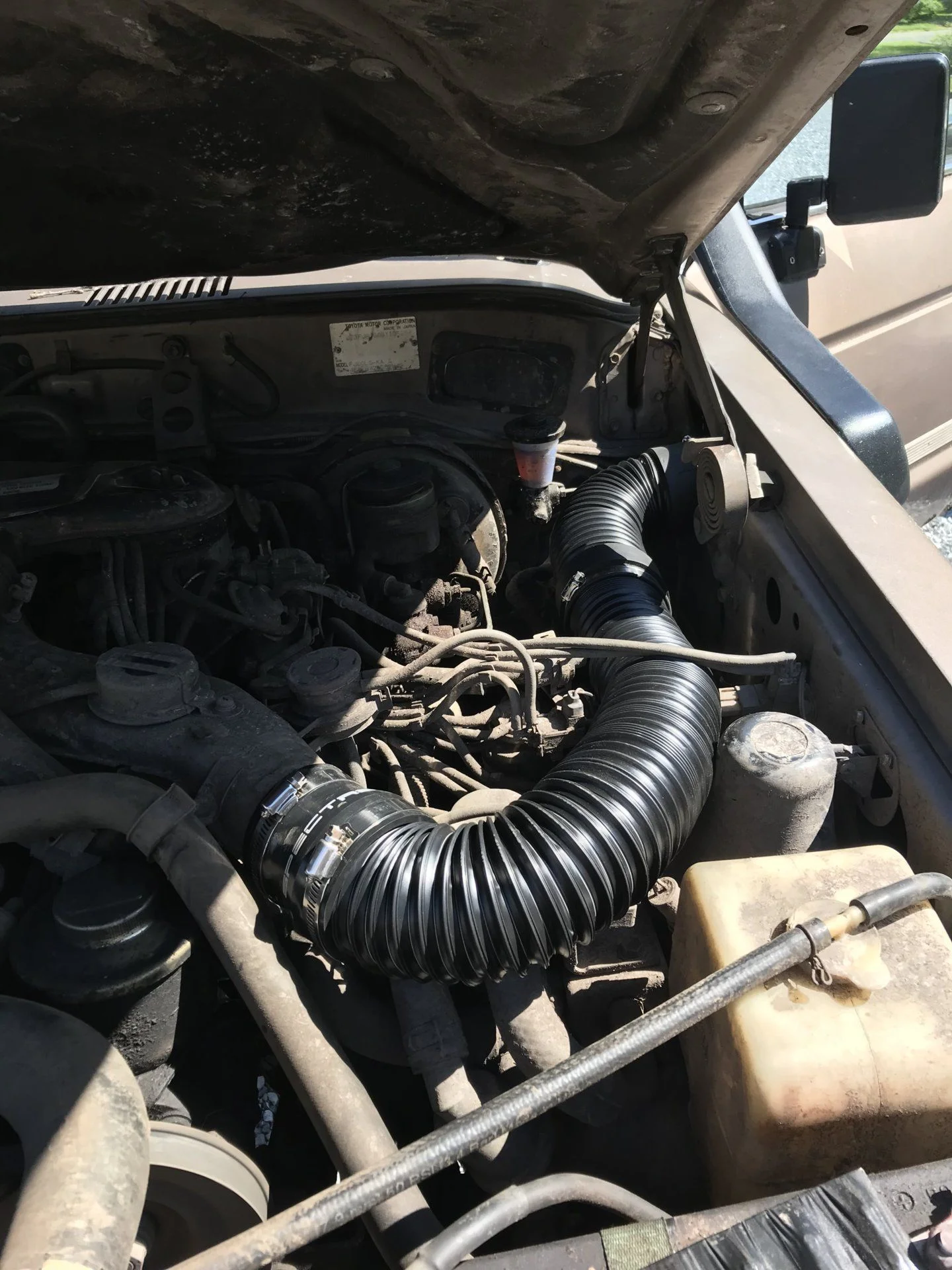

FYI ... watched a video on you tube while back about driver side snorkel for fj60... typically you would have to put on passenger side because that’s all they make for the fj60 but you would have to modify or get a different air intake set up for it to work ... $120 shipped from amazon for a Nissan patrol mq or mk ... almost perfect fit with Iittle to no modification ... much easier then passenger side snorkel
Gotta give up the carb fan to install? Kinda a no-go in my neck of the woods due to the vapor-lock possiblities. Neat looking though.

My carb blower didn’t work when I got the truck to begin with ... runs fine ... no vapor lock ... summer for us averages 90-95
