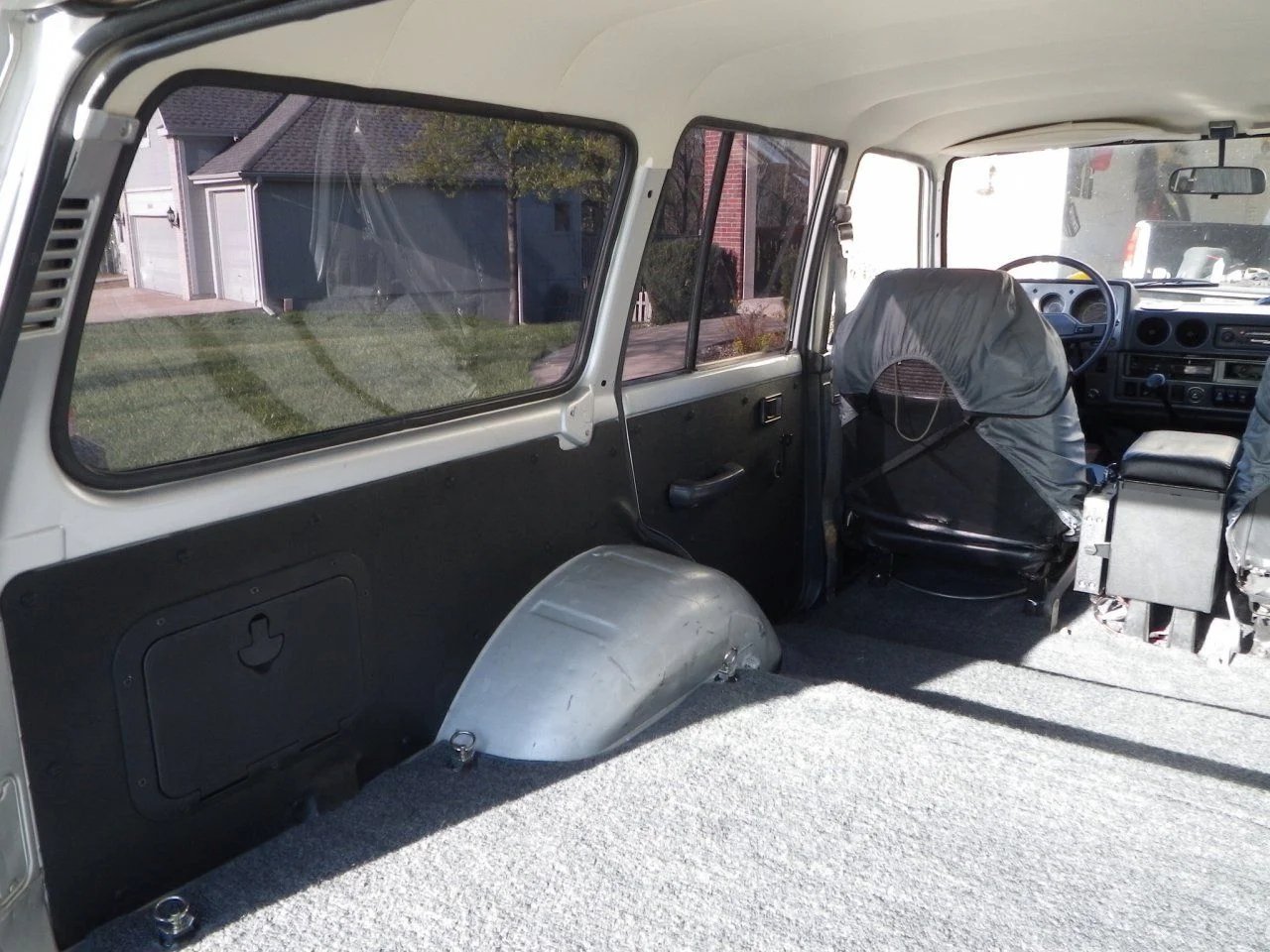

I would like grey HDPE panels that have the FJ60LV coverage, and the matching inner belt weatherstrip. Problem is the WS is NLA from toyota and amayama.
Like this panel found on a base mintruck:
I think the easiest way to suit everyone's needs will be to produce basic HDPE panels. From that point, maybe a menu of upgrades that the purchaser can arrange with the shop.
I like the panel design of the mini - clean, easy to care for, simple.

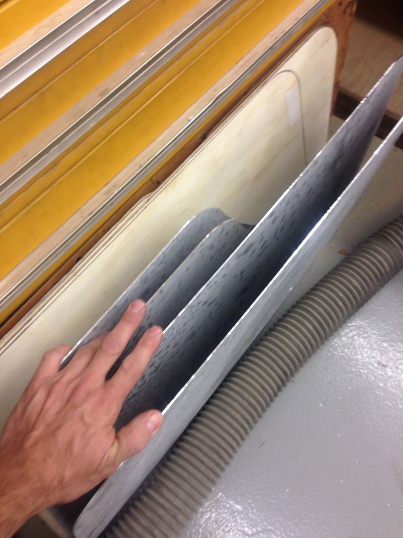

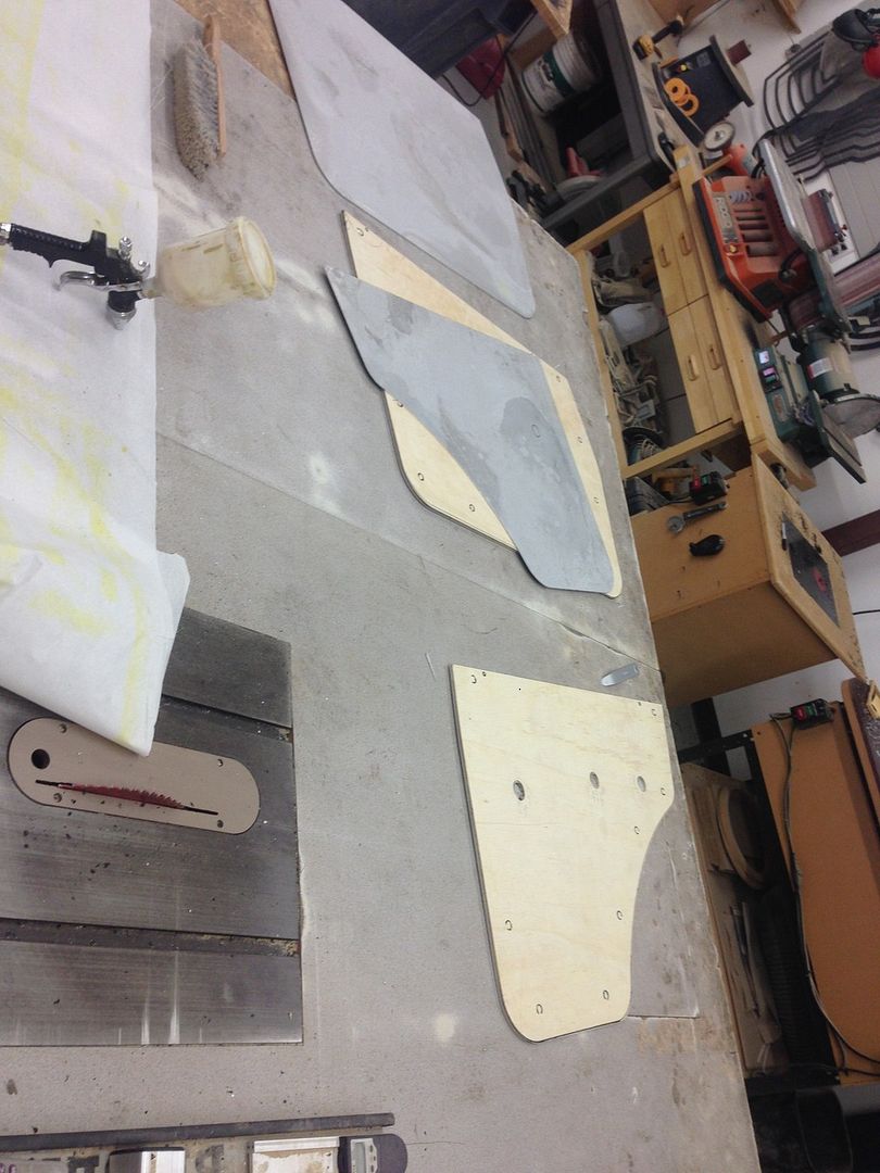

Hmm...made some progress on the cards over the weekend & late last night (Wesley is the man). Rough version could b ready in two weeks...could b 8 weeks.
