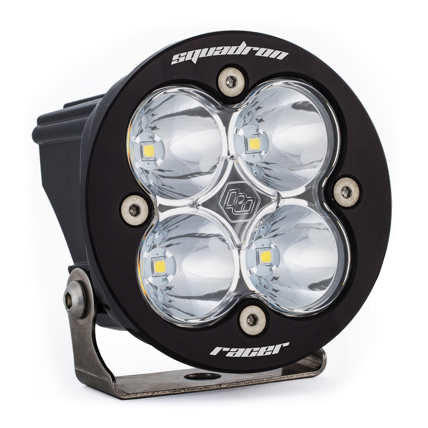

FYI that light is sold by a company called Rigid industries and is a pretty good LED light for slow speed use. I run a pair of Baja designs Squadron LED lights on my 450 woods bike for both the low and high beams....not at all road legal but i have plenty of light. A pair of squadrons with a harness will run you close to $600 where a pair of the Rigids will run about $200 iirc. I have a pair of the rigid lights as well and intend to mount them on my Kubota for better night time visibility.
Id like to mount either the Baja or the rigids . Hence the quest for a ditch light bracket to mount those on. Can’t wait to get some real lights

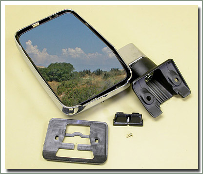

Looking at this picture of an aftermarket 62 mirror it looks like you could pull the mount bolt out that holds the mirror onto the bracket. Perhaps you could replace that bolt with a longer one and then sandwich a light mounting tab between the mirror and the base. Maybe even route your wires for the lights back through the mounting bracket and door to keep things hidden.
I have those mirrors on my 60, and have been thinking about making this kind of bracket.
I think adding weight to the mirror is a bad idea, as the door panel already flexes just from the big euro mirrors.
