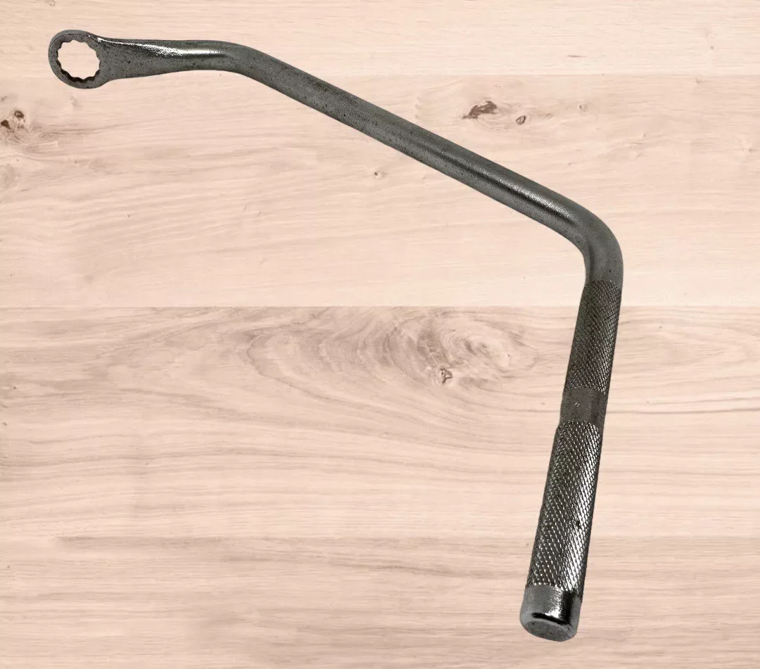

One of these 12mm Snap On dissy wrenches makes this job way easier. They're around $10 used on ebay. I put them in a vise and bend them just a little more and grind a little off the sides of the head and it's a Snap! (bad pun, yes ;)).
Just for peoples coming across this thread in the future...
