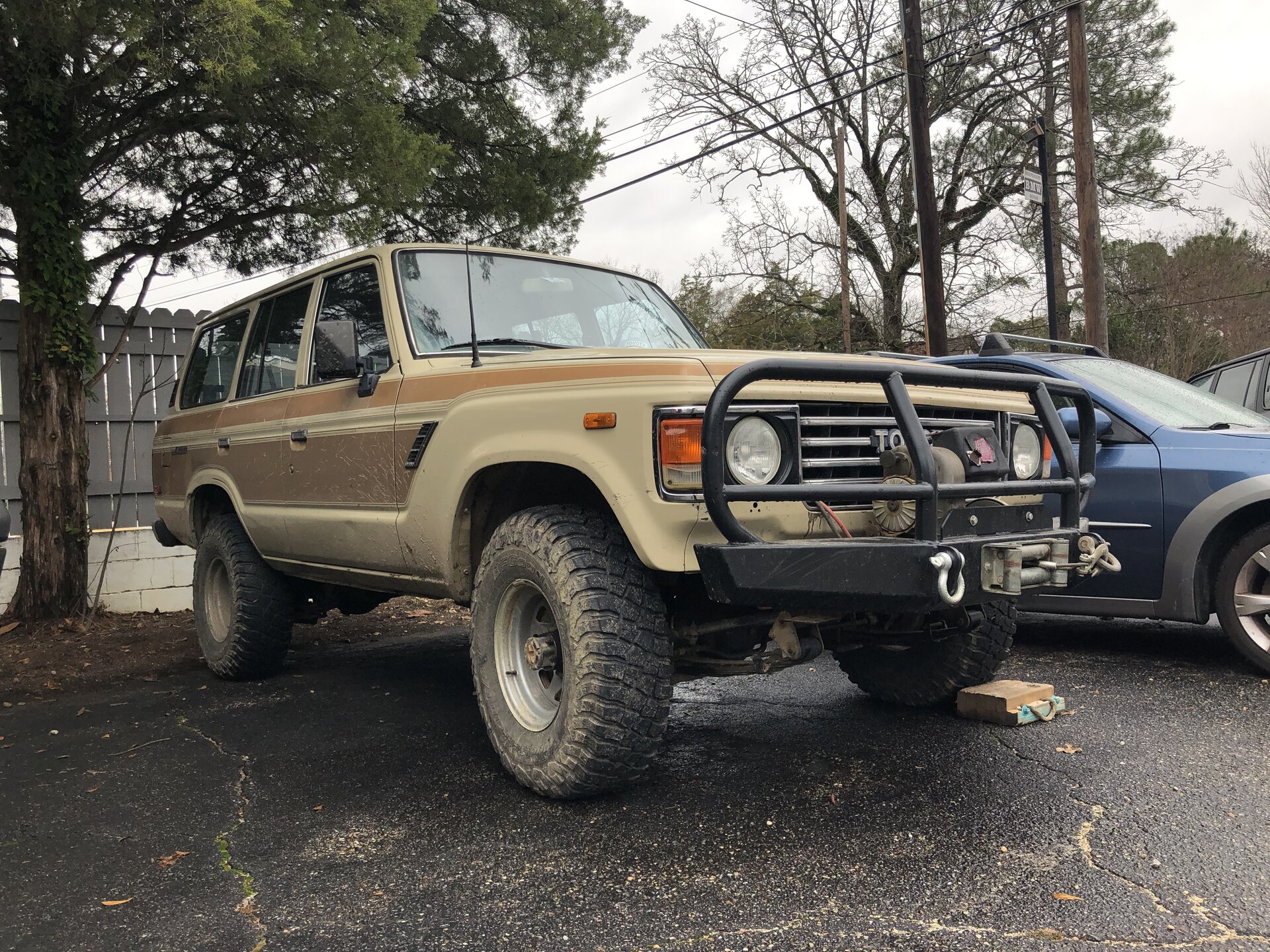

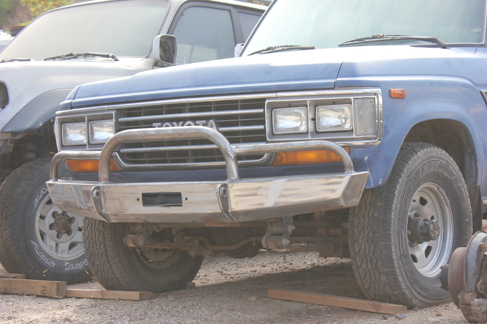

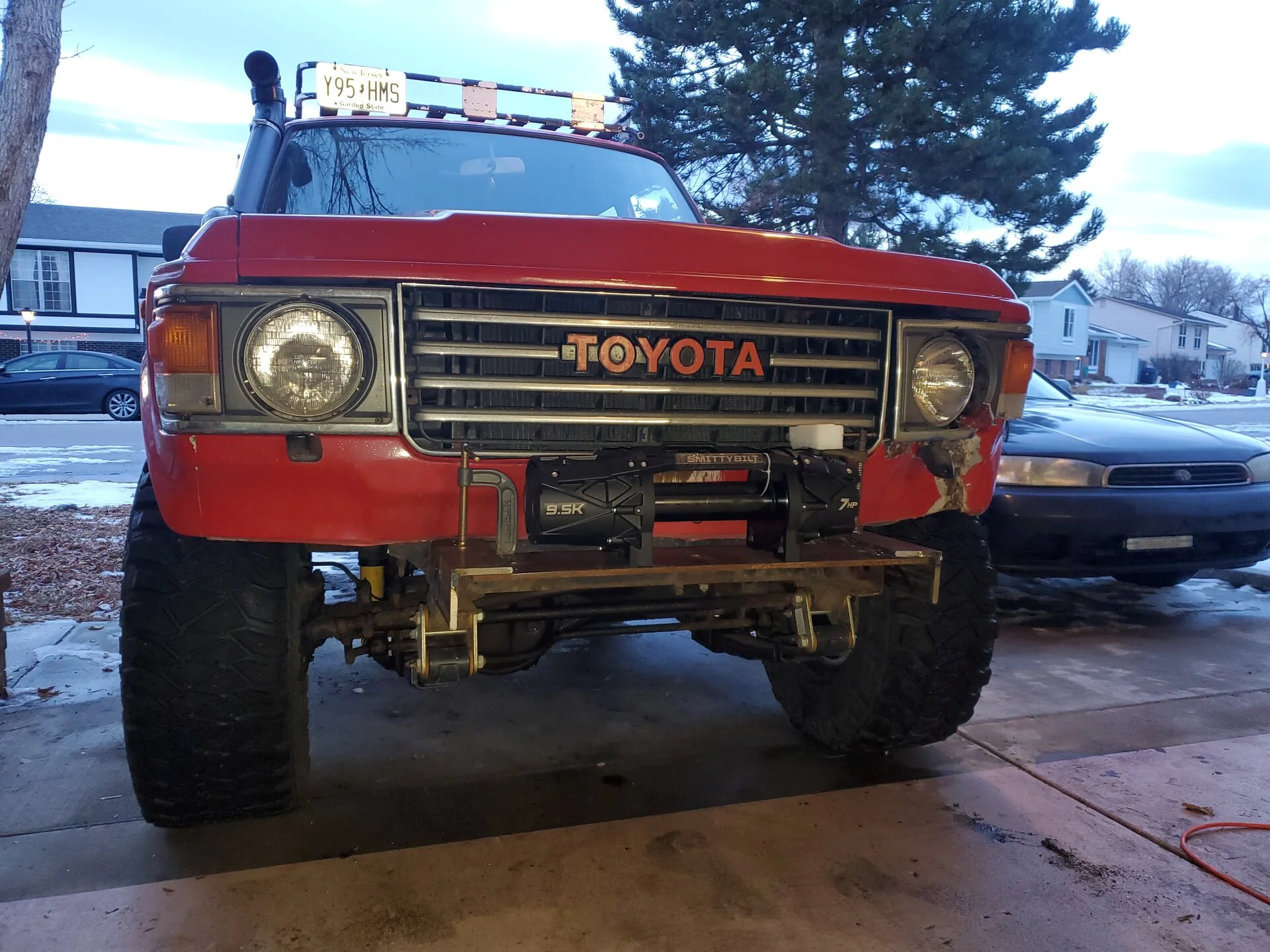

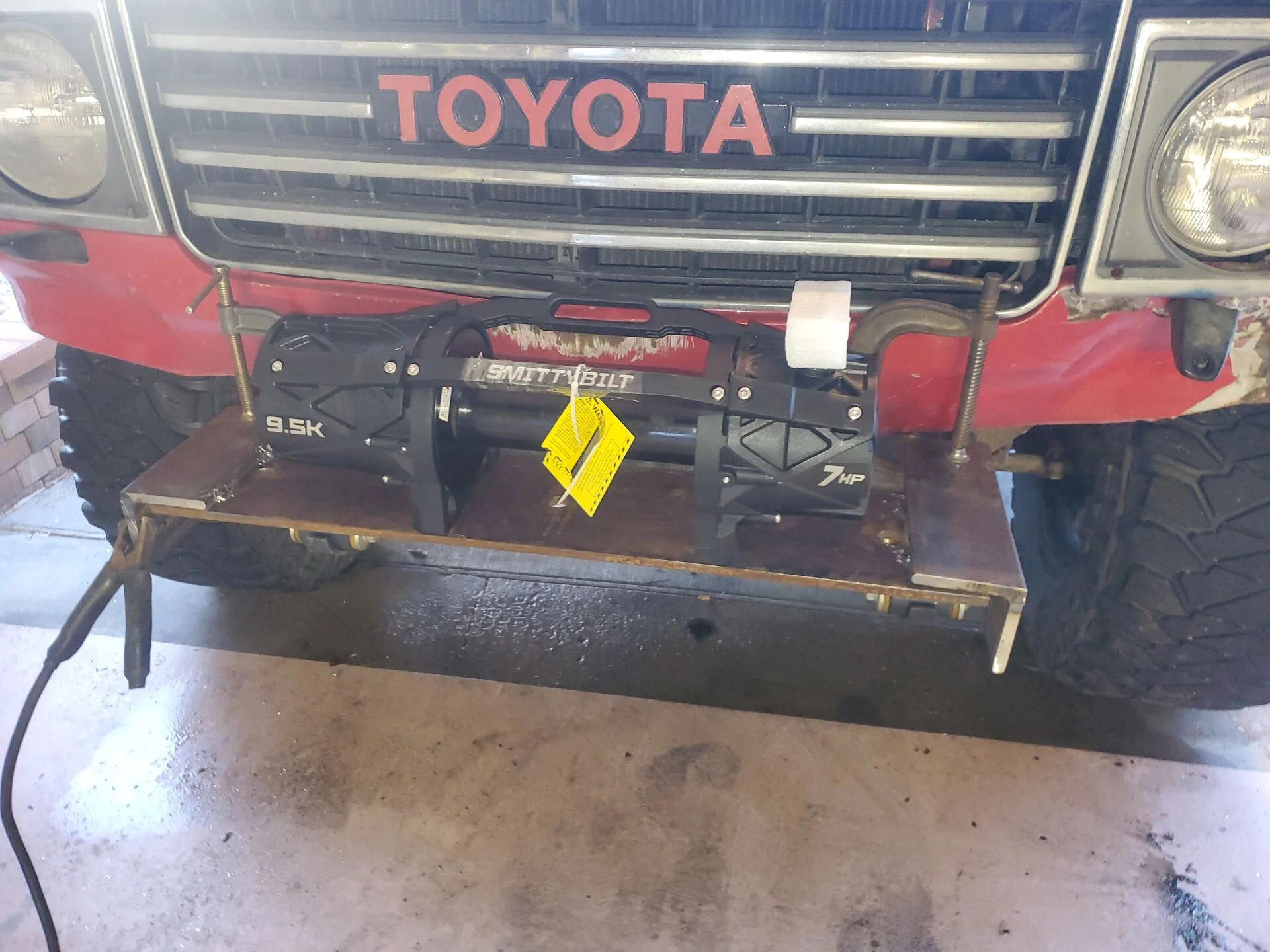

I had the same thoughts about the price of front bumpers. After some math I realized it'd be cheaper to buy a welder and chop saw than a fancy catalog bumper. I also like this route cause I can customize it however I want and I can always say "I built that". I think I have 2 weekends into mine, it's not quite done but I'm liking the way it's coming out. The whole bumper is 1/4" plate and there's 2-3 weld passes on almost every joint.

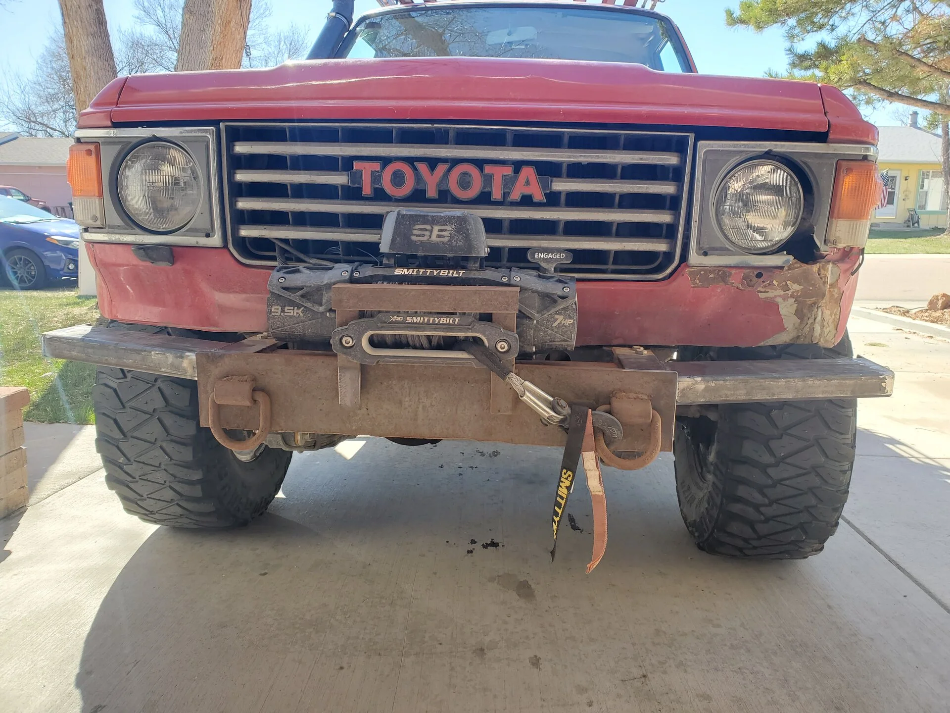

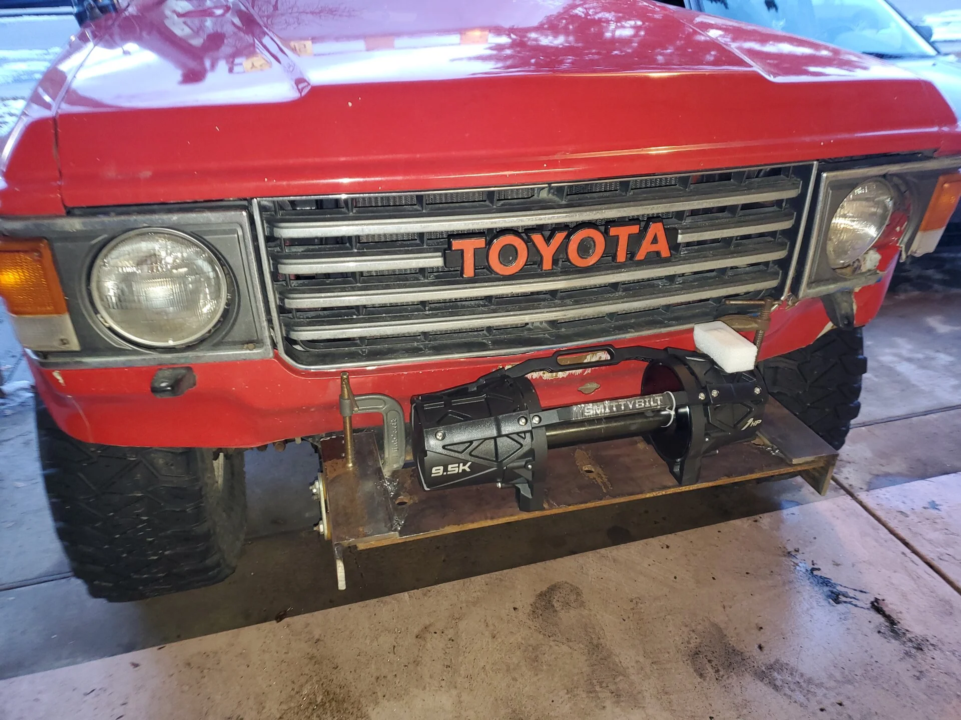

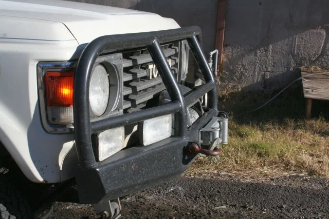

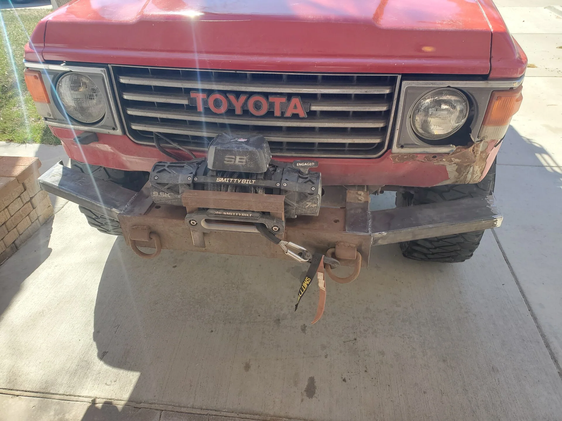

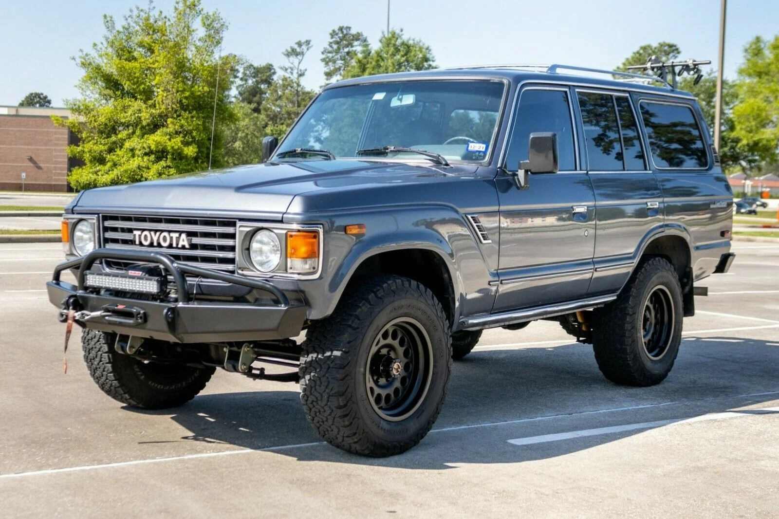

I’ve also made my own 2X attempting to copy @2mbb ’s design. Both using 1/4” plate & 1.75 round tubing. I cut the metal with a grinder/cutting wheel and had a muffler shop bend the tube. The first bumper accommodated a Warn 8k winch but would not accommodate a ComeUp 10k winch, so I made another which sticks out a little further (shown here). Probably spent about $150 in materials

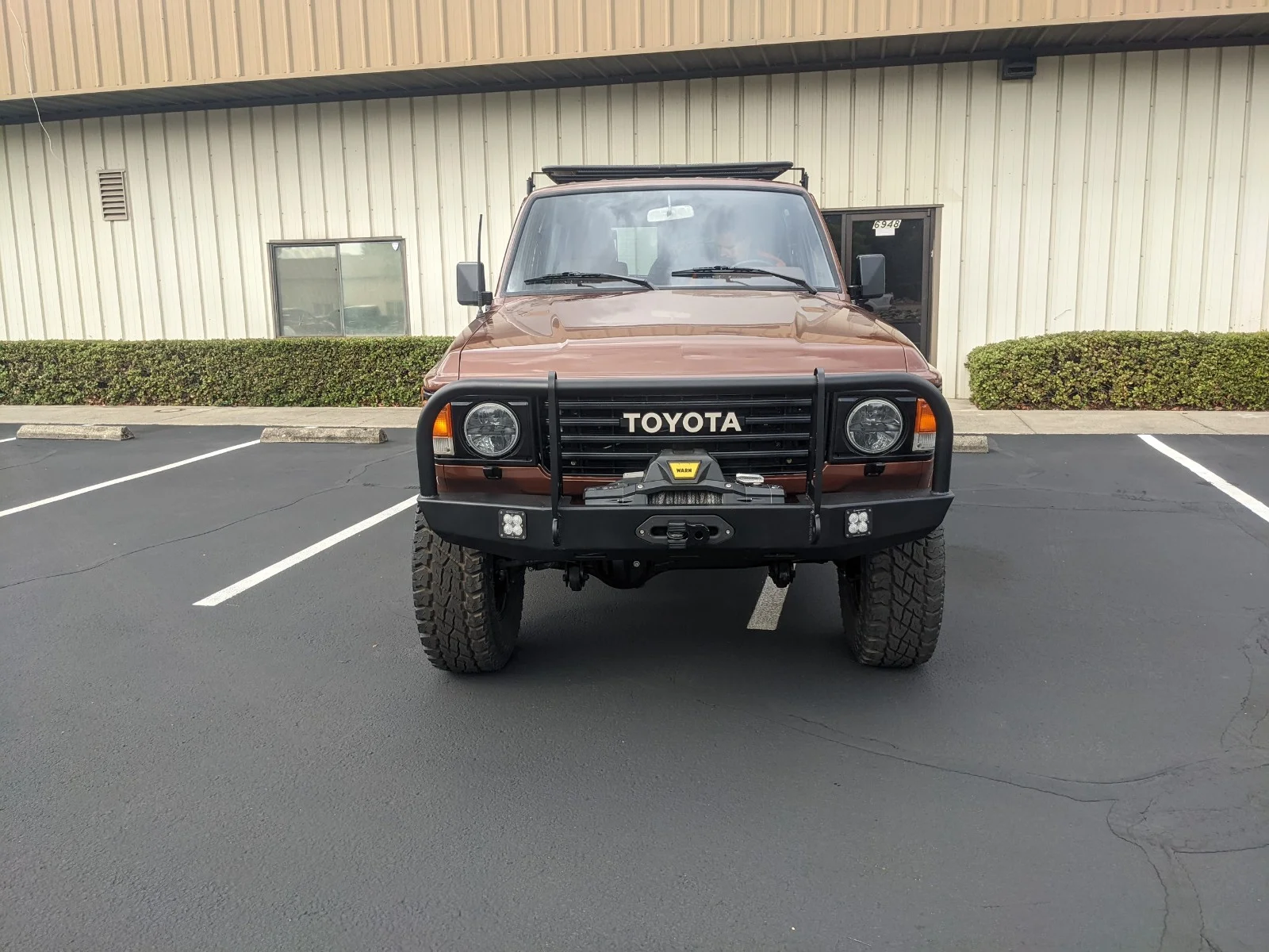

I have no regrets with the rear Trail Taylor iron bumper with dual swing-outs. It's steel and it's served me well on the trail and camping. It gives gives me piece of mind.
I am not as impressed with the ARB. It has merits, looks okay, but I doubt it would survive a recovery from the places I might need a recovery from. I like that it has a tool shelf and it fits nice. It looks like it would fold nice in a mild collision with a 'roo.

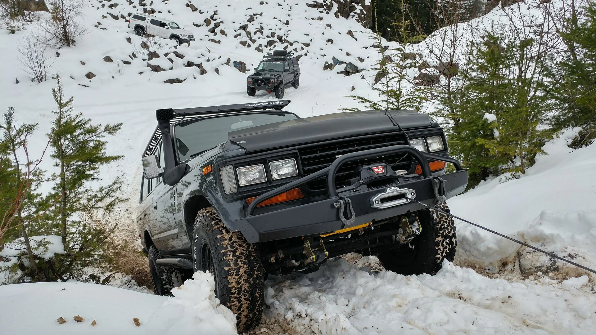

A friend destroyed his with a 12K Warn on an off-flat pull. He was nose down pulling up and forward when the bumper bent at the mounts and the
upper tube pushed the front of his hood in.

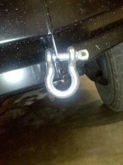

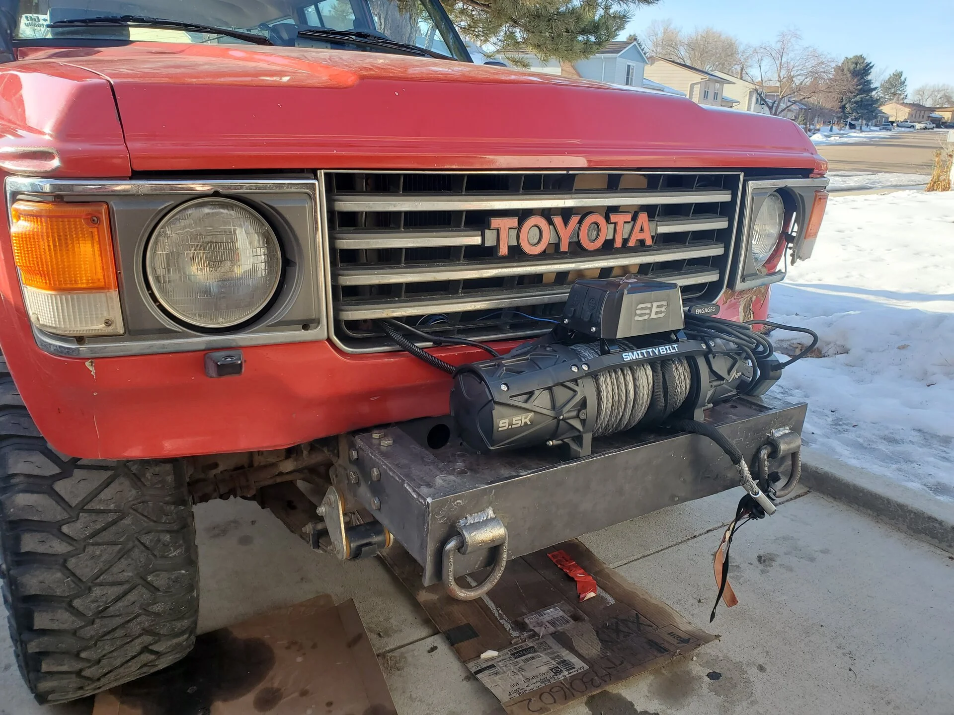

You forgot to mention the D-ring mounts. That said , they are a better bumper than stock and the design fault lies partly with the Aussie regulations.
Kaymar's owner said they cannot drill or enlarge holes in a frame by law. they have to attach to the factory mounts which weren't designed to winch from.
When Toyota puts a PTO winch on a 60, you'll notice that it's not simply bolted to the holes in the two factory bumper mounts. There's a second rear support
to handle the load

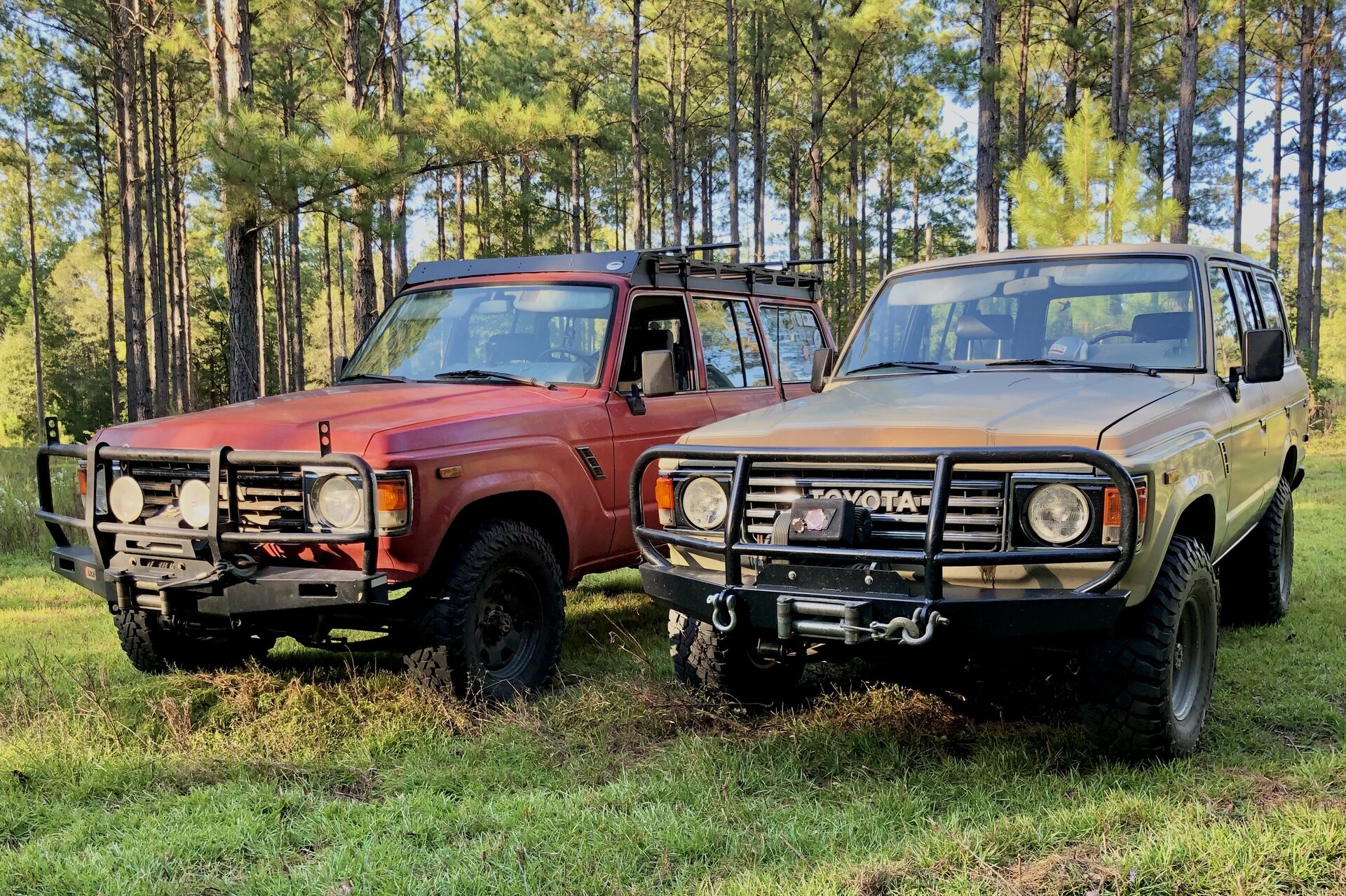

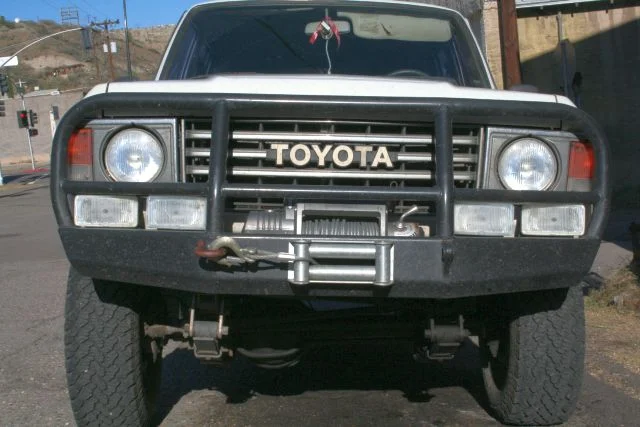

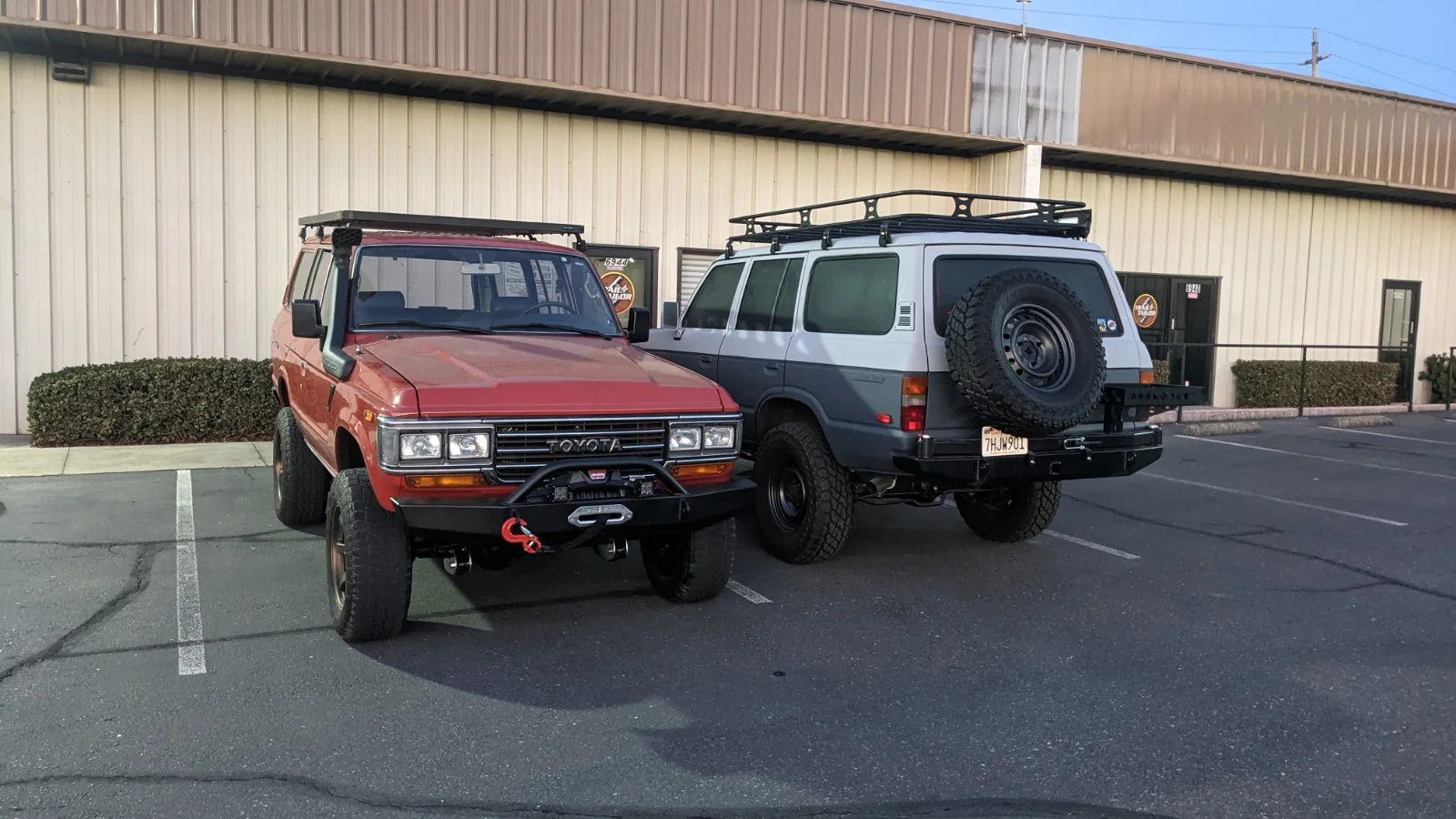

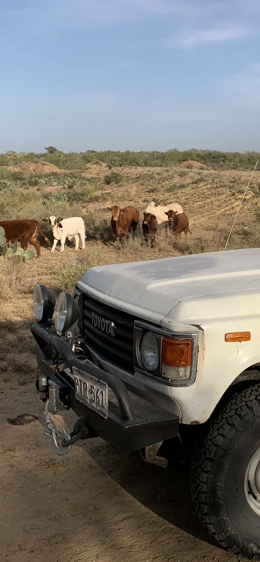

My 60 has a 4Plus Kingdom bullbar from @lcwizard, love it and wouldn’t have it any other way. View attachment 3343401

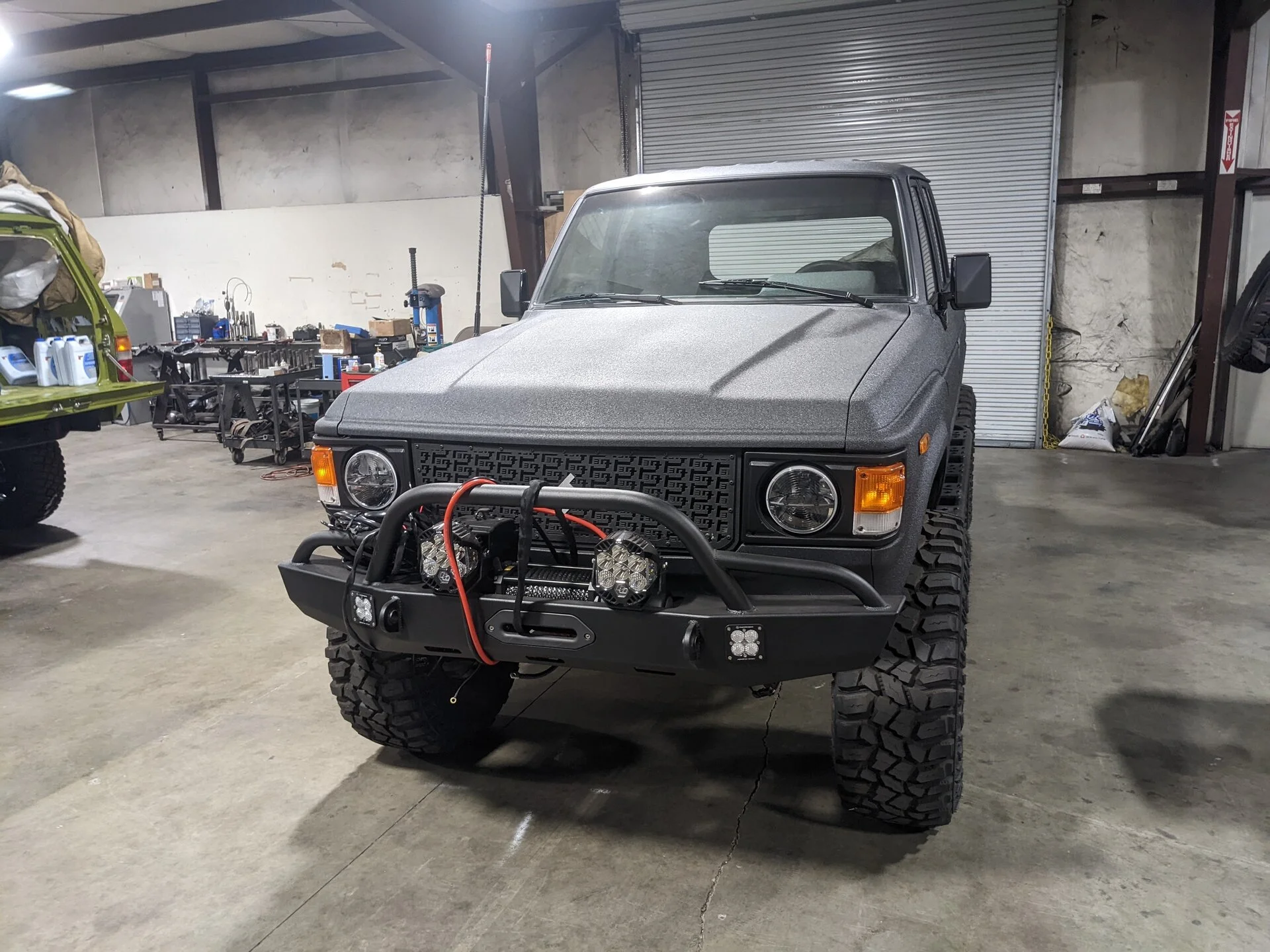

It's funny how certain shapes are intuitive. I built the first "Kingdom" bumper in 1990 before I knew ARB existed yet someone in Australia was busy building a very similar
look. The white 60 with that bumper was built in 92. I've made only a couple small changes like tucking the bottom of the lower tube in a little more and a slightly different taper to the wings
