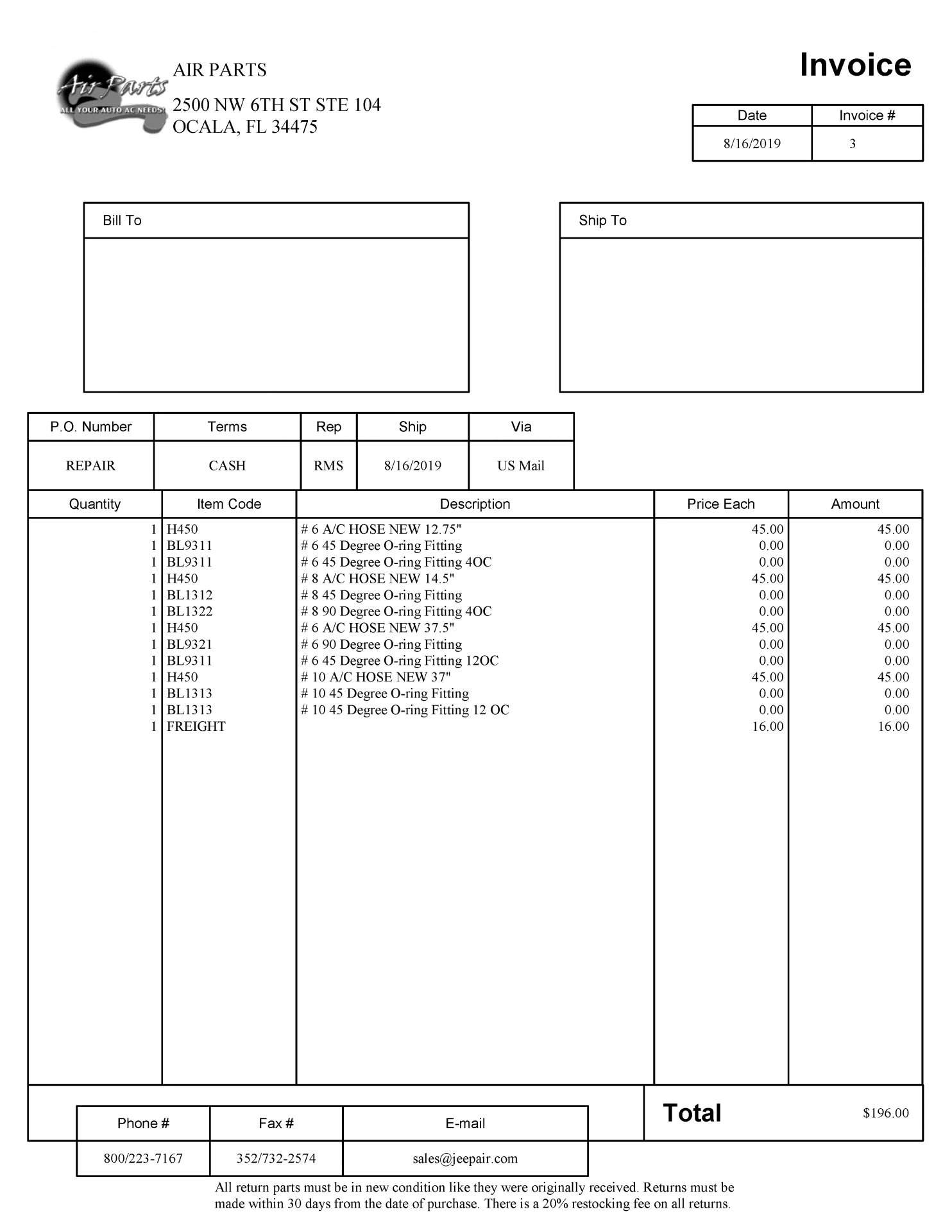

Had my hoses rebuilt by Cold Hose/Air Auto parts in Florida. Excellent workmanship. Cold Hose - AC HOSE REPAIR
Total cost for 4 hoses and shipping was only $196.

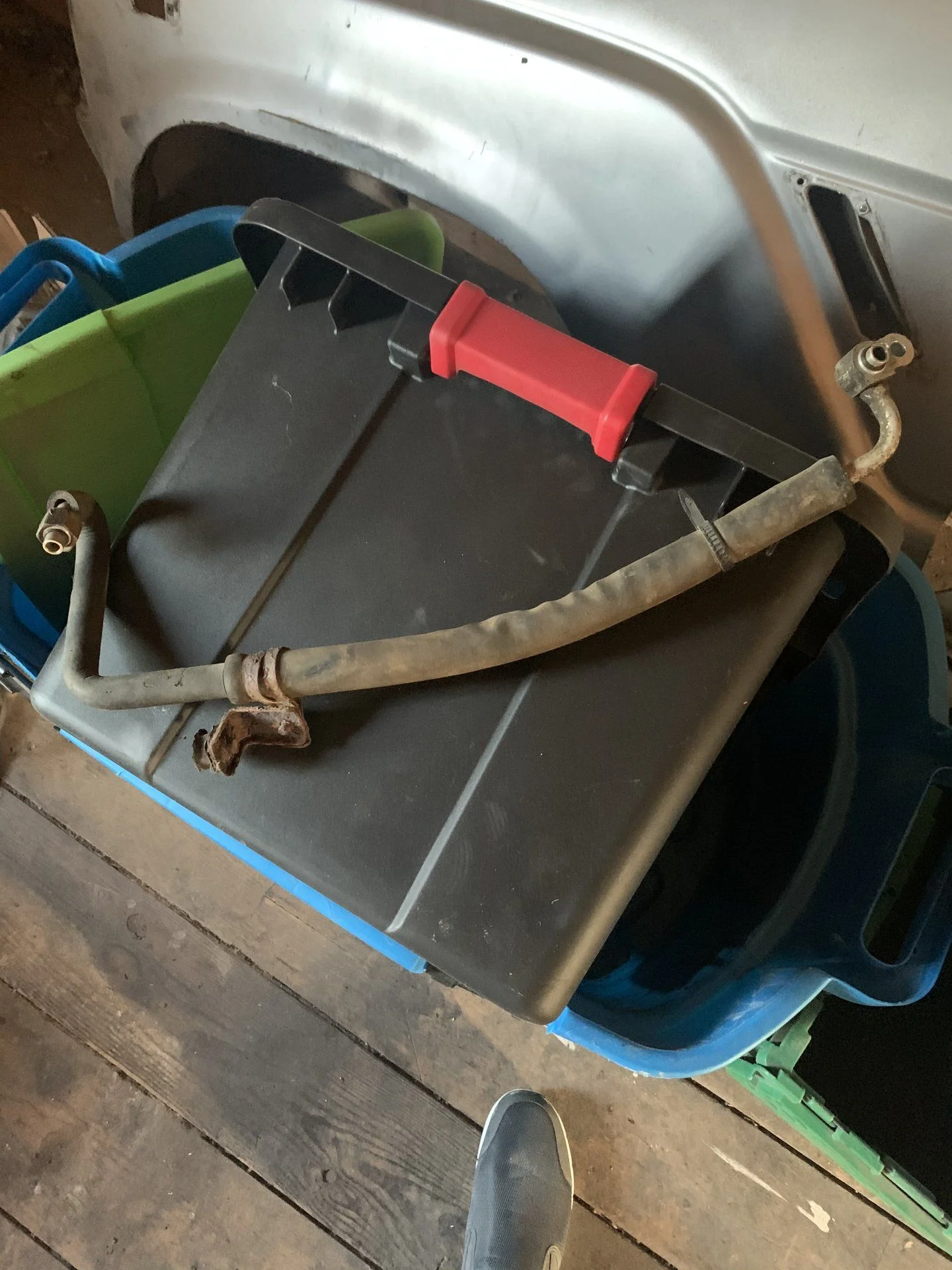

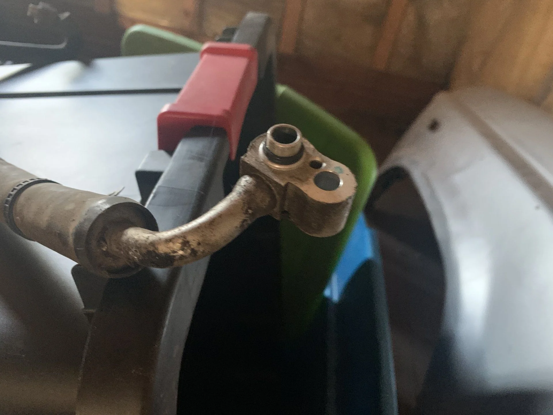

@Shes Mad everything looks the same except for the last pic, I have a flared end there.. any idea if that's compatible?
Assuming the problem is with the rubber portion of the hose, I can have them rebuilt, roughly $60 each + shipping.

Sorry to resurrect an old thread but does anyone know the thread pattern and diameter of the hose that goes from the ac filter to the condenser? I had some made by Ramshu in Reno but they don't fit...
