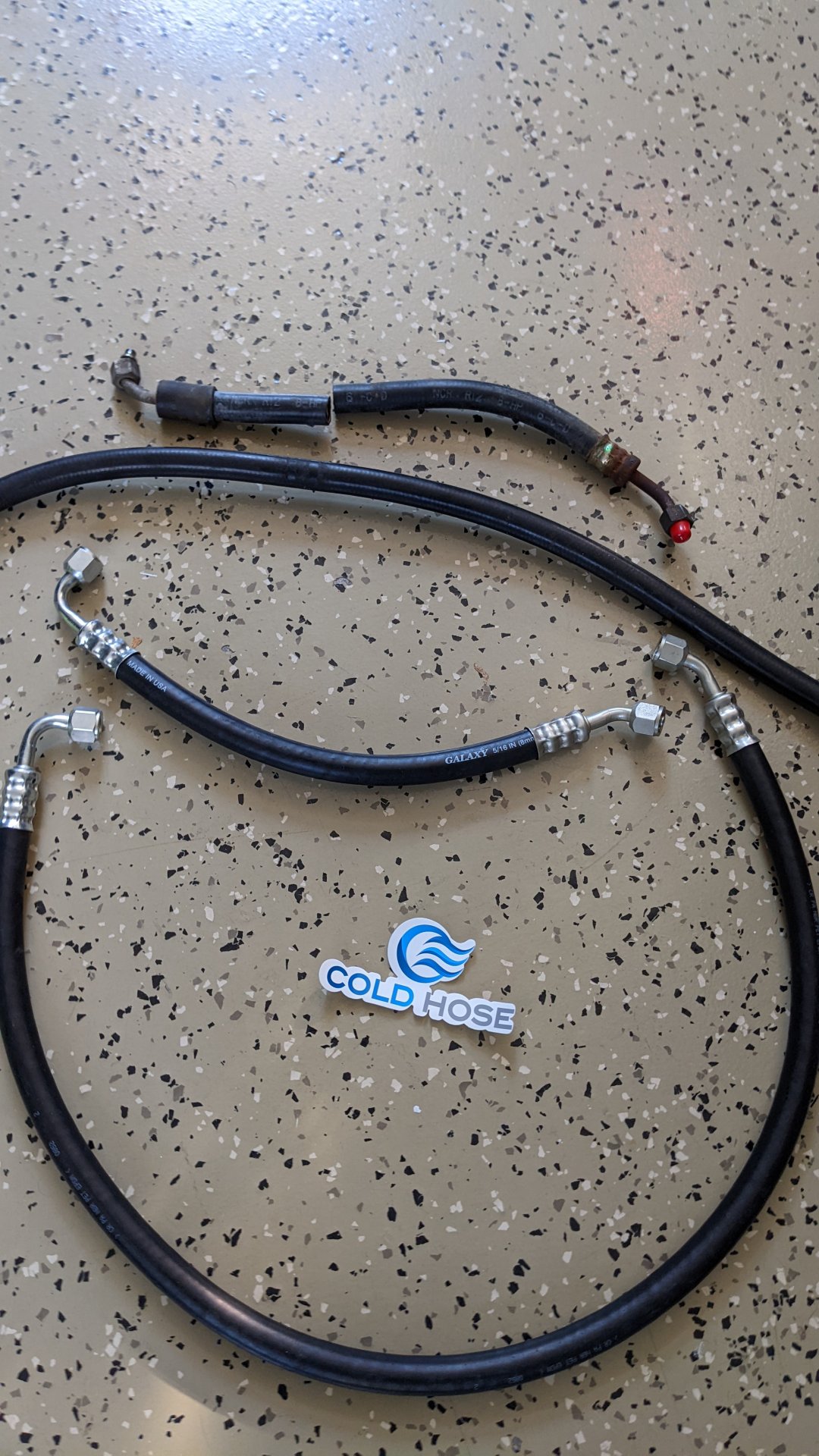

Well, I am half way. Got 2 of the 4 made locally, but they cannot make the smaller diameter 2 hoses. Any suggestions or recommendations? THANKS
For anyone currently looking.....I had the other two made at Cold Hose website. I had to do the measuring and find the fitting part numbers on their site, but it was really easy to make a custom hose. Great experience and less than 1 week turn around with the holiday weekend. They were also cheaper than the local place.

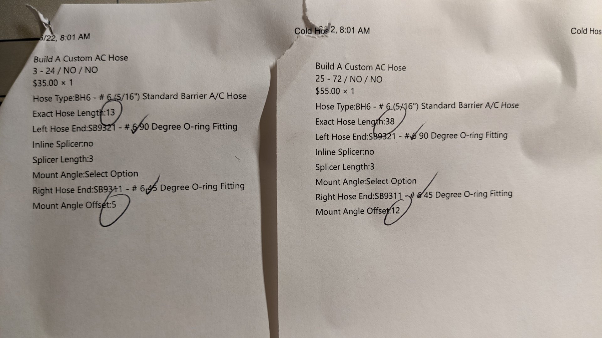

@Aloha Jen Certainly......This is for the two smaller diameter hoses. The others I haven't looked up. SB9321 is the #6 90 degree O-ring fitting. SB9311 is the #6 45 degree fitting. Better yet, I will post the build info sheet.
Just make sure if you use these numbers you have a 1985 and older 60. They changed the condenser connection pipe angle on 85 and later.......don't ask how I know.

Amazing timing @4runner2FJ60, I'm in the middle of getting some hoses made up and was just trying to figure out if the #6 is a 9/16-18 or M14-1.5 from the expansion to dryer and dryer to condenser. From the looks of it that SB9321 is a 9/16"-18, but somewhat confusingly in the ATCO catalog it's in the Metric section?!? I'm so confused about these fitting sizes..
Anyway, looking forward to getting these hoses done..
@repentsinner Hey, It is very confusing. I think the Cold Hose site helped make it easier. At the top left of their main page, you can select "Custom Hose Builder" The process has good instructions. This is where I started, and then found the fittings. The two small fitting hoses I just got, part numbers listed, are metric. The hose itself is 5/16" hose. I cut my old one to confirm. They are calling it a #6. These fittings are M14 X 1.5.
@Aloha Jen I'll see what I can come up with on the two larger diameter hoses.
I've been digging around. I thought I had a new hose that was wrong? The hose from the compressor to the condenser OEM is 12.5 mm or 1/2" ID. My new one is 5/16. Looking on Cold Hose I found they do not have fittings for this hose in M18 size for 1/2" #10 hose. So the local place must have been the same. I just built the two hoses I already had made, on the cold hose website. Hope this helps someone. I would double check my build.
The LONG hose from firewall to compressor has M22 X 1.5 fittings they are calling a #10 the 45 degree fitting is BL9316
The short Condenser to compressor has M18 X 1.5 fittings and they call for a #6 hose. Te 45 degree is SB9313
The 90 degree is SB9323
I don't know if that short hose being smaller in diameter creates any issues performance wise? Maybe an AC guru can chime in?
