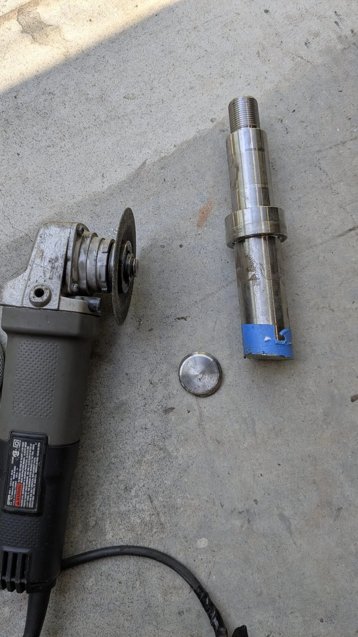

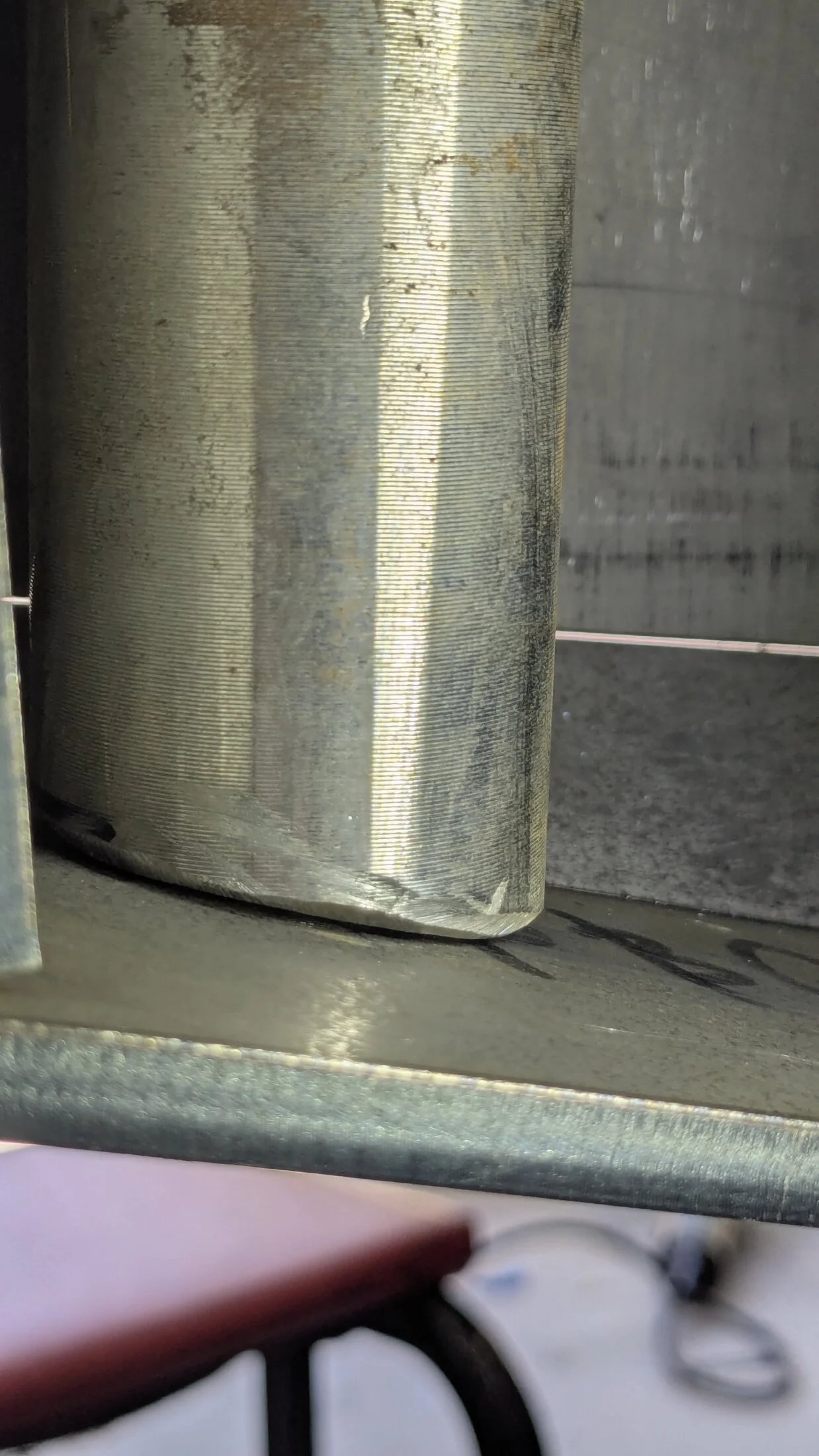

Modifying spindle to fit photos:
I did this with a digital caliper (measured down at 4 points and transferred to spindle), angle grinder with cut-off and flap disks and a bucket of water to cool the dang things off. Oh, and tape to try and give me a guide line. Would have been lots easier with a metal bandsaw where you can clamp everything down, but I'm not that well equipped. Left the recommended 1/8" (or 3mm) gap for clearance.
Worth nothing this was a complex bevel, meaning that there are 2 angles, the main slope you can see in the last photo and a smaller secondary exactly opposite to clear the next piece out.

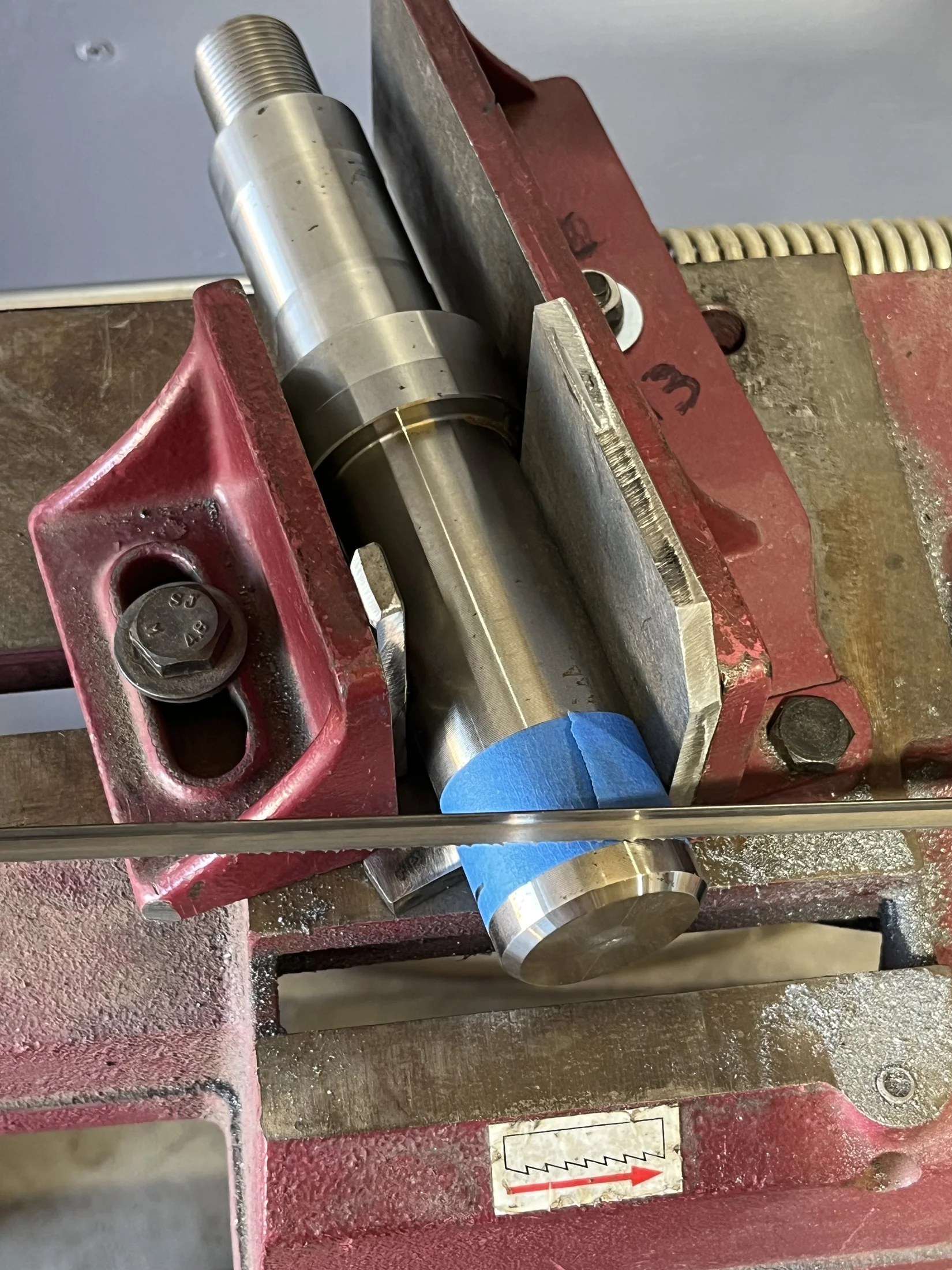

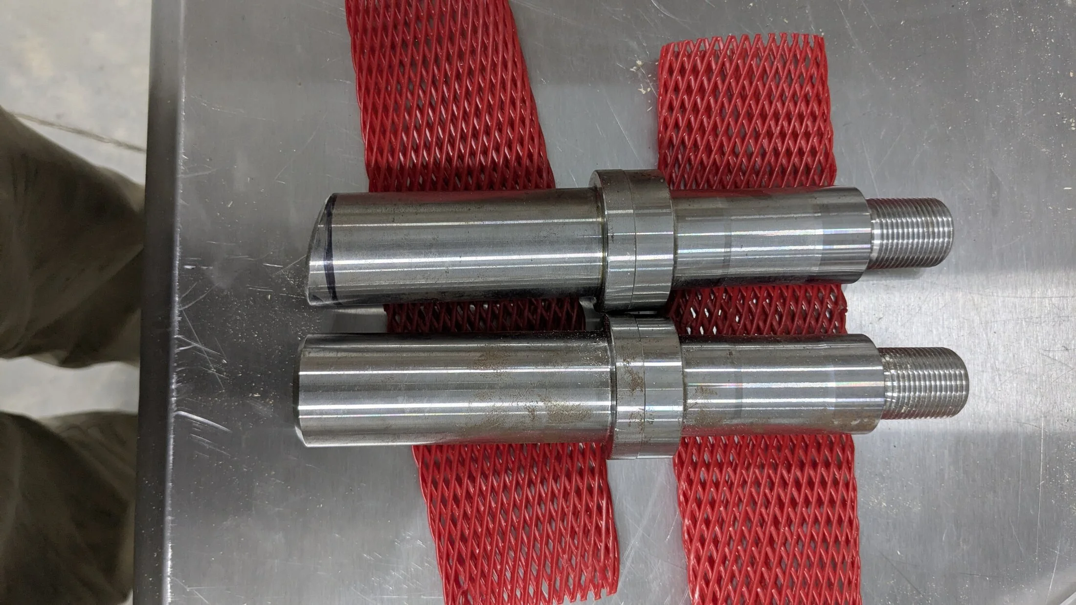

Nice write up. I just did this yesterday on my bandsaw - the main bevel is 12 degrees. I went a little more caveman than you, just marked the shortest point to trim (9/16”) which is visible on the left side of the blue tape. After that, i only needed a little trim on one edge for the secondary angle.
I didn’t recall seeing anything about a 1/8” gap above the top plate - which I didn’t do. Hopefully that’s not an issue. {edit: it wasn't}

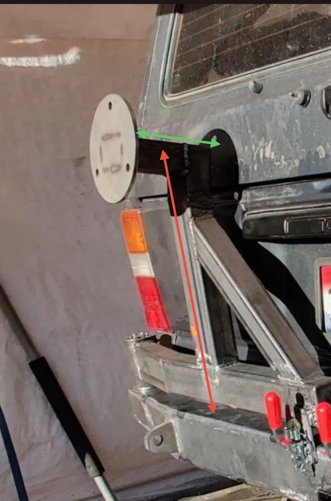

Just finished installing mine today. There were 2 changes I made that I felt were important enough to note here for others. Basically, putting in positive stops on both sides of the swing, for the swingarm. On the "closed" side, I used 2" angle with a piece of rubber (old inner tube) to provide a little cushion (3m vhb tape):
Oh, that also shows the UHM plastic for the end of the arms to rest on if they should sag (unloaded/no weight they float over it just barely), and my latch to keep closed which goes through the top steel of the bumper. And another angle of that:
And then I realized that the swingarms will hit the corners of the body if you parked on a slope and let the swingarm go. So I welded a piece of 3/4 angle. This works by itself on the fuel can side (was going to slip a piece of heater hose over it for cushion), but my cooler shelf is wider so I'm going to use a little of the extra UHM plastic facing towards the swingarm to space it away from hitting the rear fenders.
Past that, I'm happy enough. Only complaints are my inexperience with welding/fabricating/painting (basically, making it look nicer)... oh, and the slight twist in my 60 frame that made for things to not line up nicely.
