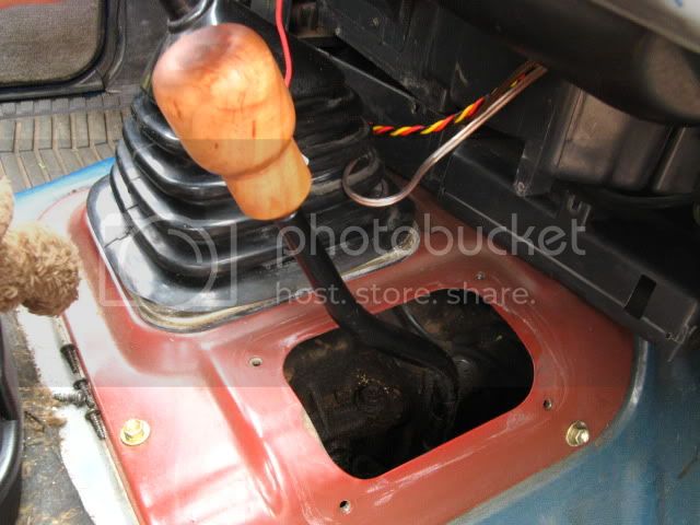

I need to do this...already have skids off. Has anyone made a custom shift knob that shows the new 2LO position?
Not a bad idea. The pattern would be a square, pretty cool.
