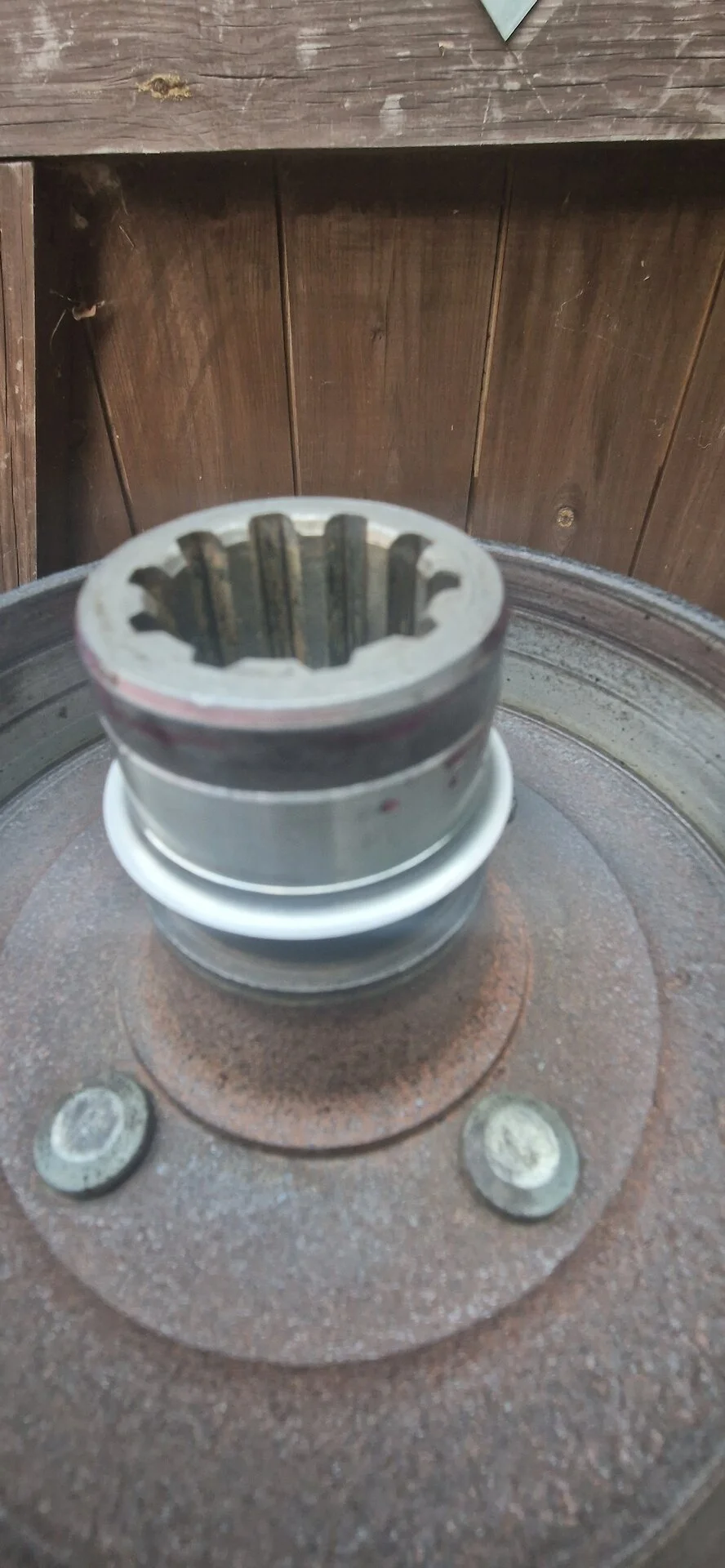

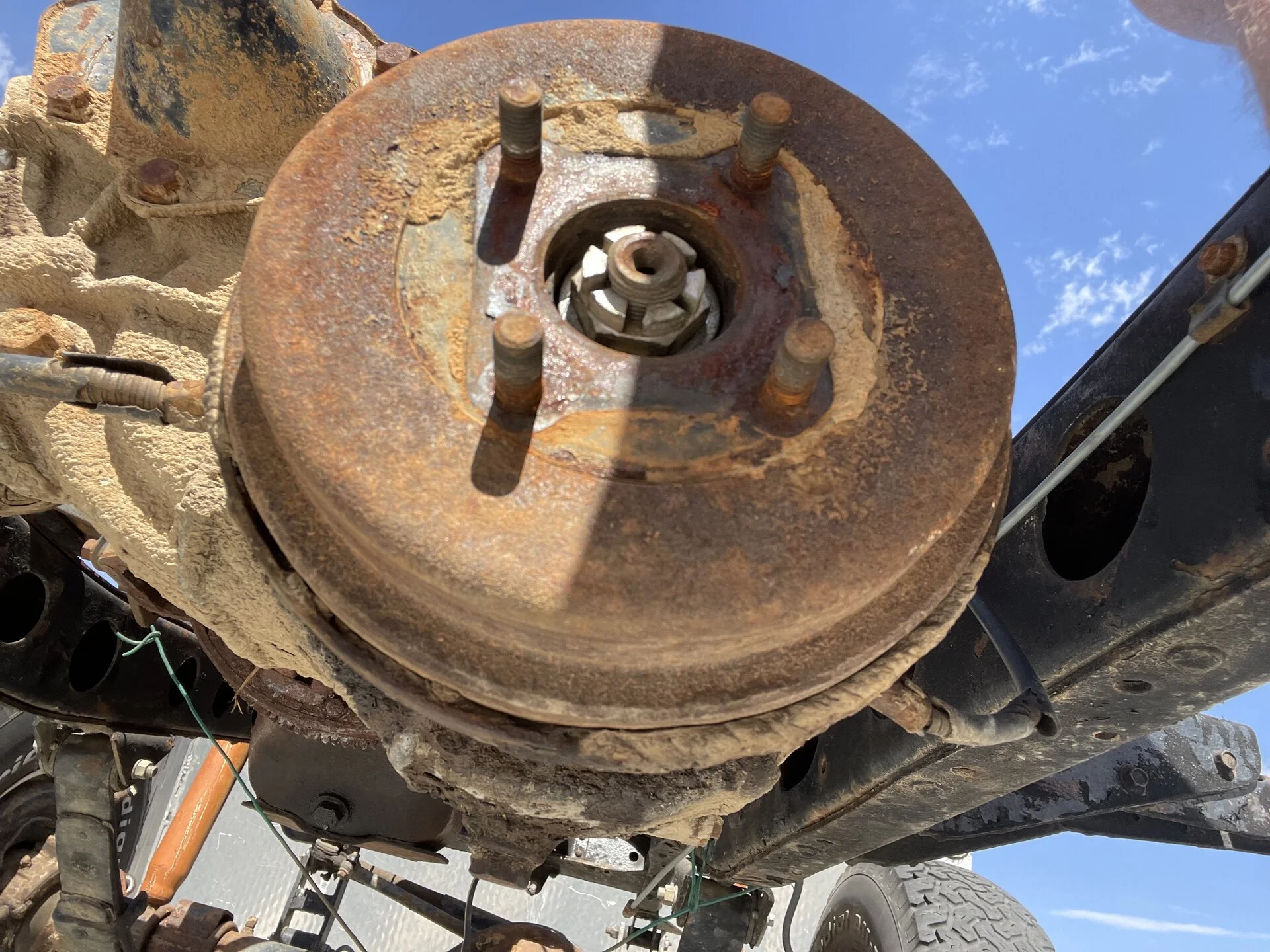

In order to use the stock emergency brake on my upgraded 55, is it possible to use the three speed brake assy on a newer FJ40 4spd?
fj55 pict
note the brake cable is on the passenger side vs a newer 4spd has the cable on driver side pointing in opposite direction.
Do the spline counts match? If so, then yes

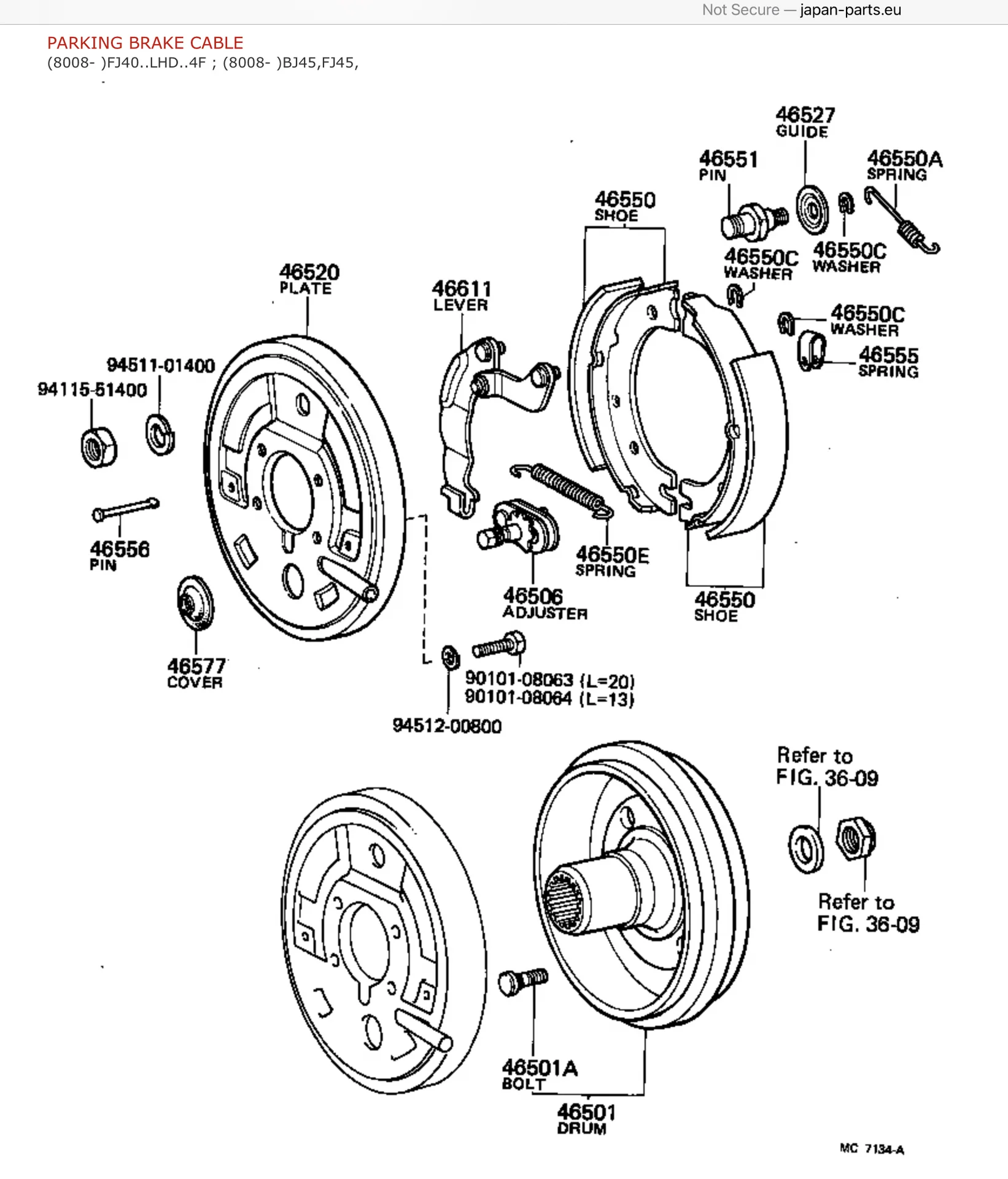

My 1977 RHD handbrake cable enters from the right (drivers side) the same as in your picture, so my guess would be that they only added a dedicated LHD back plate in later models? (Suggesting that they're otherwise identical).

IIRC, all 55 series parking brake cables came in on the right-hand side. In the US anyway. Opposite of the 40 series.

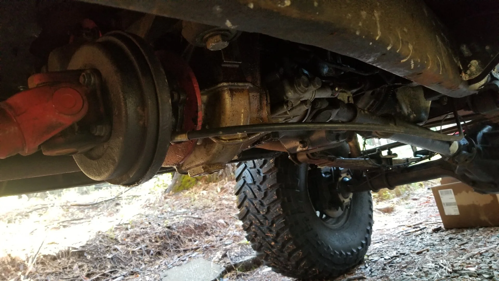

Here's my '74 FJ55 parking brake

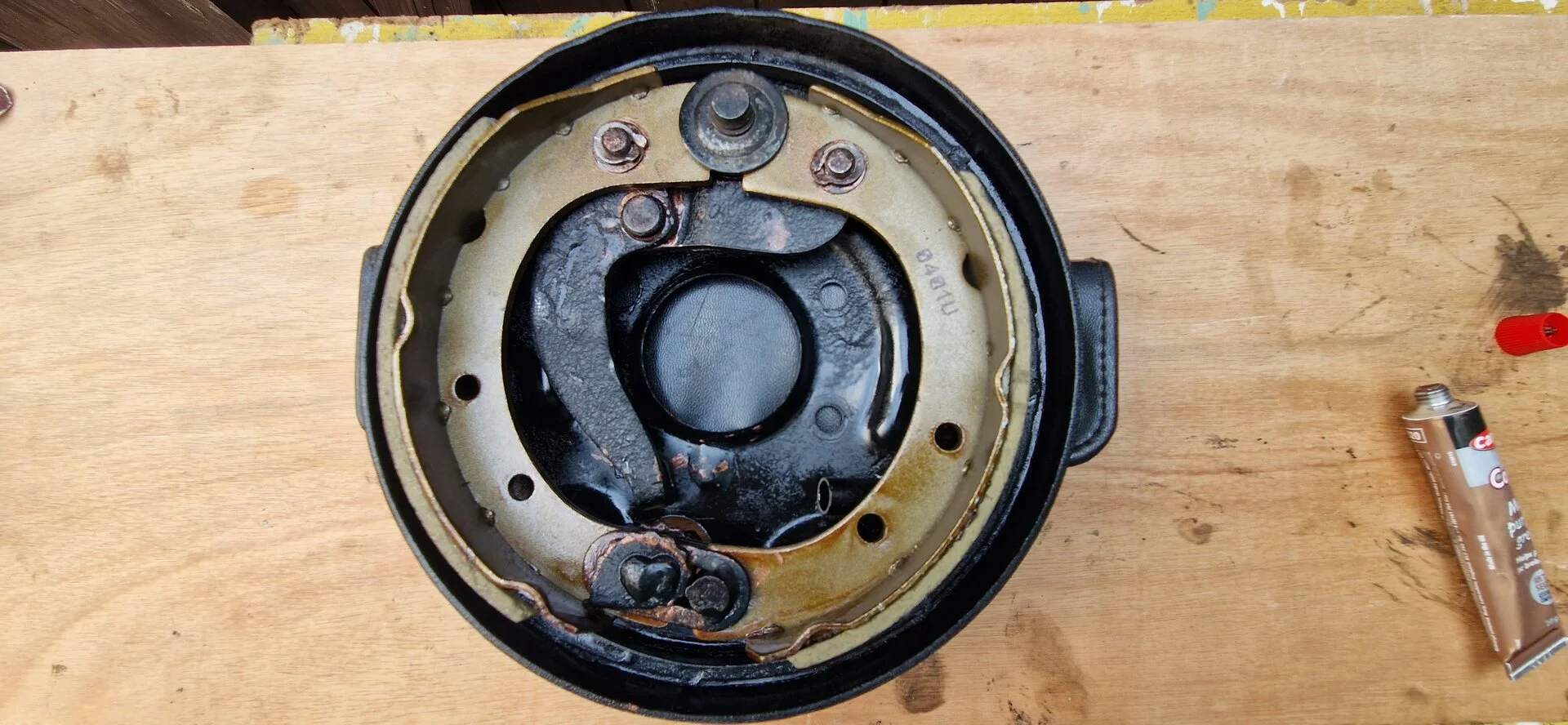

What about the backing plate that has the actual brake parts? Do they have the same bolt pattern that hold them to the case?
As far as I know the backing plate is all the same.
I got a parking brake backing plate from both a 40 and a 55 and sure enough they are transferable in regards to the bolt pattern to the tranny. As far as the brake components, the lever that attaches to the brake cable does need to be swapped. Other than that the brake system parts are compatible across the two different models. In all my excitement to reassemble, I neglected to get comparison photos of the different parts. :(
