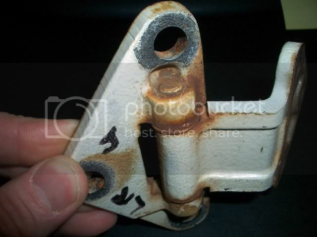

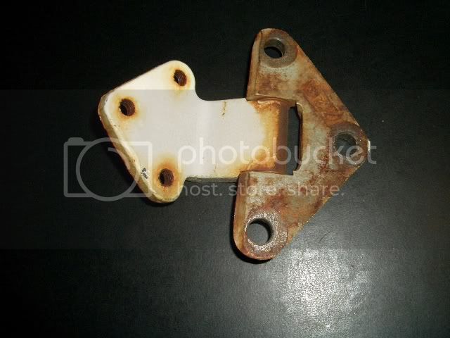

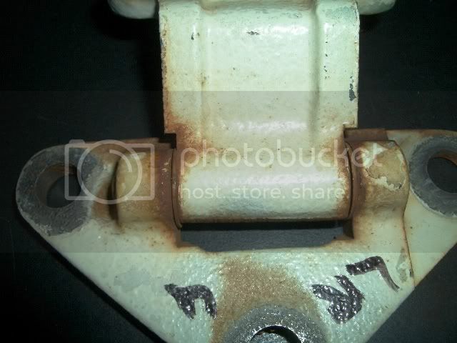

I have some questions first and I know very little about 55's. The hinge I received does not have the spring on it. If I use it to copy the bushings, will it suffice for both upper and lower hinges? I've seen hinges with springs on them and I don't know what the difference is. I guess I need to be schooled on 55 hinges. Who can do that?
Here's what I have...
That is an upper hinge.
The lower hinges have springs.
I believe the bushings would be the same, but I am not certain of this...
