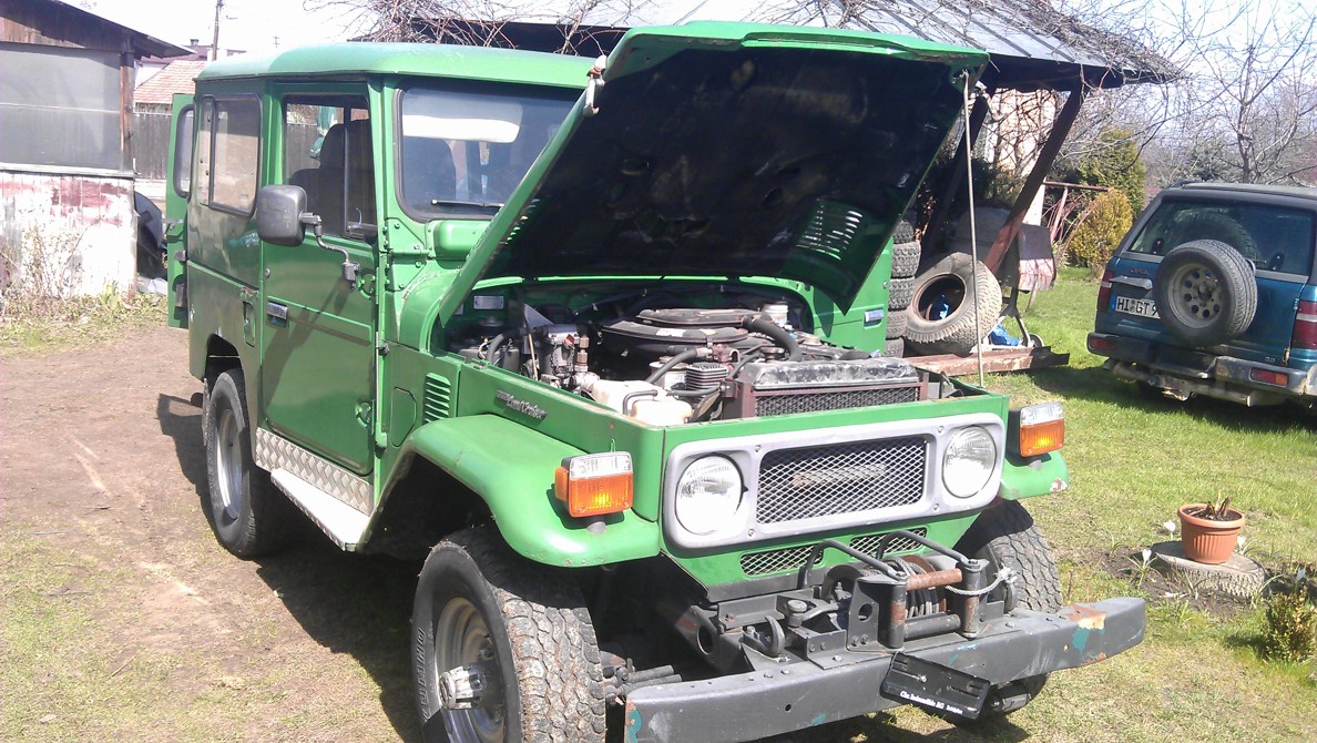

It started in 2012 when i bought green fj40.
Some data:
1981 with 2f engin
pover stearing with air compresor for break instalation
original winch
My demand was to rebuild it as a softtop version.
after 2 year i obtain:
- custom softtop made by me
- V8 1 uz-fe 1991 from Lexus
- r151 gear box
- 2 toyota oryginal diff lock
- oryginal winch

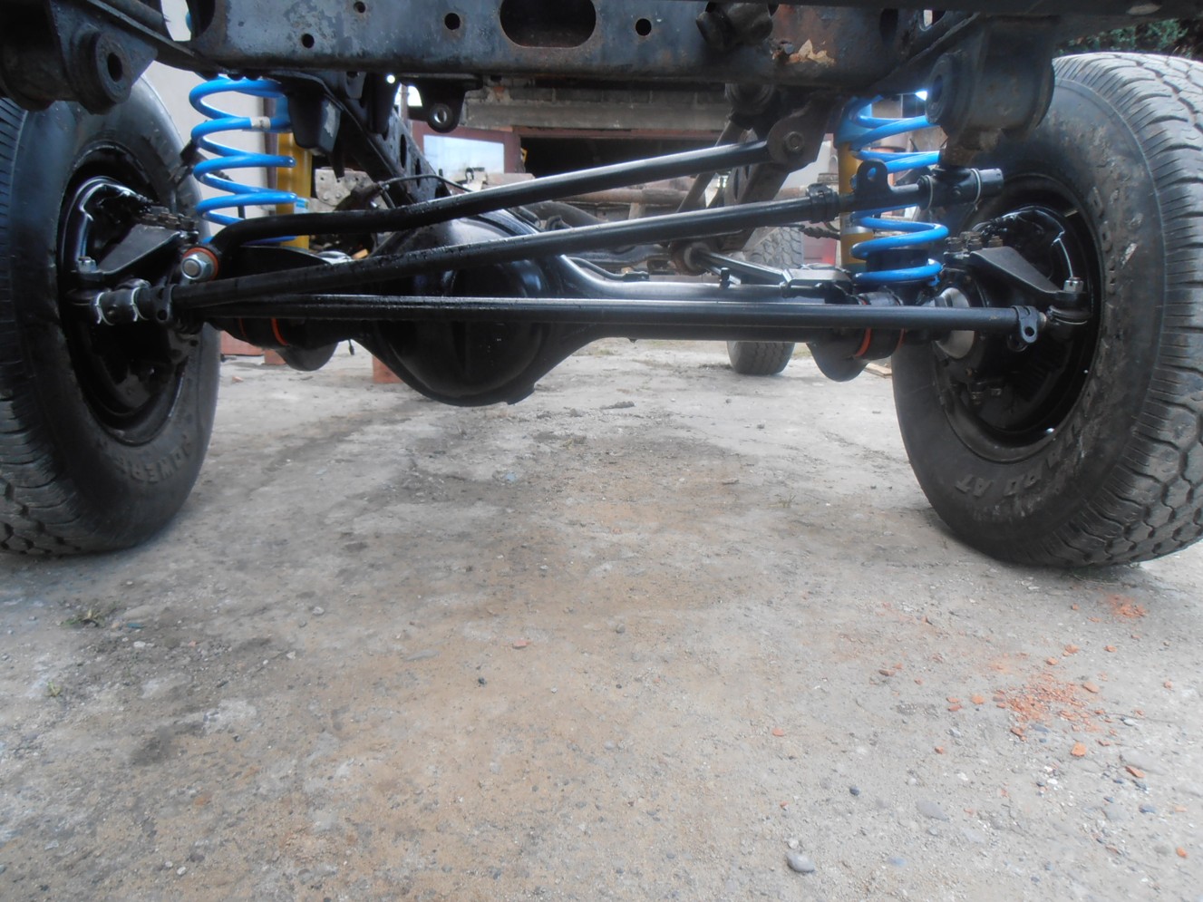

- front and rear springs
- fron and rear disck breaks

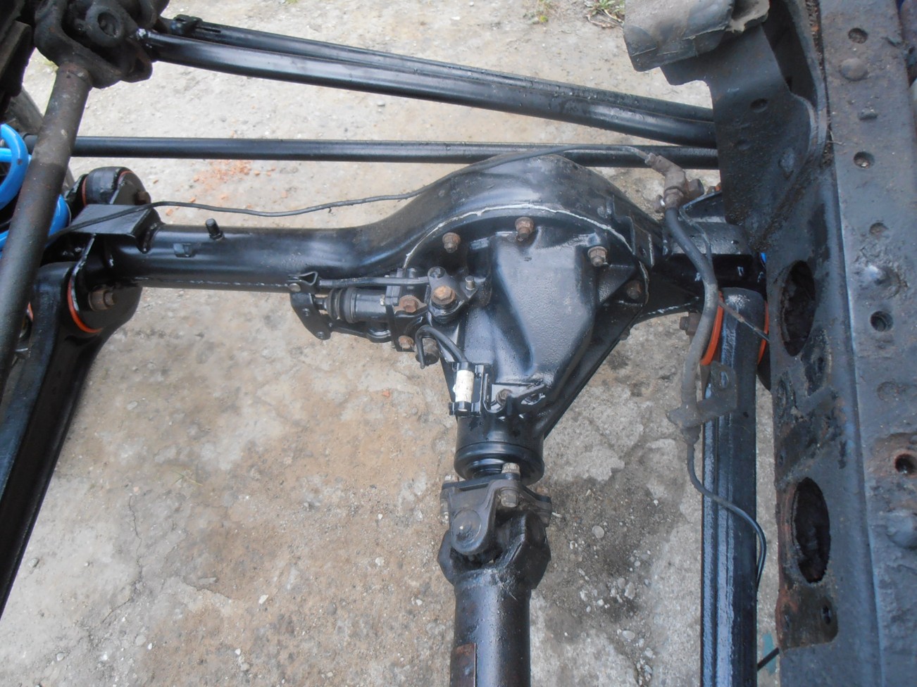

rear
esgpFzi9nprUXjuBXPs1C0WOCbZx0i6X9HrzOgEcl8hFcF-T9B3JlGXe5gVsqfwAtvLc-5oCeaFC2MX-gohGH_Vh_-cBRx_0hRa1JCnTkoxCd2WDLc6Zace3StALL9WzTkX_W6-AfqHWxFy_70yWAY47yLcRTn5_psdouxemOWk5zgutd1AOsO3Az6gARQ_Fh0sBjryHb5oF0hIqscOH_kCiHXTke3Loz82E7gtj_yd7GN2iSNQqYe6hPmd_vdMaoNJrlj4n23ZVWXT-3G3YVXmDfq1KCxsDafmUpvWOSIstEGrJDJi6ZHXpkplhEN6TMxk-kbZiMa-Ol6nFFgG1WCed8Z7vKWPEHdsWRj3Qu1dn9yzpB0xb-HI9bkNrBgSuh4dboJafxpRDUqRS4pL6Jw_K-P6zqq66OhDtF8GWCyWZTg-3-_YLUHkn7WfnNj0WrhDwOcvOjeY8uSwlmPtnjfNv5hr8kUjX3hgn1bKxxfpTjSvsoacnQ4Bic4P4ILVHIksxLxcc-ov1sFXEdnzhZ58xXTKaTp9lOXx1Ue3nfLI=w1034-h775-no

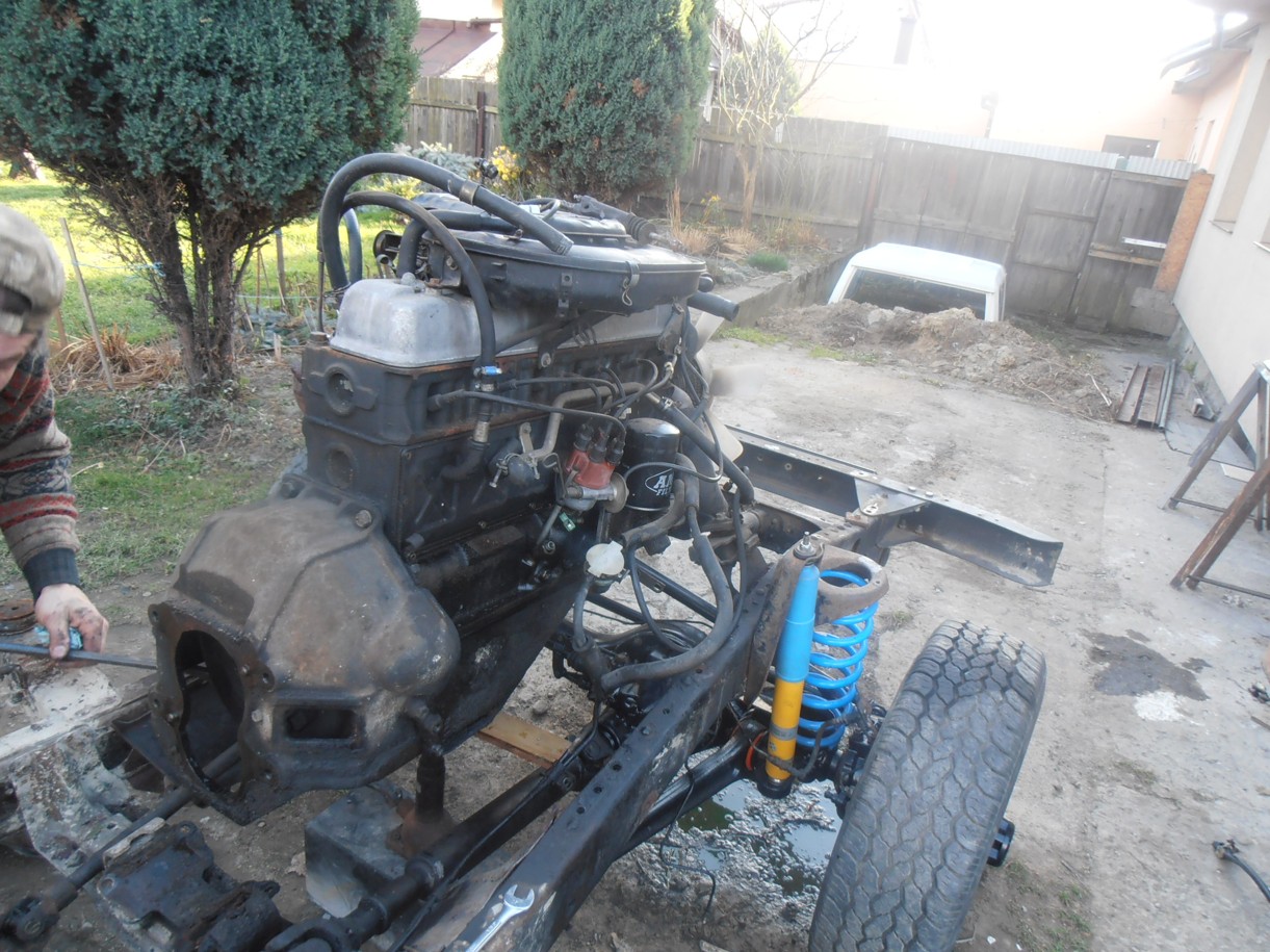

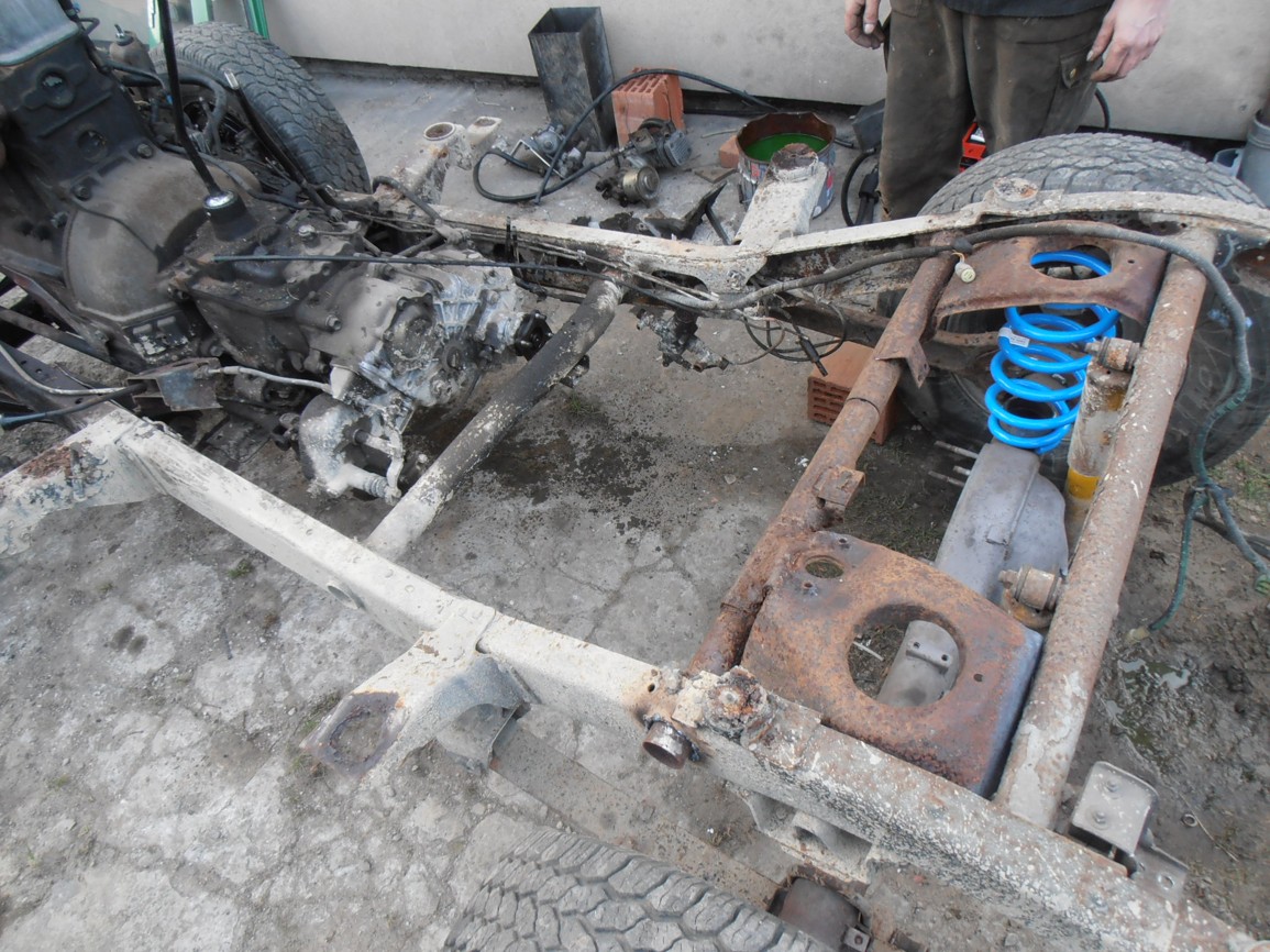

early stage of metal work:
gr7Sn0XHwqQz4N686QfgdHuPchdYQGhrgZ9AXdga3mQDPQiqzIv8rqTG0TlF_I33sKNUnzrqe5LzP9Y7uVqN92l1LY7L5QxBtlEejji-tQf5zwVwRPzep9lZYg_CyvNVp6YAglhvIqhw5ScsAANp9bjrqV-P_A5ZzMGfvKL8bH7Oc4or73d8QYzxS-BFc8dznTDOocuNOvZZkyaDyFUKaAqPDD14VG0pgkMJhLeN338xa-iPVLYU8PTOpWN3eqjb6OCo_oDBI6EHhzsNpkSGZDVpDdeNsmMnZAnoEp1JeHAFtiCub0NZjx_ScLKneSAPS8owtmlnXlGNBDIPIaE87AZRSoouZoO6awFP6hGc6LG_P_R4A66VY7KNJRtDSoEpe-v5MKjwGTkSDihP6KB6G8NBWiV0pADQqsBaH1uBfQUr3j-iAsopZR3EneO9b7j7wj4udfFAsniDYZwcSB-T6_7aMyMMHxO3eRazdgokhhEJYv0lktoXpkOl9s7zJA6RyP1onEXJXUry2OxP2r4GdMIERQVuHG2VXf3aOzCTsN0=w1163-h775-no

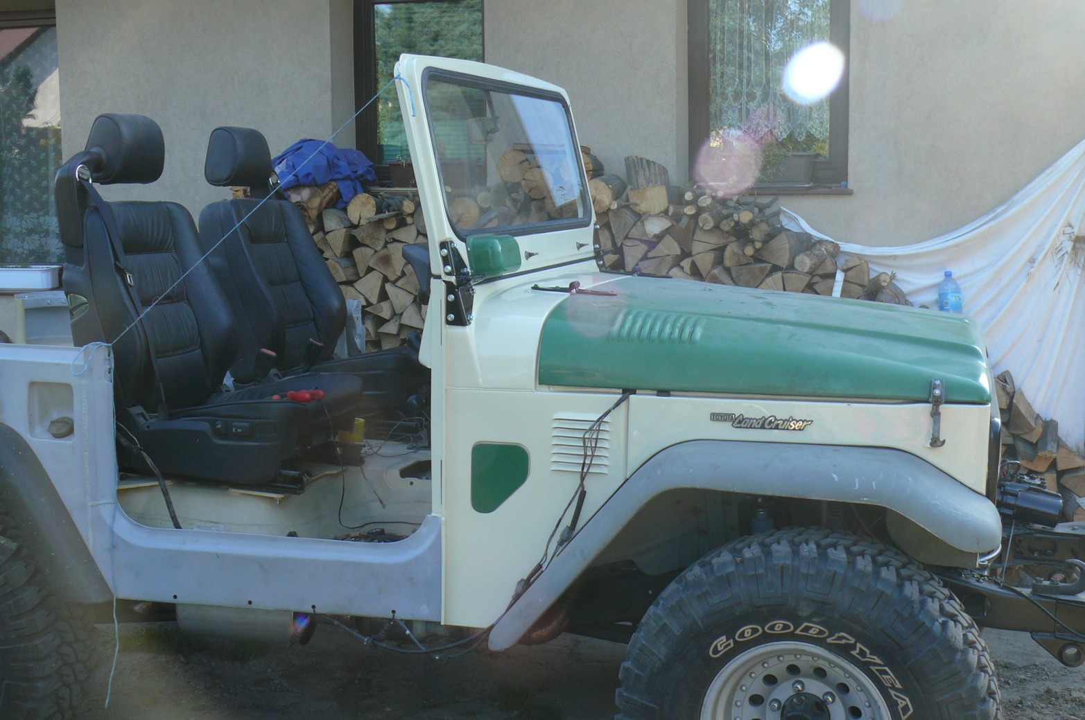

seats are from bmw 850 , they have integrated seat belts.

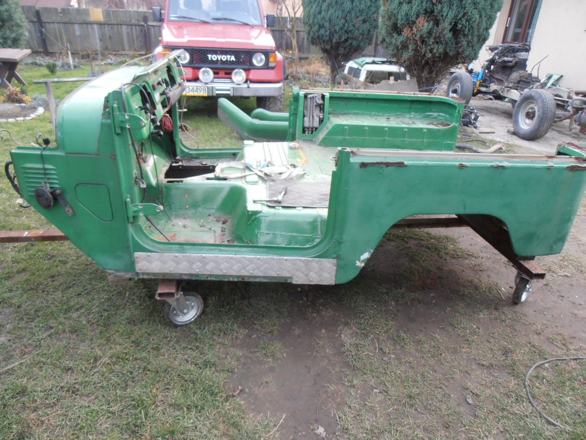

We cut the hard top to obtain the support for door.
The tubes are in line with the body so i do not need extra tubes for softtop

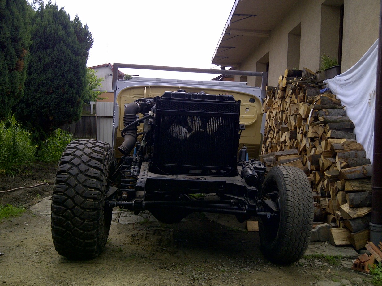

front
7n8nRUUCM-fwV3ya2IbyWXiaU0aCkNLZ0i57Sq2yl0mrgF92qP2f2fMIaYGema0km7m97Xj6Hvp59gzNedeB-oUp94p6du2XU8UG_1BiayK4HbkP7ZamSX-uQMC3YbxCXsnBPS_qVP6YNfqLYiwAWugJWFlKFA2bipguJQLRNS0EiuIYWAd4qxZYt_uC0ynMI3xputOUQ9EzK9cpWvpEERinXPWPMX45iU--I9m-zFffcq-qodUqGwNP6Bg45DUQprrePZk0XzlqmrqKmoQnm9XsdPV7TNJRYdzZltePWnohTEXaD3REfNGDdTp9-EXr1kDK-8iAGXFJvzso_i_cqsikeDGRT2HiKFleeev3Wx_DnFxUGYHO-lJOnuYhmKApTZU79YlyQMNfshSOM_xjwa2k6B7dvhPcowmkcREV7gNvSWEhdOW4rLaANZaSB6Wm24oJGGaFuAB1ObpX9NviEA-0wa9v3rrEyBWxAUpl6tSgP0DH5Gk_gSF16QDghKsg6TG47tHuzOfYmr0Ff7UHZfEE4cjvuu1etITwtIlLXEE=w1033-h775-no

here you can see front spring and element of pover stering
bmnA9wayCbYPm2Z7aO5JzZ7Cx7LVllYOg1blBYCqVBO4lFrUmFV_CvaSXcOO1JBZkSJBfpy1JNFrrNTaKAwcYqno7Mj5YcpojzQ1388BLoIzWLrthWB3-LANFhvOOOqkE5eC8M__cWGToWwoaYiNCD6AHvqGJO9BwnBQM16SK7I_lBUtTp_CVmDizCAiIu7OcCnk86q-RClLDVJv71g-oyZtFYSdAeVDQOK6jeF7IQIKSVt21AqFBu2coTY3eol-_FqZtt_UtXx0aourKNXfbLjq6HB6rzePirEMirnuzAh7Ugu0Niln6Wl6Gnk7sAviIN107_Qu_XpRkqihUiVytLQKhJheu_REsbm-Smfnw9k6croMKuVCNy3F1hIvrCoxtboB8NxW79Fk0T7B12dryMMlT4wpnw8os0fIjR_jlUnHbiRvl01-DRtISoZGxZDuAd6M3q8kW-KYkbKSxCl0CNj3uvwsm9wYs9vpp9NaCs6O_c-1rq_VeY0CBH8s996Ke_qeXxu7HpIuV8chfBOIc3tyuHgG8cAN_vbT8wMCdHU=w1168-h775-no
